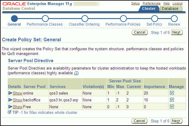

  4. Log in to the Oracle Database QoS Management Server using the QoS Management administrator password (default is qosadmin/oracle112).
  5. On the first page of the Create Policy Set wizard, check the Manage box next to the server pools that represent your database, for example, online and backoffice. Click Next.
    Description of apqos_create_polset_02.gif follows
