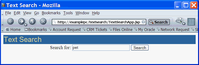

Figure A-1 shows what the JSP version of the text query application looks like. This application was created with the Oracle Text application wizard.

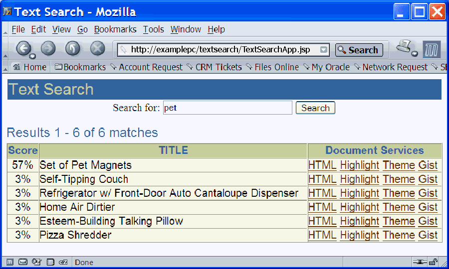

Figure A-2 shows the results of the text query.
Figure A-2 The Text Query Application with Results
Description of Figure A-2 follows
Description of "Figure A-2 The Text Query Application with Results"
The application returns links to documents containing the search term. Each document has four links:

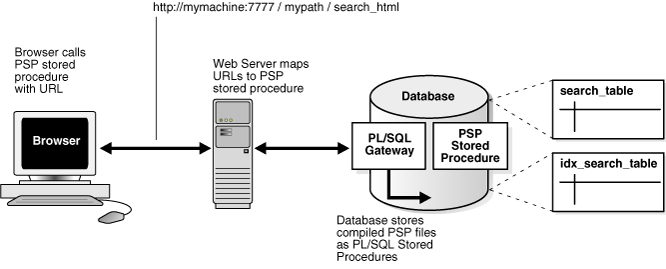

This application is based on PL/SQL server pages. Figure A-3, "The PSP Web Application" illustrates how the browser calls the PSP-stored procedure on Oracle Database through a Web server.

                 color="#CCCC99" size=+2>Text Search</td>
        </tr>
      </table>
    <center>
      <form method = post action="TextSearchApp.jsp">
      Search for:
      <input type=text name="query" value="<%=name.getValue() %>" size = 30>
      <input type=submit value="Search">
      </form>
    </center>

    if(count>=(startNum+20)){
    <font color="#336699" FACE="Arial,Helvetica" SIZE=+1>Results
           <%=startNum+1%> - <%=startNum+20%> of <%=count%> matches
    else if(count>0){
           <%=startNum+1%> - <%=count%> of <%=count%> matches
    else {
    <font color="#336699" FACE="Arial,Helvetica" SIZE=+1>No match found

    String ctxQuery = "select /*+ DOMAIN_INDEX_SORT */ rowid, 'TITLE',
     score(1) scr from 'ULTRA_TAB1' where contains('TEXT', '"+theQuery+"',1 )
     > 0 order by score(1) desc";
    rset = stmt.executeQuery(ctxQuery);
    String color = "ffffff";
    String rowid = null;
    String fakeRowid = null;
    String[] colToDisplay = new String[1];
    int myScore = 0;
    int items = 0;
    while (rset.next()&&items< 20) {
      if(loopNum>=startNum)
        rowid = rset.getString(1);
        fakeRowid = URLEncoder.encode(rowid);
        colToDisplay[0] = rset.getString(2);
        myScore = (int)rset.getInt(3);
        items++;
        if (items == 1) {
        <center>
          <table BORDER=1 CELLSPACING=0 CELLPADDING=0 width="100%"
            <tr bgcolor="#CCCC99">
              <th><font face="arial, helvetica" color="#336699">Score</th>
              <th><font face="arial, helvetica" color="#336699">TITLE</th>
              <th> <font face="arial, helvetica"
                       color="#336699">Document Services</th>
            </tr>
      <tr bgcolor="#FFFFE0">
        <td ALIGN="CENTER"> <%= myScore %>%</td>
        <td> <%= colToDisplay[0] %>
        <td>
        </td>
      </tr>
