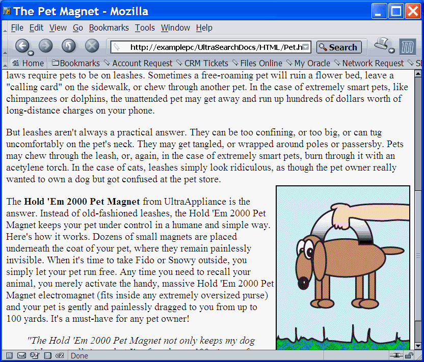

5.3.1 Highlighting Example
Figure 5-2 is a screen shot of a query application presenting the document shown in Figure 5-1 with the query term pet highlighted. This output was created using the text query application produced by a wizard described in Appendix A, "CONTEXT Query Application".
Figure 5-2 Pet Highlighted in Pet Magnet Document
Description of Figure 5-2 follows
Description of "Figure 5-2 Pet Highlighted in Pet Magnet Document"

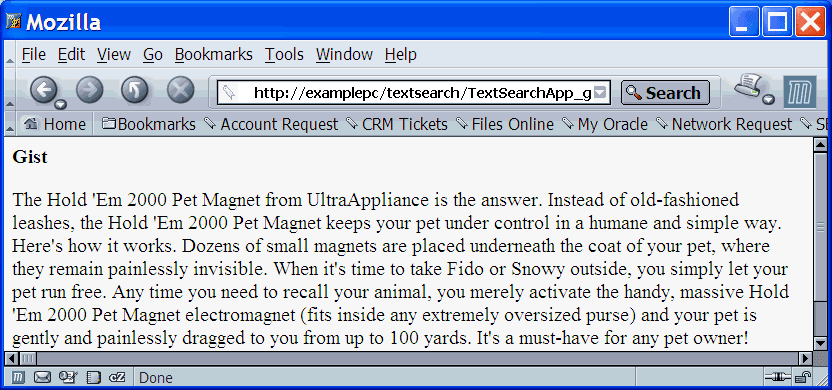

5.3.3 Gist Example
Figure 5-4 is a screen shot of a query application presenting a gist of the document shown in Figure 5-1. This output was created using the text query application produced by a wizard described in Appendix A, "CONTEXT Query Application".
Figure 5-4 Query Application Presenting Document Gist
