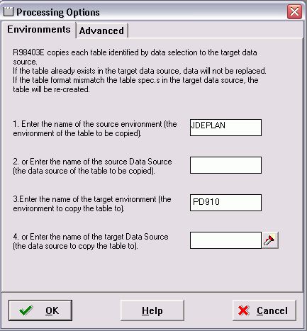

To load demo data in Production or Prototype environments, you must run a UBE (R98403E) to copy the data to those environments.
The "from" (source) environment can be the Planner environment or your Pristine environment.Caution:
You should not change the record selection on this UBE.Run R98403E using the XJDE0009 version and set the processing options as follows:
On Processing Options 1-4, complete these fields:
Option 1
Enter the name of the source environment, which is the environment of the table to be copied. For example, JDEPLAN.
Option 2
This field must be blank because this UBE is used to copy a mixture of business data and control tables which are specified to environments, not data sources.
Option 3
Enter the name of the target environment, which is the environment to which you wish to copy the table. In this case, you would specify either the Production or Prototype environments. For example, PD910.
Option 4
Click OK to continue specifying processing options.

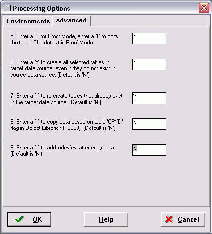

On Processing Options 5-9, complete these fields:
| Field | Description |
| Option 5 | The recommended value is 1, which copies the table.
The default value is 0, Proof Mode. |
| Option 6 | The recommended value is N, which copies tables only if they exist in the source.
Enter Y to copy tables whether or not they exist in the source data source. The default value is N. |
| Option 7 | The recommended value is Y, which recreates tables that already exist in the target data source.
Note: If you do not recreate the tables, you will end up with a mixture of production and demo data in the tables. The default value is N. |
| Option 8 | The recommended value is N, which forces a copy of the data, ignoring the CPYD flag.
Note: A value of Y will leave almost all tables empty. That is, a production data load. The default value is N. |
| Option 9 | The recommended value is N, which creates the indexes on the tables before copying the data. This prevents duplicate rows.
Note: A value of Y copies the data and then create the indexes. The default value is N. |
Click OK to accept the values and start the UBE.

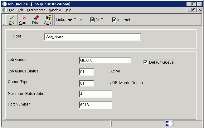

You may set up the job queues before running the Installation Workbench. If you do not, Initial Tasks Workbench will create a default entry for QBATCH with a setting of maximum=4.
If running an Install, you can set up the queues at any stage before running a Package Build. If you set up queues after the Installation Workbench, sign onto DEP910.To create the job queue:
Enter GH9013 in the Fast Path field and start the Job Queues program (P986130).
Click Add.
On Job Queue Revisions, add a queue by completing these fields:
| Host | Enter the Enterprise Server name. |
| Job Queue | Enter the job queue name. |
| Default Queue | Turn on this option by clicking the check box. |
| Job Queue Status | Enter 01. |
| Queue Type | Enter 01. |
| Maximum Batch Jobs | Enter a value that equals the number of processors on the Enterprise Server machine. |
| Port Number | Enter 6016.
If you receive a Network Failed error, you can safely ignore it in this case. |

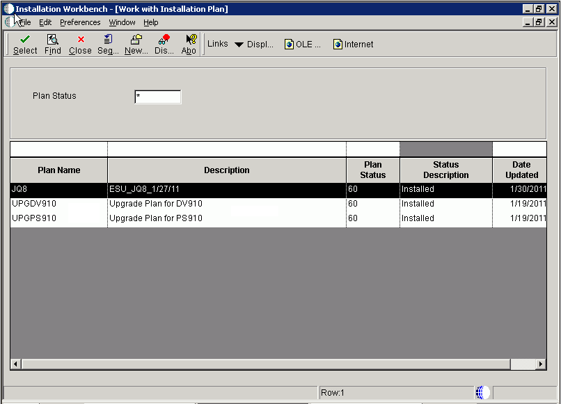

On Work with Installation Plan, double-click your plan.
Before the workbench is run, the F00945 table in the System data source is blank because it is no longer populated when a plan is validated. However, after you run the Initial Task Workbench several tables in the System data source are populated including the F00945 table.

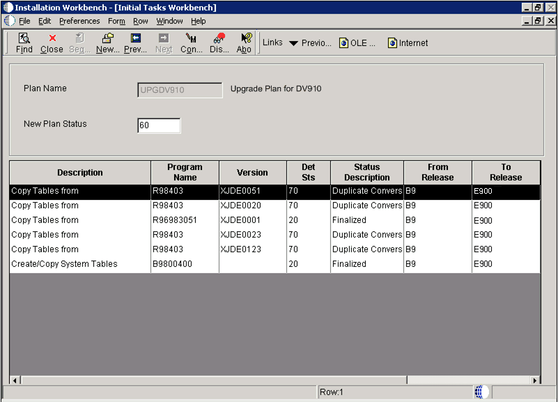

The Initial Tasks Workbench form lets you complete the Release Master task before the individual workbenches begin.
You use this procedure if you are running Workbench in attended mode or if you set a task break before Initial Tasks Workbench.
To change the status of Initial Tasks Workbench:
You might want to change the status of one or more of the initial workbench tasks. To change the status of a task, use the following procedure.
Enter GH961 in the Fast Path field to open the System Installation Tools menu.
Double-click Custom Installation Plan.
On Work with Installation Plans, select your installation plan.
Select Expand on the Row menu.
The plan components, including the initial tasks, appear.
Select the task whose status you want to change.
On the Row menu, click Disable, Enable, or Complete (see the table below).
The task status changes.
Disable
Displays a status of 70 to indicate the task is incomplete, and will not be rerun.
Enable
Displays a status of 10 to indicate the task will be rerun.
Complete
Displays a status of 60 to indicate the task is complete, and will not be rerun.

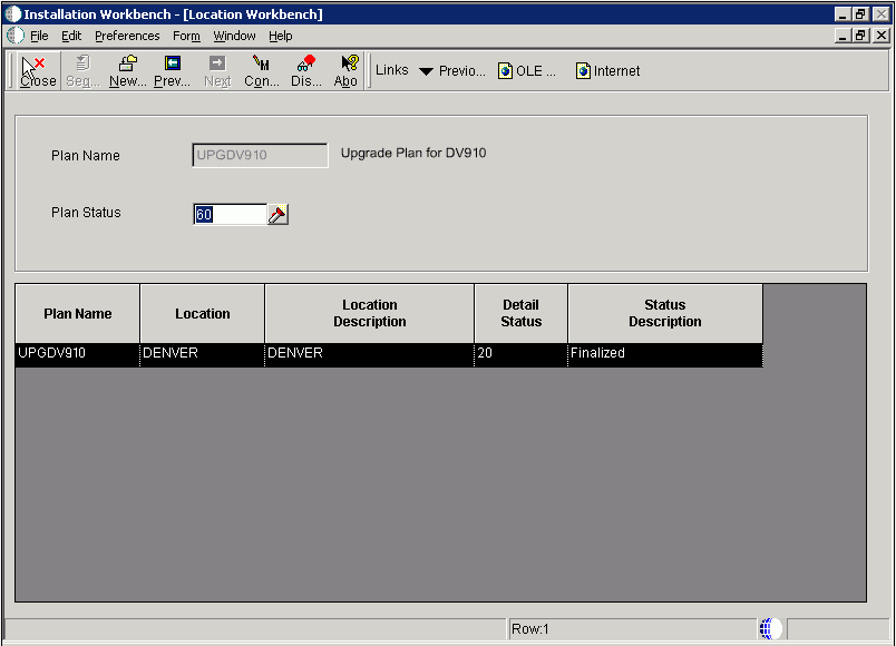

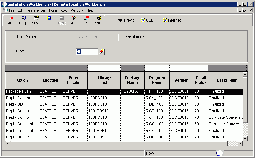

Location Workbench copies all locations that are defined in the plan from the F9654 table in the Planner data source to the System - 910 data source. It also updates the F984021 table. Use this procedure when running Workbench in attended mode or if you set a task break before Location Workbench.
On Location Workbench, verify that all of your locations are listed.
Select Configure from the Form menu.
Locations are configured, and the Data Source Workbench form appears.
The system updates the Detail Status to 60 and changes the Status Description from Validated to Installed.

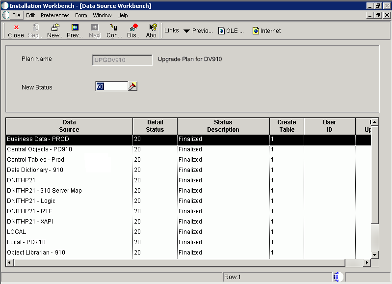

Data Source Workbench copies all data sources that are defined in the plan from the F98611 table and the F986115 table in your Planner data source to your System - 910 data source. It also updates the F98401 table to indicate completion. Use this procedure when running Workbench in attended mode or if you set a task break before Data Source Workbench.
On Data Source Workbench, verify that all of your data sources are listed as illustrated in this example.
Your data sources are configured, and the Environment Workbench form appears.
When the system has configured your data sources, it updates Detail Status to 60 and changes the Status Description from Validated to Installed.

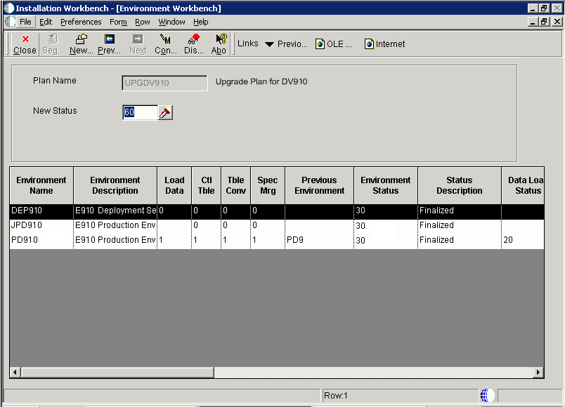

Environment Workbench copies the F0094, F00941, and F00942 tables, as well as the F986101 table for each environment, from your Planner data source to your System - 910 data source. It then updates the F98403 table to indicate completion. Depending on the plan settings, it also runs a batch application to copy new generic text and to create and populate Object Management Workbench and version tables.
Environment Workbench can run multiple batch applications simultaneously, which enables Release 9.1 to load multiple environments at the same time. This reduces the amount of time it takes to load environments.
Use this procedure when running Workbench in attended mode or if a task break is set before Environment Workbench.
On Environment Workbench, review each environment and its associated parameters to make sure the values are correct.
After you review the environments, select Configure.
When Environment Workbench has completed, verify that the status of each environment has been updated to 60 and that the status description has changed from Validated to Installed.
Using Adobe Acrobat, review all XJDE reports, and confirm that all configuration statuses indicate Success.

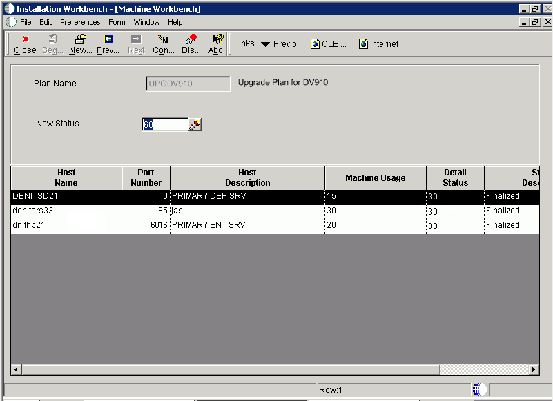

Machine Workbench copies the F9650 and F9651 table from the Planner data source to the System - 910 data source. It then updates the F98402 table to indicate completion and uses the environment information to populate the F986101 and F98611 tables in the Server Map data source.
Only valid environments, data sources, and server map tables are created.
On Machine Workbench, review each server and its associated parameters for the correct values.
When the system has configured your servers, it changes the detail status to 60, and Status Description changes from Validated to Installed.

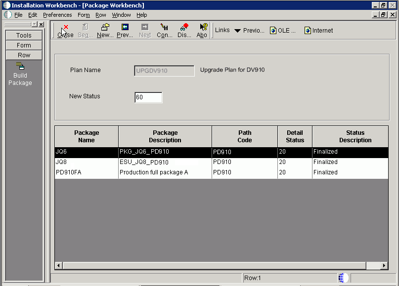

Package Workbench transfers the F9603 and F9631 tables from the Planner data source to the System - 910 data source. It then updates the F98404 table to indicate completion.
Use this procedure when running Workbench in attended mode or if a task break is set before Package Workbench. Refer to the JD Edwards EnterpriseOne Tools Package Management Guide for complete information about building and configuring packages.
On Package Workbench, review your packages.
This workbench only appears when Remote Locations have been set up.Remote Location Workbench loads business (master and constant), control, data dictionary, and system tables from base location to remote location servers, by launching different versions of R98403 (XJDE0043, XJDE0044, XJDE0045, XJDE0046 and XJDE0047). It also pushes delivered packages to primary Deployment Servers at remote locations by launching the multi-tier UBE (R98825C). This workbench is processed only if you opted to install remote locations and chose to load replicated data and push packages.
Use this procedure when running Workbench in attended mode or if a task break is set before Remote Location Workbench.
To configure remote locations:
To configure your remote locations:
On Remote Location Workbench, Release 9.1 displays all remote location activities in the detail area.
On the Form menu, select Configure to launch the workbench.
After all remote location activities are complete, click Next.
