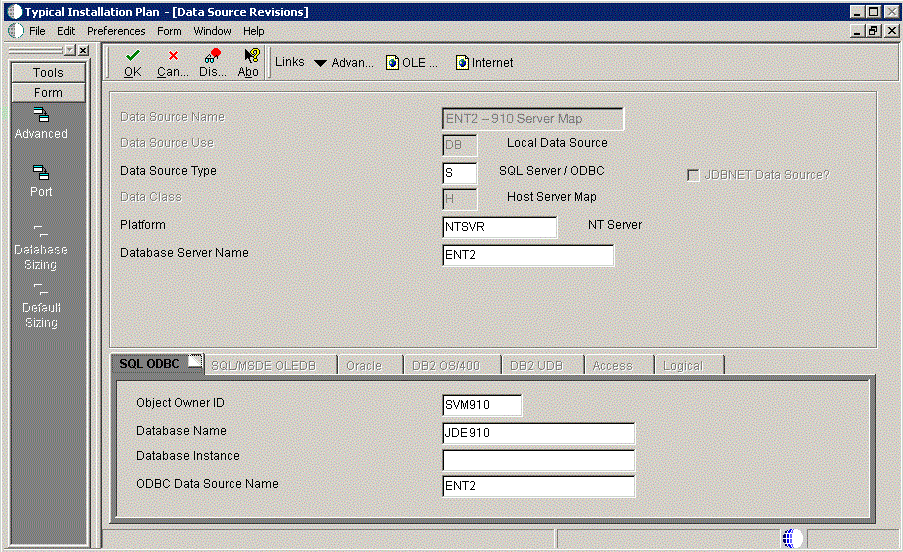

Server Map
Server Map data sources are specific to each Enterprise Server, so you must create one for each server.

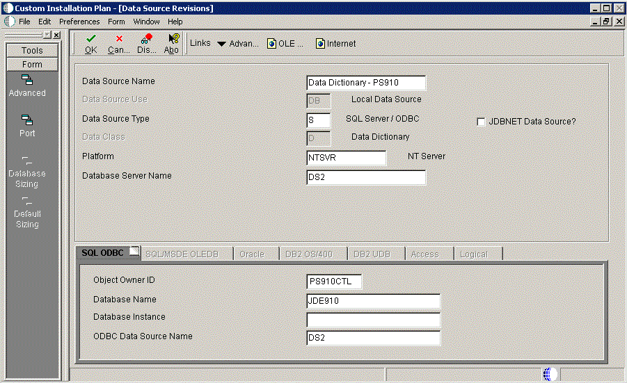

Data Dictionary
This is the data source for the Release 9.1 Data Dictionary tables. It is identified by the Release 9.1 release (for example, Data Dictionary - 910).

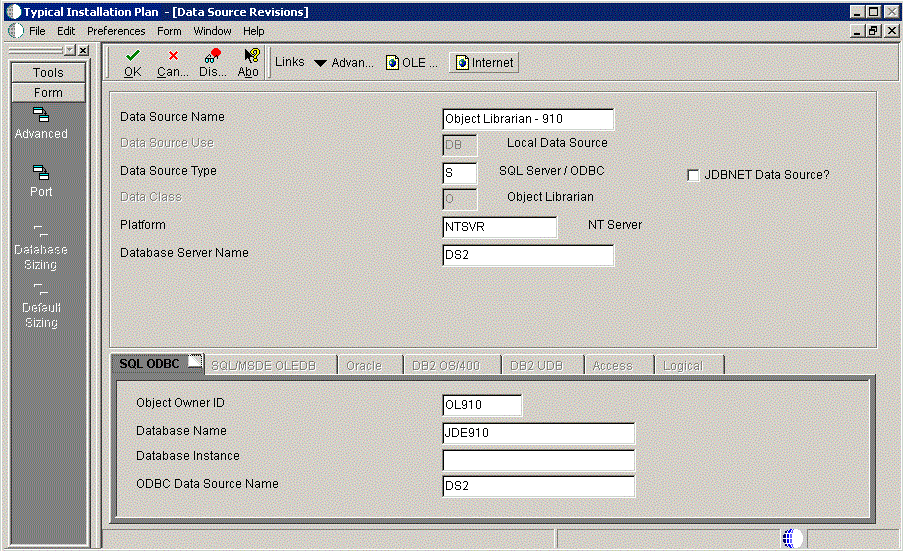

Object Librarian
This is the data source for the Object Librarian tables. It is identified by the Release 9.1 release (for example, Object Librarian - 910).

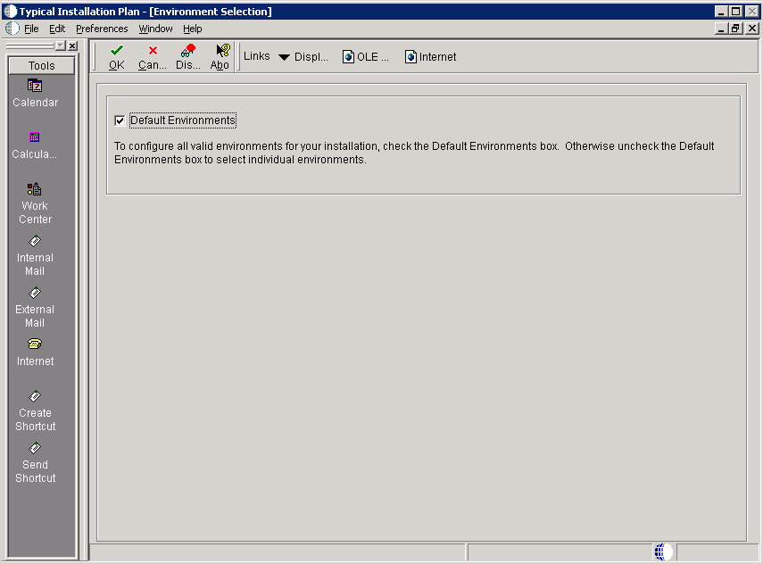

Installation Planner enables you to select default environments for your installation that are predefined, or you can choose to define them manually. Likewise, Installation Planner enables data load using default data load options, or you can choose to define them manually and override the default data load options.
The goal of the JD Edwards EnterpriseOne Release 9.1 Installation is to include the most current tools releases and updates at the time the installation image is mastered. However, subsequent to that time it is possible that critical fixes may become necessary and available. You should check Section 1.3.1, "Accessing Minimum Technical Requirements (Certifications)" to verify if any such JD Edwards EnterpriseOne Release 9.1 Installation fixes are required.

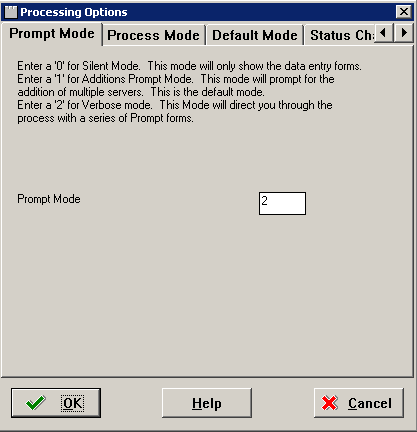

To specify the prompt mode:
Select the Prompt Mode tab.
On the Prompt Mode tab, select a prompt mode:
| Value | Model | Description |
| 0 | Silent | Installation Planner displays only the data entry forms. |
| 1 | Additions Prompt | Installation Planner prompts you to add servers. |
| 2 | Verbose | Installation Planner directs you through creating a plan with a series of prompting forms. |

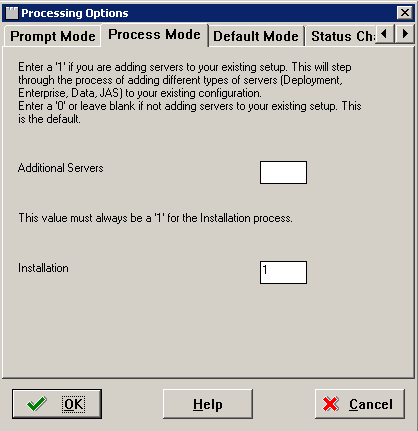

To specify the process mode:
Select the Process Mode tab.
On the Process Mode tab, select the options for the processes that you want to run when you create your plan:
Additional Servers
Enter 1 to add servers to your existing setup (Deployment Server, Enterprise Server, Database Server, HTML Web Server). Enter 0 or leave blank for regular plans.
Installation
Enter 1 to run the JD Edwards EnterpriseOne installation automatically.

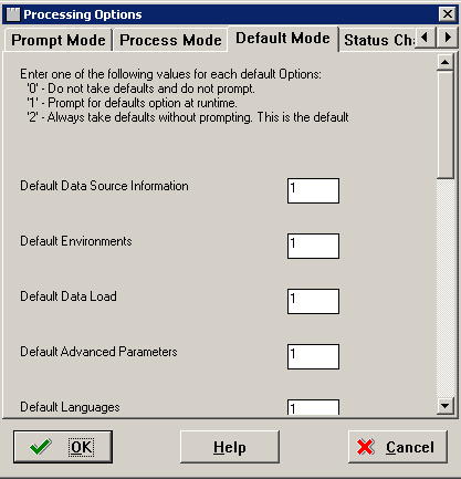

To specify the default mode:
Select the Default Mode tab.
On the Default Mode tab, enter these values into the processing option fields:
| Value | Description |
| 0 | Do not use default values and do not prompt. |
| 1 | Prompt for default options at run-time. |
| 2 | Default mode. Always use defaults without prompting. |
Default Data Source Information
Select whether you want the ability to modify data source information or just take the default values.
Default Environments
Select whether you want the ability to select environments or take the default values.
Default Data Load
Select whether you want the ability to modify data load parameters or take the default values.
Default Advanced Parameters
Select whether you want the ability to modify advanced parameters or take the default values.
Default Languages
Select whether you want the ability to select an alternate language or take the default values.
Upgrade/Update Plan Generation
Select whether you want the ability to generate a plan automatically from locations and machines defined in a previous version of the software.

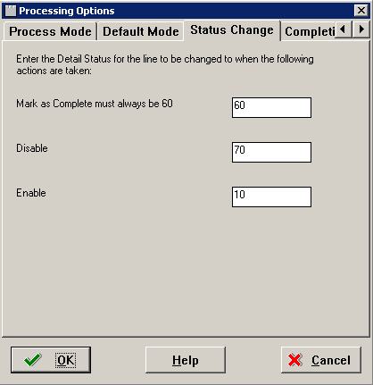

On the Status Change tab, this tab form appears.
Do not make any changes on this tab. These values are hard coded in the application

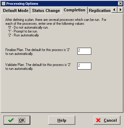

To specify plan completion processes:
Select the Completion tab.
On the Completion tab, complete the fields using these values:
After defining the plan, the options on this tab specify which processes are run. one of the following values:
| 0 | Do not run automatically. |
| 1 | Prompt to be run. |
| 2 | Run automatically. |
Finalize Plan
Enter the default option 2 to run automatically.
Validate Plan

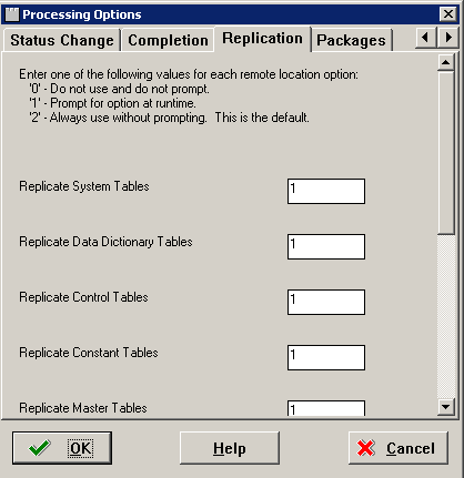

To specify replication options:
Select the Replication tab.
On the Replication tab, complete the fields using these values:
| 0 | Do not use and do not prompt. |
| 1 | Prompt for option at run-time. |
| 2 | Always use without prompting . |
Replicate System Tables
Select whether you have the option to replicate system tables automatically for remote locations.
Replicate Data Dictionary Tables
Select whether you have the option to replicate data dictionary tables automatically for remote locations.
Replicate Control Tables
Select whether you have the option to replicate control tables, menus, and user defined codes automatically for remote locations.
Replicate Constant Tables
Select whether you have the option to replicate constant tables automatically for remote locations. Business data tables are Object Librarian type 280.
Replicate Master Tables
Select whether you have the option to replicate master tables automatically for remote locations. Business data tables are Object Librarian type 210 and 211.

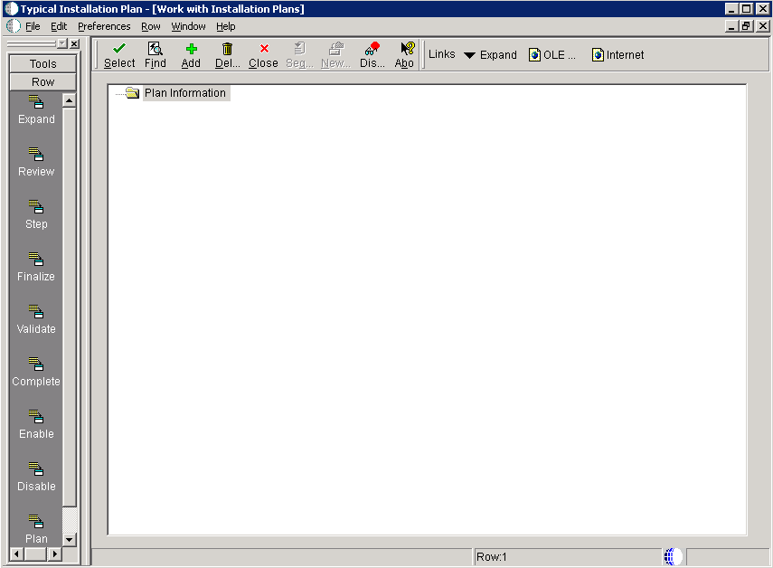

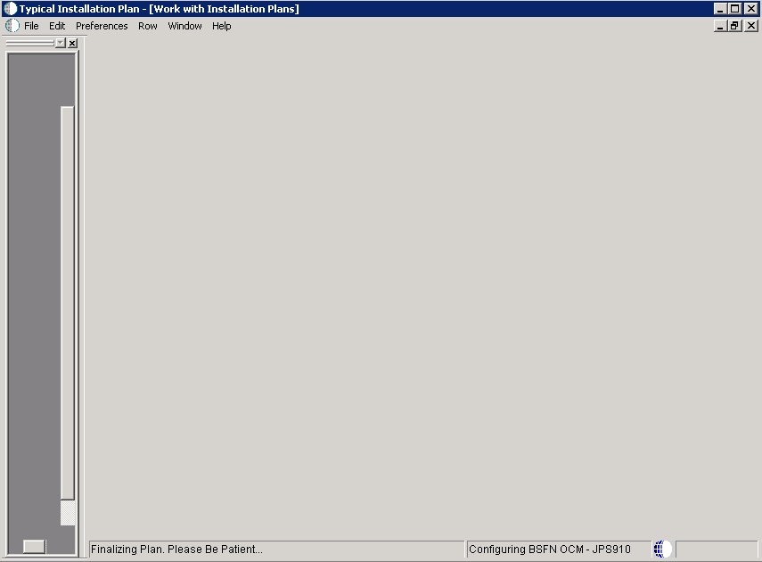

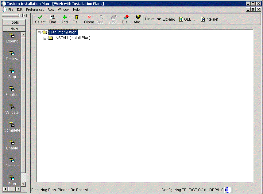

To start Installation Planner from within JD Edwards EnterpriseOne:
Access the System Installation Tools Menu (GH961).
On the System Installation Tools menu, double-click Typical Installation Plan.
On Work with Installation Plans, click Add.

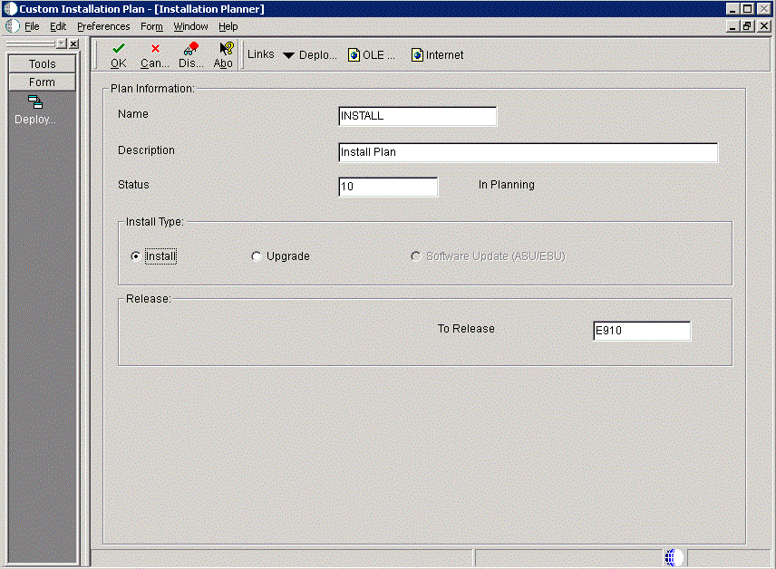

The Installation Planner form appears.
Enter a Plan description.
To enter a plan description:
On Installation Planner, complete these fields:
| Field | Description |
| Name | Enter the name of the installation plan. |
| Description | Enter the description of the installation plan. |
| Status | Choose 10 (the default value) as the status of the installation plan. |
| Install Type | Click the Install (the default value) radio button. |
| To Release | Verify that the release number is E910 (default value). |
Click OK to continue.

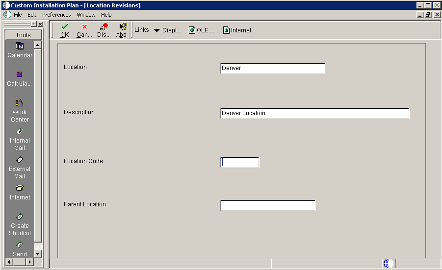

To enter location information:
On Location Revisions, complete these fields:
| Location | Enter the location to which this plan applies; the location can be a city, company headquarters, or a division of the company. |
| Description | Enter a description for this location. |
| Location Code | If this is the base location, this field is only available when you are adding the base location. If you are editing an existing base location, the field is unavailable. |
| Parent Location | If this is the base location, this field is only available when you are adding the base location. If you are editing an existing base location, the field is unavailable. |
Click OK.

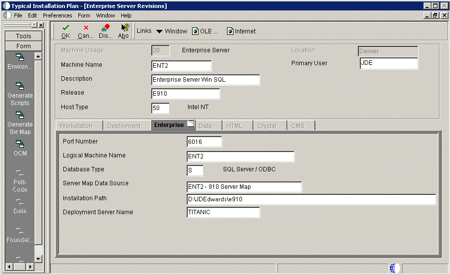

While Release 9.1 enables more than one Deployment Server to be defined, only the primary Deployment Server is defined at this time. You can choose a primary Deployment Server from the list of existing servers or you can enter information for a new server.
If you installed JD EnterpriseOne files to a remote Deployment Server, the deployment server name is the remote machine name by default.To enter Deployment Server information:

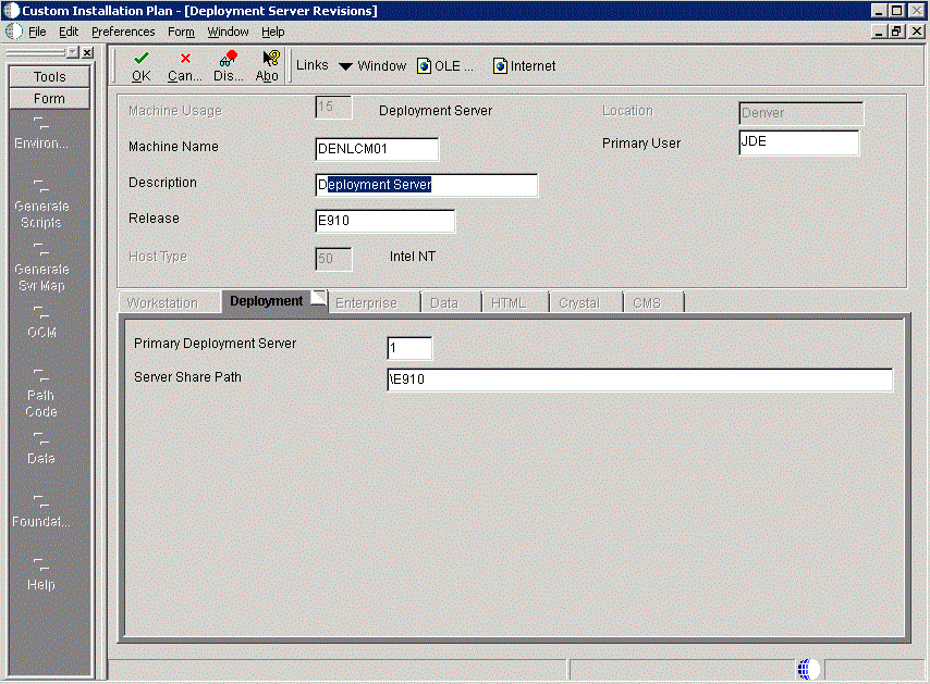

On Deployment Server Revisions, complete or verify these fields:
| Machine Usage | The value 15 appears by default, indicating that this is a Deployment Server. |
| Machine Name | The name of the Deployment Server appears by default. The name is case sensitive, should not exceed 15 characters, and should not contain any special characters.
Remote Deployment Server. If you installed JD EnterpriseOne files to a remote Deployment Server, the deployment server name is the remote machine name by default. |
| Description | Enter a long description for the machine. This description should include the location with which this Deployment Server is associated and whether or not it is the primary server. |
| Release | Enter the JD Edwards EnterpriseOne release number you are installing or use the visual assist button to choose one from the list. The default value is E910. |
| Host Type | The value 50 appears by default, indicating that the server type is Intel NT. |
| Location | Your current location is the default value. |
| Primary User | The user to whom an email is sent when a package is deployed. The default value for Primary User is listed in the JDE.INI. |
On the Deployment tab, complete this field:
| Primary Deployment Server | The hierarchy of the servers. Valid values are:
1- Primary Deployment Server (default value) 0 - Secondary Deployment Server The server share name of the directory to which you installed Release 9.1 on your Deployment Server. Verify that the server share name for Release 9.1 is:
Click OK.

On Enterprise Server Revisions, select the Enterprise tab, and complete or verify these fields:
| Port Number | The port number value (6016) for this Enterprise Server as supplied from the JDE.INI. |
| Logical Machine Name | The Installation Planner detects and provides a default value based on the current machine name on which the program is running. The name is case sensitive, should not exceed 15 characters, and should not contain any special characters. |
| Database Type | Enter the value for your database:
S - SQL Server ODBC |
| Server Map Data Source | Whenever you enter a host type, the Installation Planner populates this field with a default value:
machinename - 910 Server Map where machinename is the name of your machine. |
| Installation Path | Verify that the default value is the installation directory path to which you want to install Release 9.1 on the Enterprise Server. Make sure the value is specific to your version of the release. For example, for Release 9.1 the default path is:
Caution: You must change the value that defaults into the Installation Path field as shown in the screen capture above. |
| Deployment Server Name | Using the visual assist button, choose the name of the Deployment Server to which this Enterprise Server is attached. A Deployment Server name appears in this field by default, but it can be changed if necessary. |
If you change the port number to a value other than 6016, you must also change this setting in both the Enterprise Server and clientJDE.INI.Click OK.
To enter information for the Server Map data source:
On Data Source, click OK to continue entering unique data source information, or click Take Defaults to select the default data. If you select the default data, you can skip to Section 5.4.8, "Entering HTML Web Server Information".
On Data Source Revisions, verify the accuracy of the Server Map data source.
Click OK.

To verify the data source for Data Dictionary:
On Data Source Revisions, verify the accuracy of the settings for the Data Dictionary data source.
Click OK.
To verify the Object Librarian data source:
On Data Source Revisions, verify the accuracy of the settings for the Object Librarian data source.
Click OK.

To configure all valid environments for your installation, check the Default Environments box. Otherwise, uncheck the Default Environments box to select and verify individual environments.
Click OK.
Click the OK button to verify your environments.
Click OK.

When you click OK at this point, the Plan begins to finalize; the below screen is displayed with progress indicated in the lower left-hand portion.
When the plan complete the finalization process, the following dialog is displayed:
When the plan is finalized:
The status is set to 20, signaling that several adjustments to OCM mappings and tables are made according to your plan.
The system creates the OCM mappings and the JDE.INI.
These tables are updated:
Release Master table (F00945).
Path Code Master table (F00942).
Package Plan table (F98404).
Machine Detail table (F9651).
Language table (F984031), if you are installing a language.
To finalize the Installation Plan:
On the Information Prompt that indicates Installation Planner has concluded, click OK to exit the message box and initiate the Planner Validation Report.
If the processing option default was selected, Planner Validation Report automatically prompts you to run this report.
If the processing option default was not selected, click Validate on the tree view of your plan to initiate the Planner Validation Report.

On Work With Installation Plans, click Expand to review the plan you created.
On Installation Planner, complete the following fields:
| Name | Enter the name of the plan. |
| Description | Enter the description of the plan. |
| Status | Choose 10 (the default value). |
| Install Type | Click the Install (the default value). |
| To Release | Verify that the release number is E910 (the default value). |
| Include Languages | This is an optional selection that is only available if you have a language installation image installed on the Deployment Server. Select Yes if you are installing an alternate language.
Note: If you prefer, you can install an alternate language after you complete your master plan. To do so, select the Language Only option on this form. For more information, refer to Chapter 17, "Creating a Language-Only Installation Plan" |
Click OK.
On the Location dialog, click OK.
A location groups related Deployment Servers for use in a multi-tier environment.
| Location Code | If this is the base location, this field will be grayed out. |
| Parent Location | For the base location, this field will be grayed out. |
Click OK.
Click OK to add a Deployment Server.
| Machine Usage | Displays the value 15 by default to indicate that this is a Deployment Server. |
| Machine Name | The name of the Deployment Server appears by default. The name is case sensitive, should not exceed 15 characters, and should not contain any special characters. |
| Release | Enter the release number you are installing or use the visual assist button to choose one from the list. The default value is E910. |
| Host Type | Displays the value 50 appears by default, indicating that the server type is Intel NT. |
| Location | Displays the current location. |
| Primary User | Displays the user to whom an email is sent when a package is deployed. The default value for Primary User is JDE. |
| Primary Deployment Server | Enter the hierarchy of the servers. Values are:
Click OK.

On Enterprise Server Revisions, verify or complete these fields:
| Machine Name | The name of the primary Enterprise Server. The name is case sensitive and should not contain any special characters.
Because the machine name is used to create the Server Map datasource name, and because the Platform Pack Installer does not restrict you from entering a machine name that results in a datasource name greater than 30 characters; if the machine name for the Enterprise Server is longer than 13 characters, the resulting datasource name will be longer than the allowed 30 characters. For example, if your machine name is 15 characters (A23456789012345), the base datasource name in the server jde.ini will be:
Note: The field in table F98611 is a hard restriction; the field only allows 30 characters. The actual field size cannot be modified or changed. When the Planner runs it truncates the value to 30 characters because that is the restriction in the F98611 table. The Platform Pack does not truncate the value when it builds the jde.ini for the Enterprise Server. Therefore, any value greater than 30 characters will result in a mismatch between the To remedy, you could do any one of the following:
In any case, you must ensure that the values for Server Map datasource names in the F98611 table exactly match those in the |
| Description | Enter a description for the machine. |
| Release | Enter the release number to which this plan applies, or use the visual assist button to choose one from the list. The default value is E910. |
| Host Type | Click the visual assist button and choose the type of Enterprise Server you are adding to the plan. In this case, Intel NT. |
| Location | The location chosen for this plan appears by default. |
| Primary User | The user to whom an email is sent when a package is deployed. The default value for Primary User is JDE. |
The case of machine name must also match the network ID for that machine.Caution:
If you are using clustering, use the name of the SQL server database network as the machine name when installing Release 9.1, not one of the servers' machine names. For additional considerations, refer to Release 9.1 on a Cluster in the JD Edwards EnterpriseOne Tools Server and Workstation Administration Guide and the clustering software documentation.Continuing on Enterprise Server Revisions, select the Enterprise tab, and complete or verify these fields:
| Port Number | The port number value (6016) for this Enterprise Server appears by default from the JDE.INI. |
If you change the port number to a value other than 6016, you must also change this setting in both the Enterprise Server and workstation JDE.INIjde.ini.Click OK.
On Data Source, click OK to continue entering unique data source information, or click Take Defaults to select the default data. If you select the default data, you can skip to Section 5.5.8, "Entering HTML Web Server Information".
Click OK.
Click OK.

The Environment Selection screen appears.
This section discusses:
By default, Installation Planner configures your system using values for typical environments. Depending on the options chosen when you set up your plan, Release 9.1 displays one or more of the following parameters, which you can customize in the following tasks:
Environments
Data load options
You can customize any of these parameters by turning off the default option on the Environment Selection form. As you move through the plan, Installation Planner displays a customization form for each parameter that you clear.
To set up environments:
On Environment Selection, clear the options that you do not want to customize.
Different parameters appear depending on the options that you chose at the beginning of the planning process.Click OK.
If you selected the default option, which is to include all parameters, skip to Section 5.5.11.3, "Working with Environment Data Sources".Skip the tasks for those parameters that you did not clear. Otherwise, this section discusses these topics:

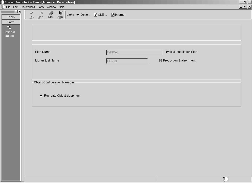

On Data Source Revisions, click the Advanced form option.
On Advanced Set-Up, because the central objects data source must be Unicode, verify the Unicode setting is checked.
Caution:
This task is only applicable to the Pristine Environment (PS910)
On Data Source Revisions, verify the accuracy of the settings for the Data Dictionary data source for the Pristine Environment.
Click OK.

When you click No on the Location dialog, the Planner begins to finalize the plan, as indicated by a status message in the lower left-hand portion of the screen:
Installation Planner displays a message to let you know that the installation plan has been finalized.
