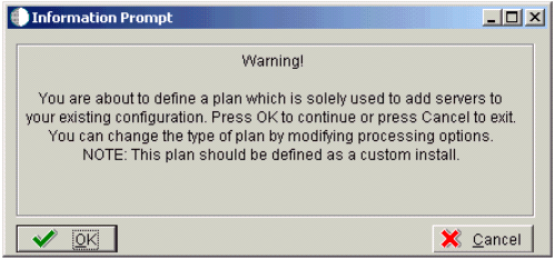

On Work with Installation Plans, click Add.
Release 9.1 displays the following warning:
Click OK.

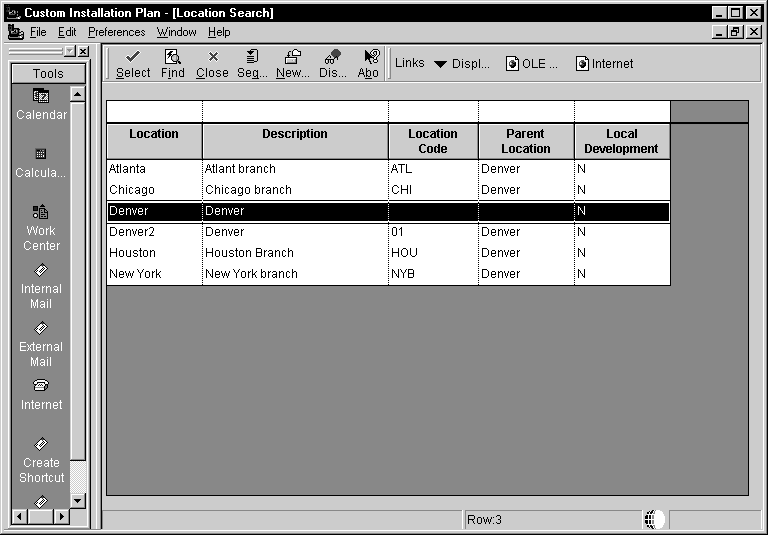

Once basic plan installation information is entered, you must choose an existing plan location. For most instances, choose the location defined during your base installation.
To enter a plan location:
On Location Search, choose a location and click Select.
On Location Revisions, click OK.

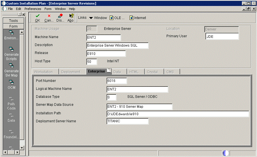

To enter the base information for the Enterprise Server that you use in this plan:
On Enterprise Server Revisions, complete or verify the following fields:
| Field | Description |
| Machine Usage | Displays the default value of 20 to indicate that this is an Enterprise Server. |
| Machine Name | When using cluster software, use the cluster name, not the machine name. Use the cluster name as the server name when installing Release 9.1. One copy of Release 9.1 will run and be shared by both nodes.
The name of the primary Enterprise Server. The name is case sensitive and should not contain any special characters. Because the machine name is used to create the Server Map datasource name, and because the Platform Pack Installer does not restrict you from entering a machine name that results in a datasource name greater than 30 characters; if the machine name for the Enterprise Server is longer than 13 characters, the resulting datasource name will be longer than the allowed 30 characters. For example, if your machine name is 15 characters (A23456789012345), the base datasource name input into the Planner would be: Note: The field in table F98611 is a hard restriction; the field only allows 30 characters. The actual field size cannot be modified or changed. When the Planner runs it truncates the value to 30 characters because that is the restriction in the F98611 table. The Platform Pack does not truncate the value when it builds the To remedy, you could do any one of the following:
In any case, you must ensure that the values for Server Map datasource names in the F98611 table exactly match those in the When using cluster software, use the cluster name, not the machine name. Use the cluster name as the server name when installing Release 9.1. One copy of Release 9.1 will run and be shared by both nodes. |
| Description | Enter a description of the machine. |
| Release | Enter the release number to which this plan applies, or use the visual assist button to choose one from the list, such as E910. |
| Host Type | Click the visual assist button and choose the type of Enterprise Server that you are adding to the plan, such as Intel NT. |
| Location | Enter the default location chosen for this plan. |
| Primary User | Enter the user to whom email is sent when a package is deployed. The default for Primary User is JDE. |
On the Enterprise tab, complete these fields:
| Port Number | Displays the default value for this field, which is supplied the JDE.INI. Change the port number for this Enterprise Server to a unique value, for example, 6016. |
| Logical Machine Name | Displays the system-supplied default value when you enter the host type. The name is case sensitive, should not exceed 15 characters, and should not contain any special characters. |
| Database Type | Enter the type of database that you want to use for data sources on the Enterprise Server. Value is:
S is for SQL Server |
| Server Map Data Source | Displays the system-supplied default value when you enter the host type. |
| Installation Path | Verify that the default value is the installation directory path to which you want to install Release 9.1 on the Enterprise Server. Make sure the value is specific to your version of the release. For example, for Release 9.1 the default path is:
| Deployment Server Name | Using the visual assist button, choose the name of the Deployment Server to which this Enterprise Server is attached. The system provides a default value for this field, but you can change it. |
Click OK.

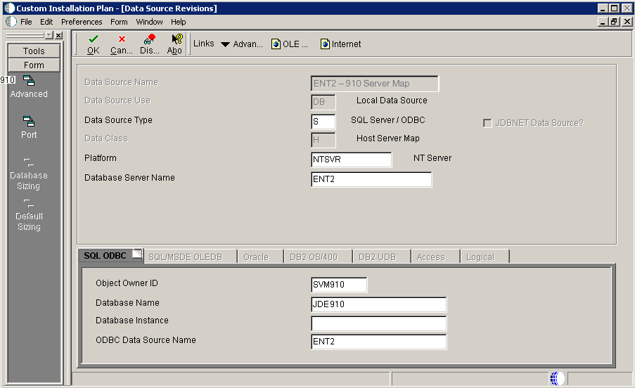

To verify custom Server Map data source information:
On Data Source Revisions, verify your Server Map data source information.

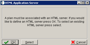

To enter HTML Web Server information:
On the HTML Application Server dialog, click OK to continue entering HTML Web Server information, or click Select to select an existing HTML Web Server.

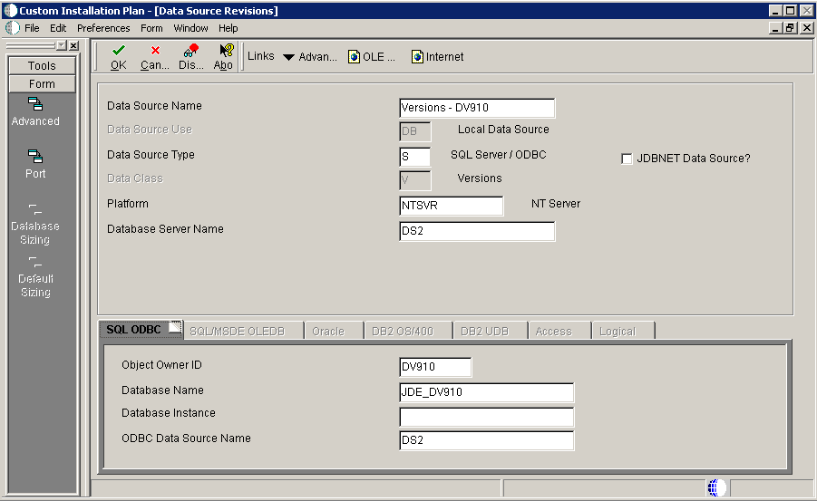

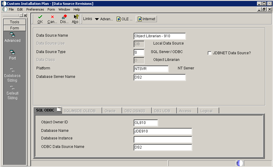

To verify the data source for Data Dictionary:
On Data Source Revisions, verify the accuracy of the settings for the Data Dictionary data source.
Click OK.
To verify the Object Librarian data source:
On Data Source Revisions, verify the accuracy of the settings for the Object Librarian data source.
Click OK.

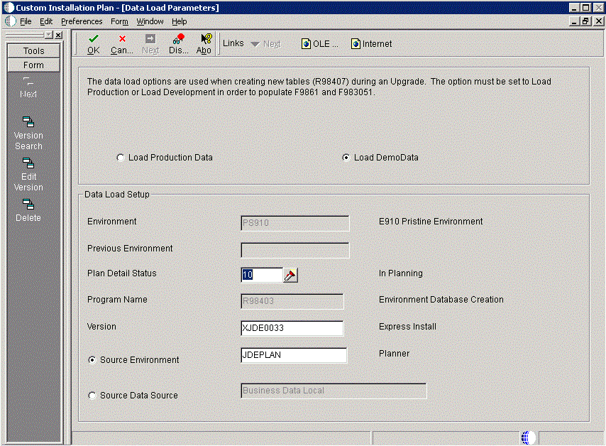

If you cleared Default Data Load on the Environment Selection form, the Data Load Parameters form appears.
To specify environment data load parameters:
The data load radio buttons on this form are no longer applicable as of JD Edwards EnterpriseOne Release 9.1 because data is automatically loaded by the Platform Pack Installer.For additional details, refer to Section 6.1.2, "Loading Data (Demo Data and Production Data)".

Once the Environments have been set up, it is necessary to set up the data sources for those environments. If you created a custom environment, data source information is generated from the data source template provided with JD Edwards EnterpriseOne.
See Also
To modify this template, see the JD Edwards EnterpriseOne Configurable Network Computing Implementation Guide.
When you are prompted to set up data sources for the environment you just configured, click OK to manually enter the data sources, continue with the following task, or click Take Defaults to accept the Release 9.1 default data sources.
To set up the data source for business data:
On Data Source Revisions, verify the data source for your Business Data.
Click OK.
Caution:
The Central Objects data source must be Unicode. Select Advanced from the Form menu to verifyUnicode is checked.
Click OK.
To set up the data source for central objects:
On Data Source Revisions, verify the information for your Central Objects data source.
Click OK.
On Advanced Set-Up, because the central objects data source must be Unicode, verify the Unicode setting is checked.
To set up the data source for control tables:
On Data Source Revisions, verify the accuracy of the Control Tables data source.

To verify the data source for versions:
On Data Source Revisions, verify the accuracy of the Versions data source.
Click OK.
Versions data sources are specific to the pathcode, and the Unicode flag on the Advanced Form must be checked.Installation Planner finalizes your installation plan automatically. A message appears to let you know that the installation plan is finalized.
