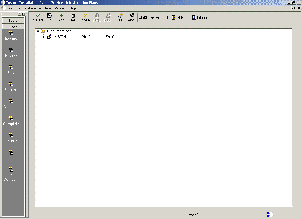

From the System Installation Tools menu (GH961), click Custom Installation Plan.
On Work with Installation Plans, click Add.
The Installation Planner form appears.
To enter information in Installation Planner:

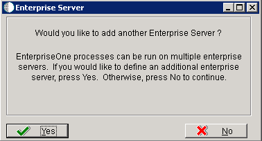

On the Would you like to add another Enterprise Server? dialog, click the Yes or No button.

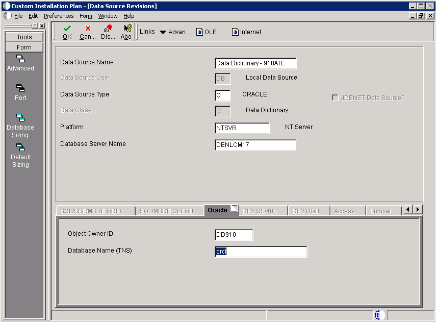

This section describes entering the shared data source information for the Data Dictionary and System data sources.
When you are prompted to enter the data source information for the shared data sources, to use the Release 9.1 data sources, click OK to specify or verify the data source information.
On Data Source Revisions, enter the data source name for the Data Dictionary data source that will be used by the remote location. For example, Data Dictionary - 910ATL.
Complete the other fields as applicable for your database and platform.
Click the OK button.

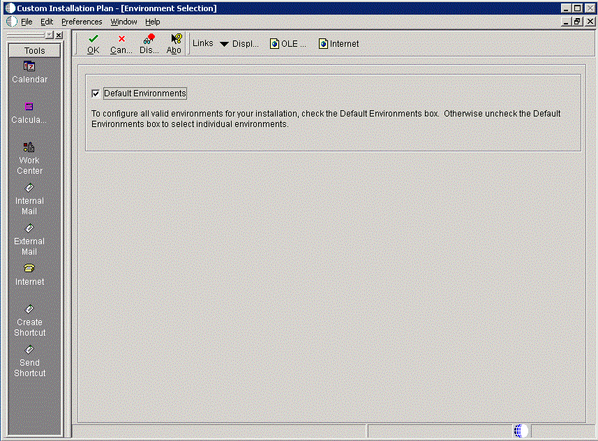

To set up environments:
On Environment Selection, with the Default Environments checkbox selected, click the OK button.
On Select Environments, double click on an Environment to select it.
Click the Close button.

On Data Source, click OK.
On Data Source Revisions, enter the data source name for the Business Data data source that will be used by the remote location. For example, Business Data - PS910ATL.

On Work With Installation Plans, click Expand to review the plan you created.
