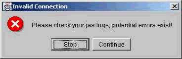

The system connects to the Web server that you indicated. A message appears on the status bar when login is complete.
Once you have logged in to a Web server, skip the following task and refer to the sections below it for information on how to generate objects.

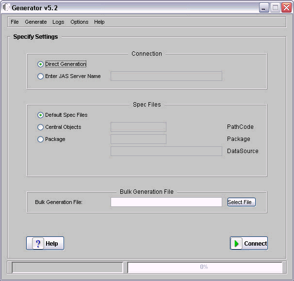

Select direct generation by clicking the Direct Generation radio button in the Connection section on the eGenerator application.
In this mode, the generator initializes a "mini" JAS Server instance on the generation machine. During generation, the generator will by-pass the actual JAS Server and store the objects directly to the serialized object tables. After you complete this task, you can set up the HTML Server to read from the pre-populated serialized object tables.

Click the Direct Generation radio button.
In Direct Generation Mode the eGenerator locates the serialized object database by looking for the database server in the server= setting of the JDBj-SPEC DATA SOURCE section of the jdbj.ini file located on the generation machine.
Click Connect.
The system bypasses the Web server and connects directly to the database specified in the jdbj.ini file.

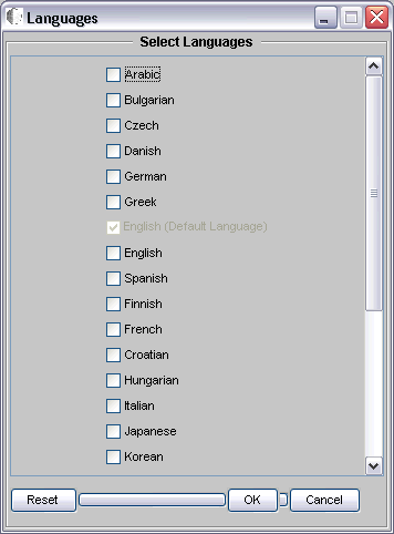

You can generate applications and reports in the language you desire by selecting any of the supported languages on the eGenerator application.
You must install the Language CD for each language you want to use.To select languages
On eGenerator, select OptionsLanguages from the pull-down menu.
Click the check box next to each of the languages you want to use.
Click OK.

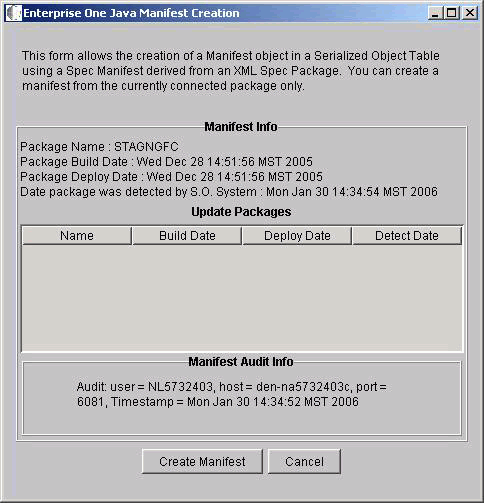

The section describes how to generate the manifest for the set of objects in the serialized object tables. For an overview of the serialized object manifest and a description of the package discovery process, refer to Chapter 10, "Understanding EnterpriseOne HTML Server Package Discovery".
To generate serialized object manifests
From the pull-down menu, select GenerateManifest.
Click Create Manifest.
Click Yes.
The program creates the manifest and closes the window.
To view the manifest that was created, from the pull down menu, select GenerateManifest.
The Manifest Info section displays the name of the package, the build date, and the deployment date. This manifest shows that no update packages were deployed.
The Manifest Audit Info field contains information about the user and the machine that created the manifest.

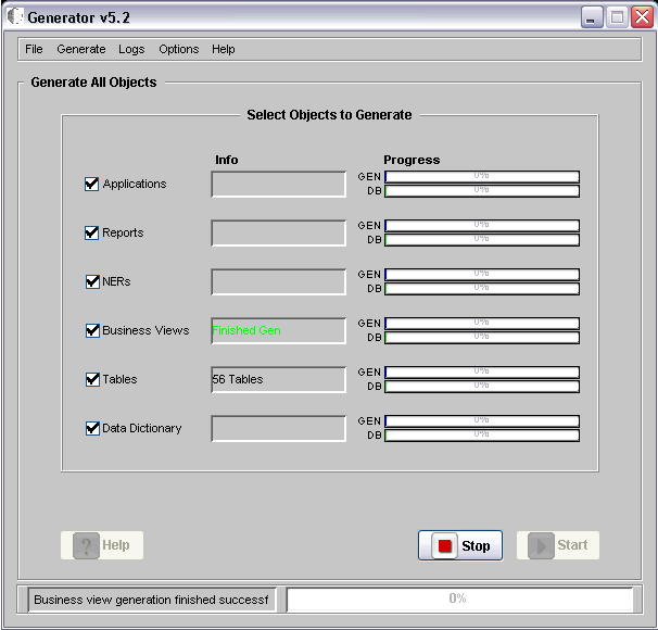

eGenerator can generate a complete set of Java Serialized Objects from JD Edwards EnterpriseOne objects. These serialized objects enable you access to all JD Edwards EnterpriseOne objects when you run your web server. If, however, you only want to generate a partial set of objects, skip this task and complete the relevant task in the section: Section A.9, "Generating Other Selected Objects Using JD Edwards EnterpriseOne 8.12".
Complete this task to generate a complete set of JD Edwards EnterpriseOne objects.
To generate all JD Edwards EnterpriseOne objects
From the pull-down menu, select FileCore Objects.
For more information on generating core objects, see Section A.9.1, "Generating Core Objects".
If the core objects generate successfully, from the pull-down menu, select GenerateAll Objects .
On Generate All Objects, check all the objects listed.
Click Start.
eGenerator checks the database connection before it attempts to generate objects.
If it cannot connect to the database, eGenerator displays this screen:
If this screen displays, click Stop and verify the connection to the database.
If the last Generate-All session did not conclude successfully, eGenerator displays a screen with the details of the failed generation.
Select one of these options:
To resume the previous generation process, click RESUME OLD SESSION. You should select this option, which restarts the previous process from the point of failure. Once the previous process completes, you can repeat this task to generate the new set of objects.
To cancel the previous generation process and generate the new objects, click CREATE NEW SESSION.
Select this option if you are currently generating a complete new set of all object types.
In either case, an object set starts generating. The progress of object generation is displayed on the screen: the blue progress bar indicates the progress of the generation process, and the green progress bar indicates the progress of objects inserted into the database.
If the database insertion of objects is not complete when the generation is done, the eGenerator displays the number of objects remaining in the queue.
Once all the objects are inserted into the database, the program displays a message that the "Generation completed successfully."

A sample text file named BulkGen.txt is included with the HTML Server or Web Development Client under the WEB-INF directory. This file contains sample entries in the format that can be read by the eGenerator. Modify this file to include just the large, frequently used applications.
To run the bulk generation file
Run launchGen.bat.
On eGenerator, complete this field:
Bulk Generation File: Enter the name of the file, or click Select File, and select the Bulk Generation File.
It may take some time for the system to connect to the file.
Select a Connection option (either Direct Generation or JAS Server).
Select Default Spec Files.
Click Connect.
Log on to JD Edwards EnterpriseOne and click OK.
From the pull-down menu at the top of the screen, select FileBulk Generation.
Click Start.
eGenerator will generate all the objects listed in the file you selected. When the process is complete, eGenerator displays a message: Generation Completed Successfully.

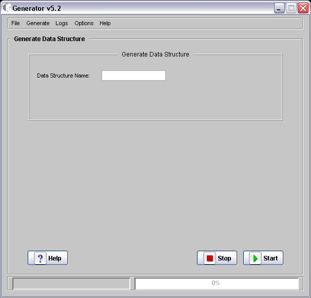

To generate data structures
From the pull-down menu, select Generate -> Data Structures.
Enter the name of a data structure, for example, D9800150C.
Click Start.
eGenerator generates the data structure.
Check the status log for the generation status.
