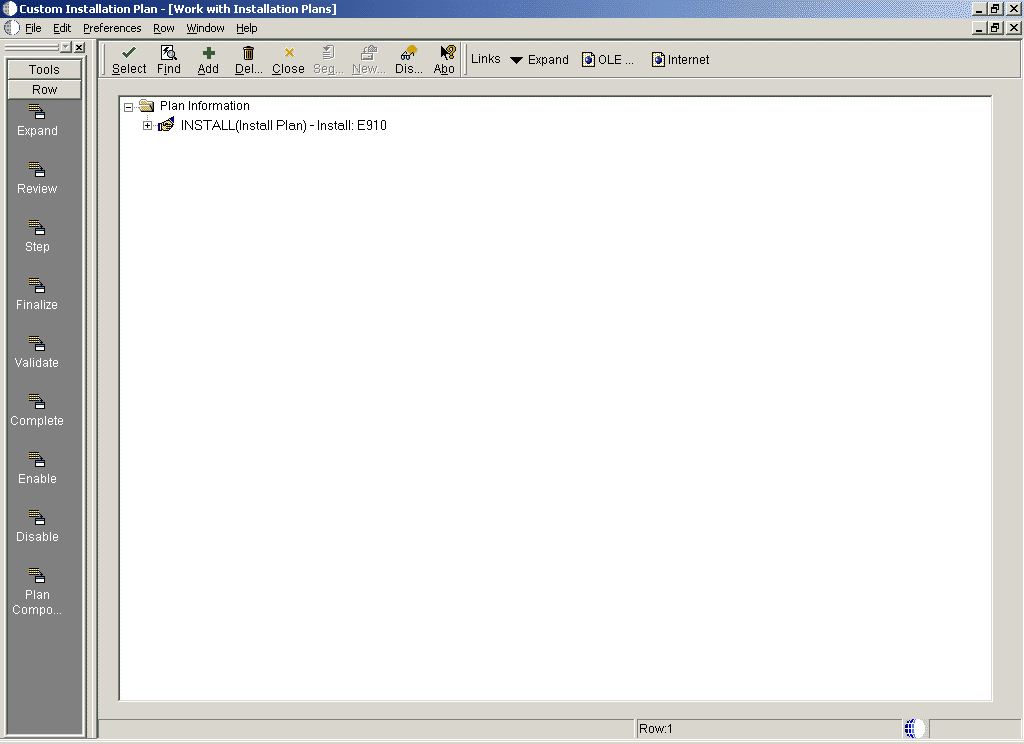

Log on to Release 9.1 as user JDE with the database password for user JDE.
Access the planner environment (JDEPLAN).
From the System Installation Tools menu (GH961), click Custom Installation Plan.
On Work with Installation Plans, click Add.
The Installation Planner form appears.

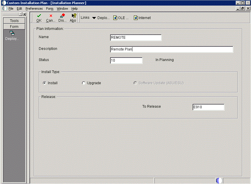

To enter information in Installation Planner:
On Installation Planner, complete these fields:
| Field | Description |
| Name | Enter the name of your remote plan. |
| Description | Enter the description of your remote plan. |
| Status | Select 10 as the status of your remote plan. |
| Install Type | Select Install. |
| To Release | Verify that the release number is E910. |
On Installation Planner, click OK.

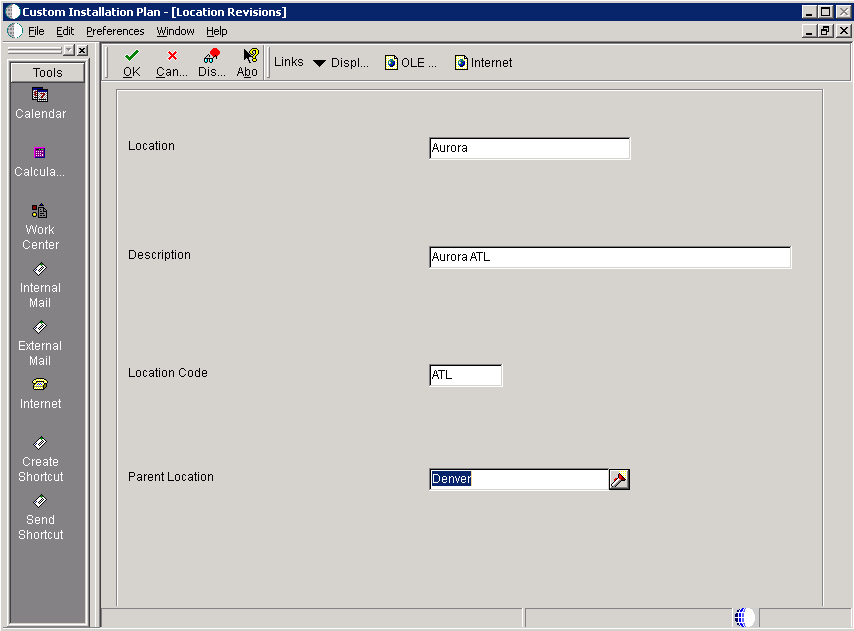

To enter plan location information:
On Location Revisions, complete these fields:
| Location | Enter the location to which this plan applies. The location could be a city, company headquarters, or a division of a company. |
| Description | Enter a description of the location name. |
| Location Code | For a remote location, enter a 3-character alphanumeric identification code. This 3-character code is used as a prefix for the environments of the remote location, and a suffix is attached for replicated data sources. For example, you might use DAL if the location were Dallas, Texas. In that case, the prototype environment would be named DALPY910, and the business data data source would be named Business Data - CRPDAL. |
| Parent Location | Enter the parent location to which this remote location is attached. |
Click OK.

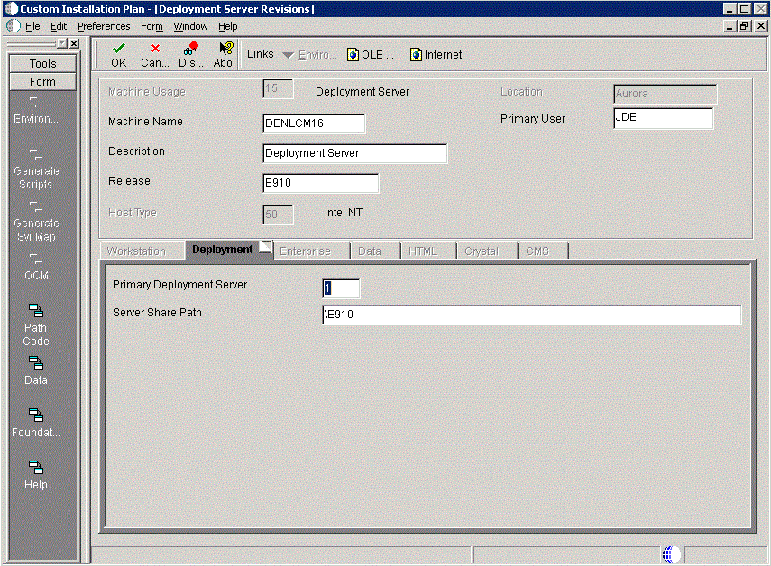

Once a plan location is specified, complete the information for the Deployment Server. You are given the option to enter a new Deployment Server or choose an existing one. For most situations, you will have a tiered Deployment Server for the remote location.
To enter Deployment Server information:
At the Installation Planner prompt asking if you want to enter new Deployment Server information, click OK to add a Deployment Server.
On Deployment Server Revisions, complete these fields:
| Machine Usage | Displays the default value of 15 to indicate that this is a Deployment Server. |
| Machine Name | Enter the name of your Deployment Server. The name is case sensitive, should not exceed 15 characters, and should not contain any special characters. |
| Description | Enter a description of the machine name. This name includes the location with which this Deployment Server is associated, and whether or not it is the primary server. |
| Release | Enter the Release 9.1 release number that you are installing, or use the visual assist button to choose one from the list. For example, E910 is the current release. |
| Host Type | Displays the default value of 50 to indicate that the server type is an Intel NT. |
| Location | Displays the default location chosen for this plan. |
| Primary User | Enter the user to whom email is sent when a package is deployed. The default for Primary User is JDE. |
On the Deployment tab, complete these fields:
| Primary Deployment Server | Enter the hierarchy of the servers. Type
0 (zero) if a primary Deployment Server for the location exists and this is a secondary server. Type 1 if this is the primary Deployment Server for the location. |
| Server Share Path | Enter the server share path where you installedRelease 9.1 on your Deployment Server. Make sure that this path is specific to your version of the release. For example, for Release 9.1, the path ends with\E910. |
Click OK.

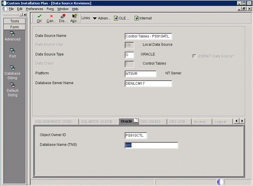

To enter information for the Server Map data source:
On Data Source, click OK to continue entering unique data source information.
On Data Source Revisions, verify the accuracy of the Server Map data source.
Click OK.

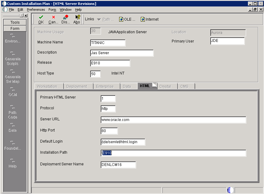

On HTML Server Revisions, complete these fields:
| Machine Usage | The default value of 30 indicates that this is a HTML Web Server. |
| Machine Name | Enter the name of your HTML Web Server. The name is case sensitive, should not exceed 15 characters, and should not contain any special characters. |
| Description | Enter a description of the HTML Web Server machine. |
| Release | Enter E910 to indicate the release number that you are installing. |
| Host Type | The default value of 50 specifies the server type as Intel NT. Select the correct server type. |
| Location | The location chosen for this plan appears in this field by default. |
| Primary User | The user to whom an email is sent when a package is deployed. The default for Primary User is listed in the JDE.INI. |
On the HTML tab, complete these fields:
| Primary HTML Server | When the system code generates an email message with a web shortcut pointing to a form, the web shortcut generated points to the "Primary" HTML Web Server. Only one of all the HTML Web Servers defined in installation planner can be defined as primary ("1"). |
| Protocol | This is the protocol used by the HTML Web Server. Valid values are http or https. |
| Server URL | This is the Domain Name System (DNS) host name of the HTML Web Server.
The syntax is:
For example:
| Http Port | This is the port number the HTML Web Server is listening to.
For HTTP, the typical port number is 80. For HTTPS, the typical port number is 443. However, you can choose to implement a HTML Web Server using a different port number. |
| Default Login | Defines how shortcuts to a web form are generated by the system code. Values are either a reserved value or an explicit servlet name. Reserved values are:
| Installation Path | Enter the installation directory path to which you are installing Release 9.1 on your HTML Web Server.Make sure this is specific to your version of the release, and also the platform and application server on which your HTML Web Server is running.
For default paths, refer to the applicable platform- and application server-dependent version of the JD Edwards EnterpriseOne HTML Web Server Reference Guide (WebLogic for Windows, WebLogic for UNIX, WebSphere for Windows, WebSphere for UNIX, WebSphere for IBM i. Otherwise, you must obtain this value from the HTML Web Server machine itself, or its administrator. |
| Deployment Server Name | Using the visual assist button, choose the name of the Deployment Server to which this HTML Web Server is attached. A Deployment Server name appears in this field by default, but you can change it if necessary. |

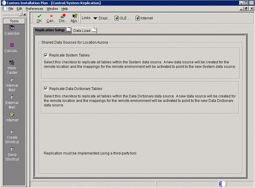

The options on this form determine whether the software will configure data sources and mappings for the remote location. Ongoing replication must be implemented using third-party software.
To replicate information to remote locations:
On Control/System Replication, select the Replication Setup tab and select the following options to replicate information to remote locations:
| Replicate System Tables | Select this checkbox to replicate all tables within the System data source. A new data source will be created for the remote location and the mappings for the remote environment will be activated to point to the new System data source. |
| Replicate Data Dictionary Tables | Select this checkbox to replicate all tables within the Data Dictionary data source. A new data source will be created for the remote location and the mappings for the remote environment will be activated to point to the new Data Dictionary data source. |
Caution:

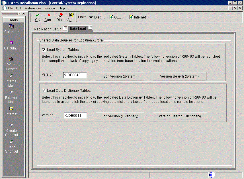

Replication must be implemented using a third-party tool.Select the Data Load tab.
On the Data Load tab, choose from the following options to copy selected tables to the remote locations:
| Load System Tables | Select this checkbox to initially load the replicated System Tables. The following version of R98403 will be launched to accomplish the task of copying system tables from the base location to remote locations. |
| Load Data Dictionary Tables | Select this checkbox to initially load the replicated Data Dictionary Tables. The following version of R98403 will be launched to accomplish the task of copying data dictionary tables from the base location to remote locations.. |
To edit or change the versions of the R98403 program that copy the control tables, constant tables, and master tables, click the Edit or Search buttons next to their respective versions.Note:

This section describes entering the shared data source information for the Data Dictionary and System data sources.
When you are prompted to enter the data source information for the shared data sources, to use the Release 9.1 data sources, click OK to specify or verify the data source information.
On Data Source Revisions, enter the data source name for the Data Dictionary data source that will be used by the remote location. For example, Data Dictionary - 910ATL.
Complete the other fields as applicable for your database and platform.
Click the OK button.
On Data Source Revisions, enter the data source name for the System data source that will be used by the remote location. For example, Data Dictionary - 910ATL.

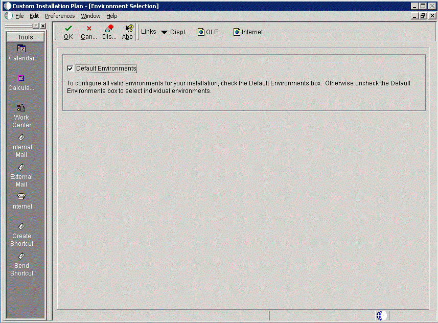

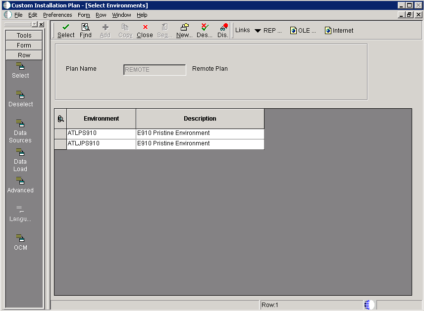

To set up environments:
On Environment Selection, with the Default Environments checkbox selected, click the OK button.
On Select Environments, double click on an Environment to select it.
Click the Close button.

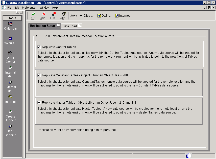

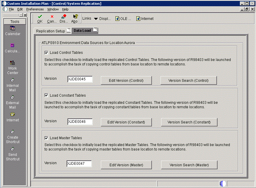

| Replicate Control Tables | Select this checkbox to replicate all tables within the Control Tables data source. A new data source will be created for the remote location and the mappings for the remote environment will be activated to point to the new Control Tables data source. |
| Replicate Constant Tables - Object Librarian Object Use = 280 | Select this checkbox to replicate Constant Tables. A new data source will be created for the remote location and the mappings for the remote environment will be activated to point to the new Constant Tables data source. |
| Replicate Master Tables - Object Librarian Object Use = 210 and 211 | Select this checkbox to replicate Master Tables. A new data source will be created for the remote location and the mappings for the remote environment will be activated to point to the new Master Tables data source. |
Caution:
| Load Control Tables | Select this checkbox to initially load the replicated Control Tables. The following version of R98403 will be launched to accomplish the task of copying Control tables from the base location to remote locations. |
| Load Constant Tables | Select this checkbox to initially load the replicated Constant Tables. The following version of R98403 will be launched to accomplish the task of copying Constant tables from the base location to remote locations. |
| Load Master Tables | Select this checkbox to initially load the replicated Master Tables. The following version of R98403 will be launched to accomplish the task of copying Master tables from the base location to remote locations. |
If you have defined multiple locations, the system will prompt you to complete sets of the Replication Setup and Data Load screens for each location.Click OK.
After specifying which tables to replicate, you can set up environment data sources.
On Data Source, click OK.
On Data Source Revisions, enter the data source name for the Business Data data source that will be used by the remote location. For example, Business Data - PS910ATL.
On Data Source Revisions, enter the data source name for the Control Tables data source that will be used by the remote location. For example, Control Tables - PS910ATL.
On Select Environments, click the Close button to exit the form.

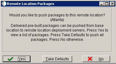

After you complete the data source setup for the environments, you can choose whether to push packages to a remote location.

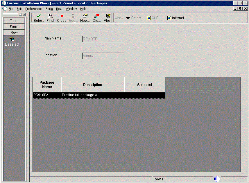

On Remote Location Packages, click the OK button.

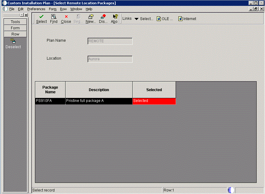

On Remote Location Packages, click the Select button to choose the highlighted package.
On Remote Location Packages, verify that "Selected" is displayed in the "Selected" column.

On Work With Installation Plans, click Expand to review the plan you created.
