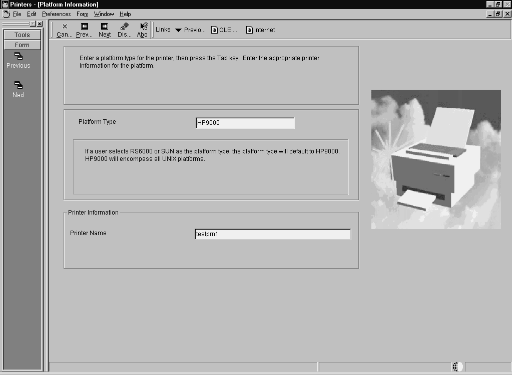

    The Platform Information form appears. The platform type may appear by default, depending on the operating system on which Release 9.1 is running.
    Surrounding text describes add_printer_unix.gif.
  4. On Platform Information, complete these fields:
    Field Description
    Platform Type Enter the platform type on which you are installing or use the visual assist button to select a platform type.
    Platform Type This value is displayed by default as a result of the Platform Type you selected.
    Printer Name Enter the name of the printer. Valid characters are all alpha (A-z), numeric (0-9), and underscore ( _ ).

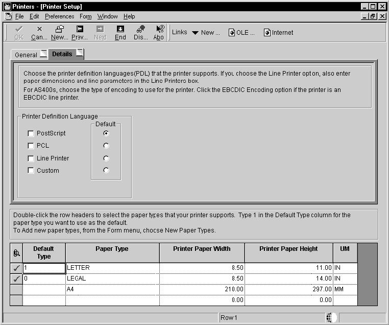

    Use this form to set information for the printer such as the printer model, physical location of the printer, printer definition language (PDL), and paper types.
  6. On the General tab, complete these fields:
    • Printer Model
    • Printer Location
  7. On the Details tab, in the box labeled Printer Definition Language, select one of these options:
    • PostScript
    • PCL
    • Line Printer
    • Custom
  8. In the Default box, specify one of the Printer Definition Language options as the default value.
    You can select multiple PDLs, but only one default PDL. A user can override this default PDL at the time a batch process is submitted.
    Choosing PostScript or Printer Command Language (PCL), Release 9.1 disables the Line Printer option. Choosing Line Printer, Release 9.1 disables the PostScript and PCL options.
    When choosing the Line Printer option, this logic occurs:
    • Release 9.1 disables the grid at the bottom of the form and any paper types you have chosen are cleared.
      JD Edwards EnterpriseOne automatically provides a printer type of *JDE LINE PAPER for the printer.
    • The Fields in the box labeled Line Printers are used to set the paper dimensions and line parameters.
      This procedure is explained in later steps in this section.
    The custom option uses advanced features of the printers application, which are explained in the later steps in this procedure.
  9. On the Details tab, when choosing the PostScript option, the Paper Source box appears and you can change these options:

  10. On the Details tab, when choosing the Line Printer option, fields appear in a box labeled Line Printers, which you use to set the paper dimensions and line parameters.
    Complete these fields:
    Field Description
    Characters Per Inch Enter a value to specify the number of characters in one horizontal inch.
    Columns Per Page Enter a value to specify the number of characters in one line of text in the specified report.
    Lines Per Inch Enter a value to specify the number of lines of text in one vertical inch.
    Lines Per Page Enter a value to specify the number of lines of text on one printed page.
    Printer Paper Width Displays a value that is calculated automatically based on the values entered in the Line Printers box.
    Printer Paper Height Displays a value that is calculated automatically based on the values entered in the Line Printers box.

  16. In the grid at the bottom of the Printer Setup form, double-click the row header for each paper type that your printer supports. A checkmark appears in the row header for each paper type that you select.
    You can add new paper types as necessary. Instructions are included later in this task.
  17. In the Default Type column, enter the numeral 1 in the row for the paper type you want to use as the default.
    select only one paper type as the default. A user can override the default paper type when a batch process is submitted.

    Printer Model Define these attributes for your printer:
    • Printer Model
    • Printer Location
      Designates the physical location of the printer
    Paper Type Enter a user defined code (H98\PT) to define the type of printer paper, such as letter or legal. For example, LETTER, LEGAL, and A4.
    Paper Width Define the width of the paper for this paper type. This value is in the unit of measure specified by Unit of Measure.
    Paper Height Define the height of the paper for this paper type. This value is in the unit of measure specified by Unit of Measure.
    Unit of Measure Enter a user defined code (00\UM) to define the quantity in which to express an inventory item. For example, CS (case) or BX (box). Form-specific information indicates the unit of measure in which the paper height and width are entered. For example, IN = Inches and MM = Millimeters.
    Columns Per Page Define the number of columns per page. For example, 80 or 132.
    Characters Per Inch (CPI) Define the horizontal printing density in characters per inch.
    You should only define values that are supported by your printer.
    Line Per Page Define the number of lines per page. For example, 60 or 66.
    Line Per Inch (LPI) Define the line spacing in lines per inch.
    Values are:
    4 - IBM 5219, 5224, 5225, and 3287 printers only
    6 - IBM 5224 printer only
    8 - IBM 5224 printer only
    9 - IBM 5225 printer only
    Note: The standard computer print is 6 LPI and 10 CPI. If you are printing on 8 1-2-inch x 11-inch paper, typically you would specify 8 LPI and 15 CPI.
    Maximum Number of Output Tray Define the maximum number of paper trays available on the printer you are setting up.
    Output Tray Name Define the output tray for a given batch print job.

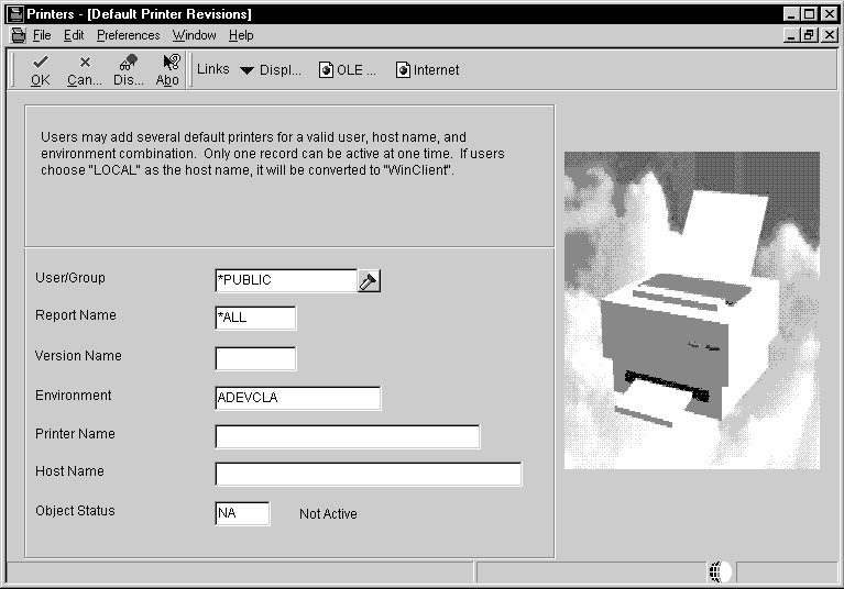

7.4.2 Defining a Default Printer
To define a default printer:
  1. On the Printers menu (GH9013), select the Printers (P98616) program.
  2. On the Printers form, click Define Default Printer.
    The Work With Default Printers form appears.
  3. Click Add.
    Surrounding text describes default_printer_revs.gif.
  4. On Default Printer Revisions, complete these fields and then click OK.
    Field Description
    User\Group Click the visual assist to select either a particular user for this printer or to select an entire group.
    Report Name Click the visual assist to select a specific report to print. Enter *ALL for all reports.
    Version Name Click the visual assist to select a specific report to print. If the value in the Report Name field is *ALL, the system populates the Version Name field with the default value of *ALL and makes the field unavailable for subsequent modification.
    Environment JD Edwards EnterpriseOne provides a default value for this field based on the environment that you are currently logged onto. Enter *ALL for all environments. You can change this information.
    Printer Name Enter the name of your printer.
    Host Name Enter the name of the host server where reports will be processed. The visual assist displays the appropriate host names based on the printer name you select. To use this printer for all hosts in your environment, enter *ALL.
    Object Status Define the new printer as the default printer by changing its status to active. If an error occurs, it means that another printer is currently the active default. Change the original default printer to inactive before making the new printer active. Change multiple statuses from the Work With Default Printers form, as explained at the end of this task.
  5. Click OK, and then click Cancel to access the Work With Default Printers form.
  6. To change the status of a default printer, select a default record and, from the Row menu, select Change Status.
    If another printer is already set as the active default, an error occurs. To change the original default printer to inactive, select it, select Change Status on the Row menu, and then select the new printer as the default.
