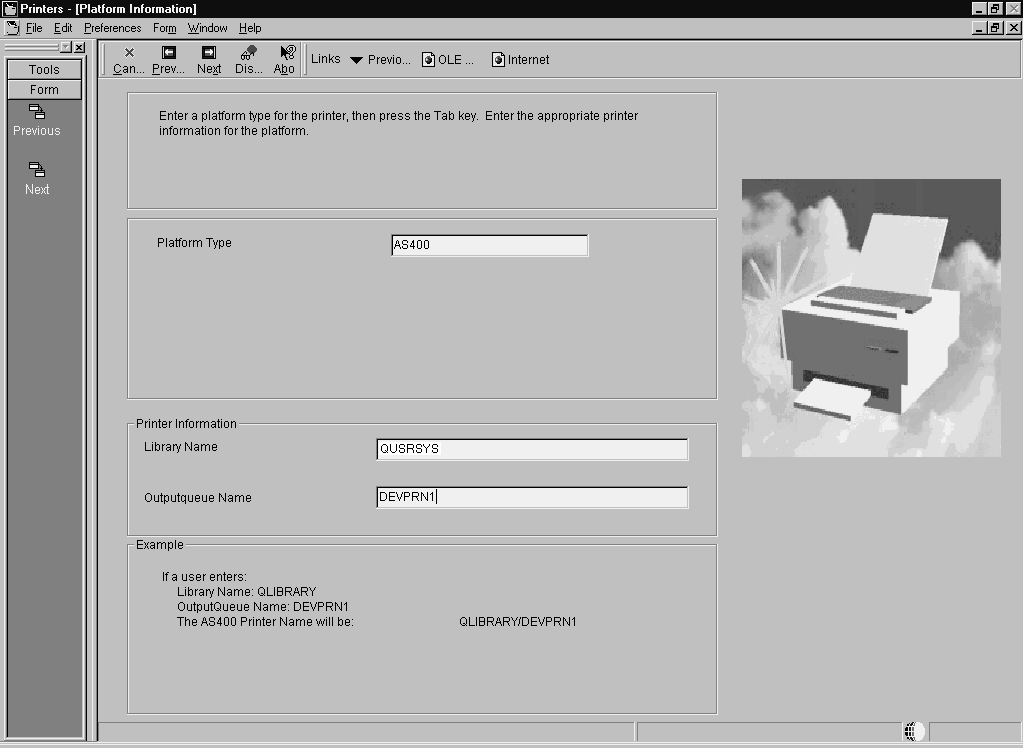

To install your first printer:
On the Printers menu (GH9013), select Printers (P98616).
The Printers form appears.
On the Printers form, click Add Printer.
The welcome page for the Printer Setup director appears. This page describes the tasks that the director helps you perform.
Review the welcome page and click Next.
The Platform Information form appears. The platform type may appear by default, depending on the operating system on which Release 9.1 is running.
On Platform Information, complete these fields:
| Field | Description |
| Platform Type | Enter the platform type on which you are installing or use the visual assist button to select a platform type. |
| Library Name | The physical printer name must be the same as the outqueue name. If you use the default QGPL library to store your outqueues, you need only enter the outqueue name in this field. Valid characters are all alpha (A-z), numeric (0-9), at ( @ ), and underscore ( _ ). |
| Ouputqueue Name | If your outqueues reside in a library other than the default QGPL library, you need to enter the library name and the outqueue name in this field. For example, QUSRSYS\DEVDES3A. Valid characters are all alpha (A-z), numeric (0-9), at ( @ ), and underscore ( _ ). |

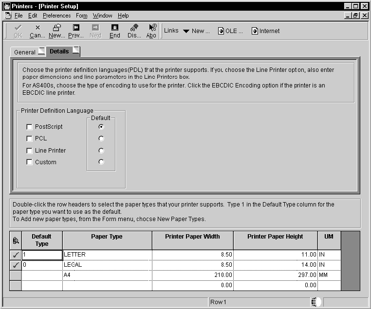

Use this form to set information for the printer such as the printer model, physical location of the printer, printer definition language (PDL), and paper types.
On the General tab, complete these fields:
Printer Model
Printer Location
On the Details tab, in the box labeled Printer Definition Language, select one of these options:
PostScript
PCL
Line Printer
Custom
In the Default box, specify one of the Printer Definition Language options as the default value.
You can select multiple PDLs, but only one default PDL. A user can override this default PDL at the time a batch process is submitted.
Choosing PostScript or Printer Command Language (PCL), Release 9.1 disables the Line Printer option. Choosing Line Printer, Release 9.1 disables the PostScript and PCL options.
When choosing the Line Printer option, this logic occurs:
Release 9.1 disables the grid at the bottom of the form and any paper types you have chosen are cleared.
JD Edwards EnterpriseOne automatically provides a printer type of *JDE LINE PAPER for the printer.
The Fields in the box labeled Line Printers are used to set the paper dimensions and line parameters.
This procedure is explained in later steps in this section.
The custom option uses advanced features of the printers application, which are explained in the later steps in this procedure.
On the Details tab, when choosing the PostScript option, the Paper Source box appears and you can change these options:
| Max Number of Paper Sources | Enter a numeric value in this field to indicate the number of paper trays this printer has available. |
| Default Paper Source | Enter a numeric value in this field to indicate which tray number you want Release 9.1 to draw paper from as the default tray. |
On the Details tab, when choosing the Line Printer option, fields appear in a box labeled Line Printers, which you use to set the paper dimensions and line parameters.
Complete these fields:
| Characters Per Inch | Enter a value to specify the number of characters in one horizontal inch. |
| Columns Per Page | Enter a value to specify the number of characters in one line of text in the specified report. |
| Lines Per Inch | Enter a value to specify the number of lines of text in one vertical inch. |
| Lines Per Page | Enter a value to specify the number of lines of text on one printed page. |
| Printer Paper Width | Displays a value that is calculated automatically based on the values entered in the Line Printers box. |
| Printer Paper Height | Displays a value that is calculated automatically based on the values entered in the Line Printers box. |
On the Details tab, the Custom option lets you specify a conversion filter to use.
When choosing the Custom option, a field appears beneath the Custom checkbox. Enter the name of the conversion filter you want to use or use the visual assist to select a filter from the Conversion Program Search and Select form.
If you do not want to change or add a conversion filter, skip to Step 16 in this task.

The Printer Setup form appears.
In the grid at the bottom of the Printer Setup form, double-click the row header for each paper type that your printer supports. A checkmark appears in the row header for each paper type that you select.
You can add new paper types as necessary. Instructions are included later in this task.In the Default Type column, enter the numeral 1 in the row for the paper type you want to use as the default.
select only one paper type as the default. A user can override the default paper type when a batch process is submitted.
To add a new paper type, continue with these steps:
From the Form menu, select New Paper Type.
The Work With Paper Types form appears.
Click Add.
The Paper Type Revisions form appears.
Paper Type
Paper Height
Paper Width
Unit of Measure
The software saves the new paper type.
Click OK to return to the Work With Paper Types form, and then click Close to return to Printer Setup.
The new paper type is available in the grid on the Printer Setup form. All previous paper type selections are cleared and must be reselected if you want to use them again.
When finished entering information for the printer on the Printer Setup form, click End.
Release 9.1 saves the new printer setting and returns you to the first form in the Printers application.
