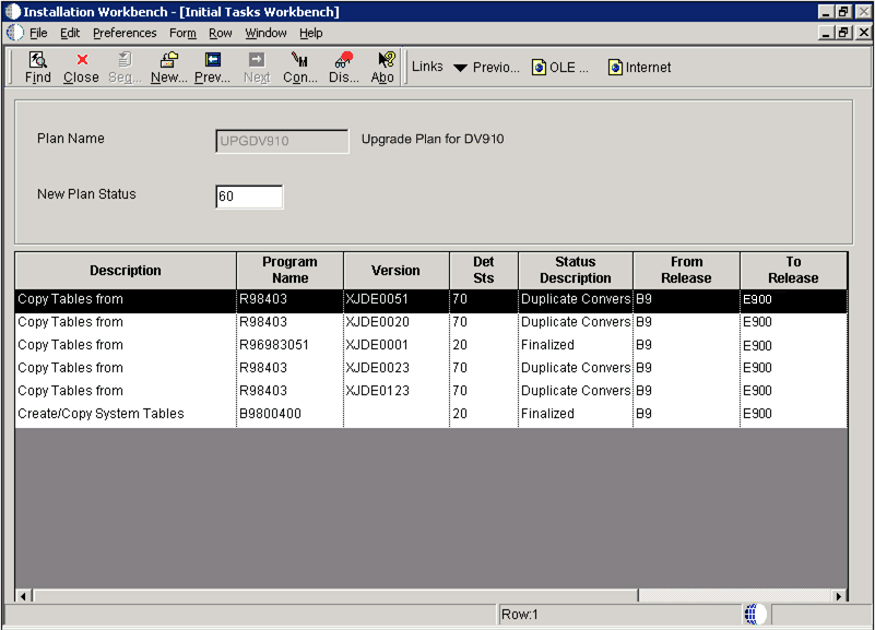

Initial Tasks Workbench When using unattended workbench mode, this workbench runs Release Master after Installation Workbench is started and before Location Workbench begins.

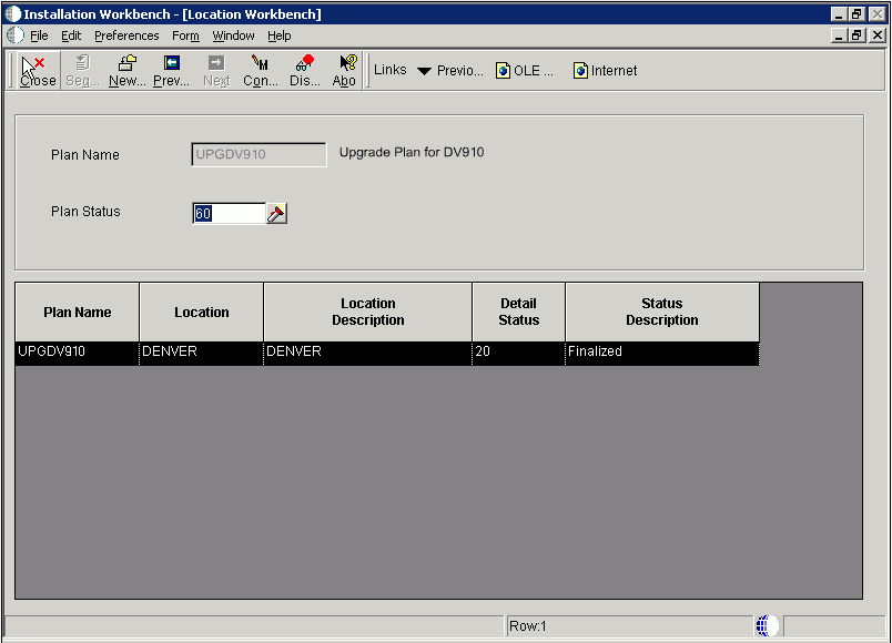

Location Workbench This workbench copies all locations that are defined in the plan from the F9654 and F984021 tables in the Planner data source to the System - 910 data source.

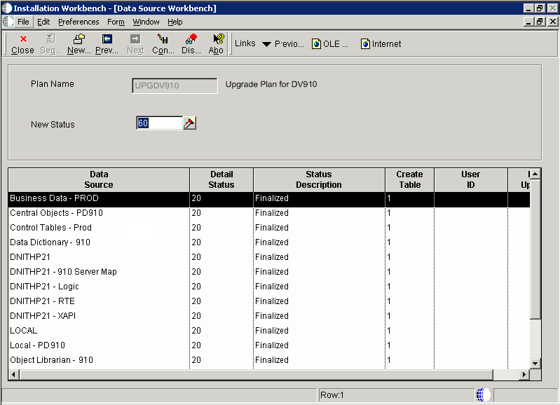

Data Source Workbench Copies all data sources that are defined in the plan from the F98611 and F986115 tables in the Planner data source to your System - 910 data source. It also updates the F98401 table to indicate completion.

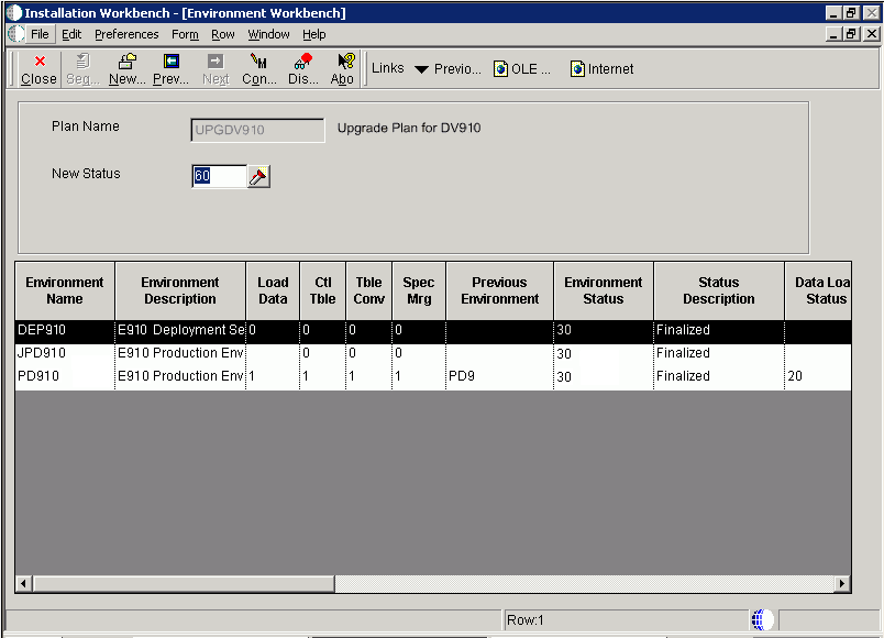

Environment Workbench Copies the F0094, F00941, and F00942 tables, as well as the F986101 table for each environment, from your Planner data source to your System - 910 data source. It then updates the F98403 table to indicate completion. Depending on the plan settings, it also runs a batch application to copy new generic text and to create and populate Object Management Workbench and version tables.

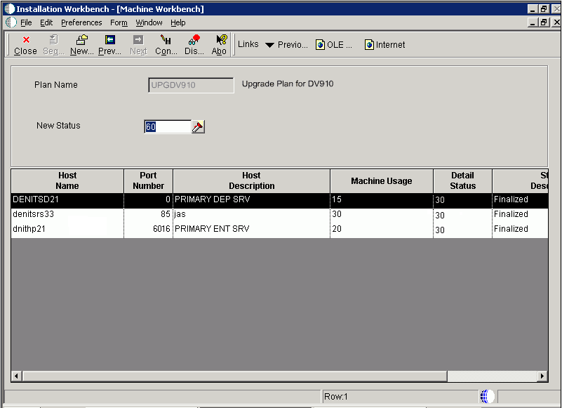

Machine Workbench Copies the F9650 and F9651 tables from the Planner data source to the System - 910 data source. It then updates the F98402 table to indicate completion and uses the environment information to populate the F986101 and F98611 tables in the Server Map data source. Only valid environments, data sources, and server map tables are created.

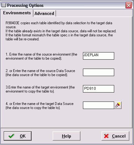

  1. Run R98403E using the XJDE0009 version and set the processing options as follows:
    Surrounding text describes demodata_proc_opts.gif.
  2. On Processing Options 1-4, complete these fields:
    • Option 1
      Enter the name of the source environment, which is the environment of the table to be copied. For example, JDEPLAN.
    • Option 2
      This field must be blank because this UBE is used to copy a mixture of business data and control tables which are specified to environments, not data sources.
    • Option 3
      Enter the name of the target environment, which is the environment to which you wish to copy the table. In this case, you would specify either the Production or Prototype environments. For example, PD910.
    • Option 4
  3. Click OK to continue specifying processing options.
    Surrounding text describes demodata_proc_opts_common.gif.

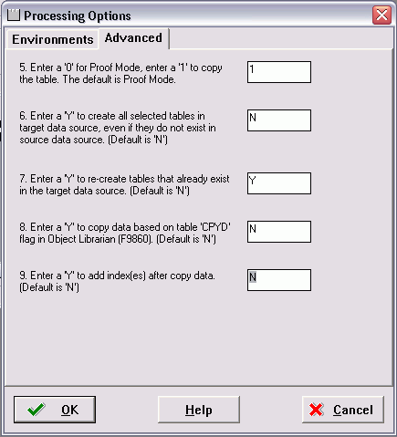

  4. On Processing Options 5-9, complete these fields:
    Field Description
    Option 5 The recommended value is 1, which copies the table.
    The default value is 0, Proof Mode.
    Option 6 The recommended value is N, which copies tables only if they exist in the source.
    Enter Y to copy tables whether or not they exist in the source data source.
    The default value is N.
    Option 7 The recommended value is Y, which recreates tables that already exist in the target data source.
    Note: If you do not recreate the tables, you will end up with a mixture of production and demo data in the tables.
    Option 8 The recommended value is N, which forces a copy of the data, ignoring the CPYD flag.
    Note: A value of Y will leave almost all tables empty. That is, a production data load.
    Option 9 The recommended value is N, which creates the indexes on the tables before copying the data. This prevents duplicate rows.
    Note: A value of Y copies the data and then create the indexes.
  5. Click OK to accept the values and start the UBE.

6.5 Working With Initial Tasks Workbench
Before the workbench is run, the F00945 table in the System data source is blank because it is no longer populated when a plan is validated. However, after you run the Initial Task Workbench several tables in the System data source are populated including the F00945 table.
The Initial Tasks Workbench form lets you complete the Release Master task before the individual workbenches begin.
You use this procedure if you are running Workbench in attended mode or if you set a task break before Initial Tasks Workbench.
6.5.1 Changing the Status of Initial Tasks Workbench
To change the status of Initial Tasks Workbench:
Surrounding text describes initial_tasks_workbench_up.gif.
You might want to change the status of one or more of the initial workbench tasks. To change the status of a task, use the following procedure.
  1. Enter GH961 in the Fast Path field to open the System Installation Tools menu.
  2. Double-click Custom Installation Plan.
  3. On Work with Installation Plans, select your installation plan.
  4. Select Expand on the Row menu.
    The plan components, including the initial tasks, appear.
  5. Select the task whose status you want to change.
  6. On the Row menu, click Disable, Enable, or Complete (see the table below).
    The task status changes.
    • Disable
      Displays a status of 70 to indicate the task is incomplete, and will not be rerun.
    • Enable
      Displays a status of 10 to indicate the task will be rerun.
    • Complete
      Displays a status of 60 to indicate the task is complete, and will not be rerun.
6.6 Configuring Your Locations
Location Workbench copies all locations that are defined in the plan from the F9654 table in the Planner data source to the System - 910 data source. It also updates the F984021 table. Use this procedure when running Workbench in attended mode or if you set a task break before Location Workbench.
Surrounding text describes location_workbench_upgrade.gif.
  1. On Location Workbench, verify that all of your locations are listed.
  2. Select Configure from the Form menu.
    Locations are configured, and the Data Source Workbench form appears.
    The system updates the Detail Status to 60 and changes the Status Description from Validated to Installed.
6.7 Configuring Your Data Sources
Data Source Workbench copies all data sources that are defined in the plan from the F98611 table and the F986115 table in your Planner data source to your System - 910 data source. It also updates the F98401 table to indicate completion. Use this procedure when running Workbench in attended mode or if you set a task break before Data Source Workbench.
  1. On Data Source Workbench, verify that all of your data sources are listed as illustrated in this example.
    Surrounding text describes dsource_workbench_upgrade.gif.
    Your data sources are configured, and the Environment Workbench form appears.
    When the system has configured your data sources, it updates Detail Status to 60 and changes the Status Description from Validated to Installed.
6.8 Configuring Your Environments
Environment Workbench copies the F0094, F00941, and F00942 tables, as well as the F986101 table for each environment, from your Planner data source to your System - 910 data source. It then updates the F98403 table to indicate completion. Depending on the plan settings, it also runs a batch application to copy new generic text and to create and populate Object Management Workbench and version tables.
Environment Workbench can run multiple batch applications simultaneously, which enables Release 9.1 to load multiple environments at the same time. This reduces the amount of time it takes to load environments.
Use this procedure when running Workbench in attended mode or if a task break is set before Environment Workbench.
Surrounding text describes environment_workbench_up.gif.
  1. On Environment Workbench, review each environment and its associated parameters to make sure the values are correct.
  2. After you review the environments, select Configure.
  3. When Environment Workbench has completed, verify that the status of each environment has been updated to 60 and that the status description has changed from Validated to Installed.
  4. Using Adobe Acrobat, review all XJDE reports, and confirm that all configuration statuses indicate Success.
6.9 Using Machine Workbench
Machine Workbench copies the F9650 and F9651 table from the Planner data source to the System - 910 data source. It then updates the F98402 table to indicate completion and uses the environment information to populate the F986101 and F98611 tables in the Server Map data source.
Surrounding text describes machine_workbench_upgrade.gif.
  1. On Machine Workbench, review each server and its associated parameters for the correct values.
    When the system has configured your servers, it changes the detail status to 60, and Status Description changes from Validated to Installed.
