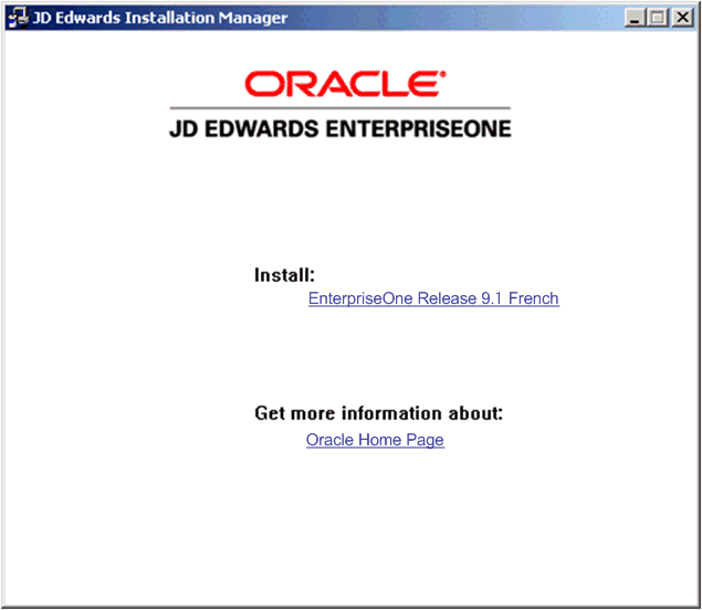

Obtain the JD Edwards EnterpriseOne language and run the setup.exe.
On JD Edwards Installation Manager, click the link for the language that you want to install.
In this example, the language installation image is for French.

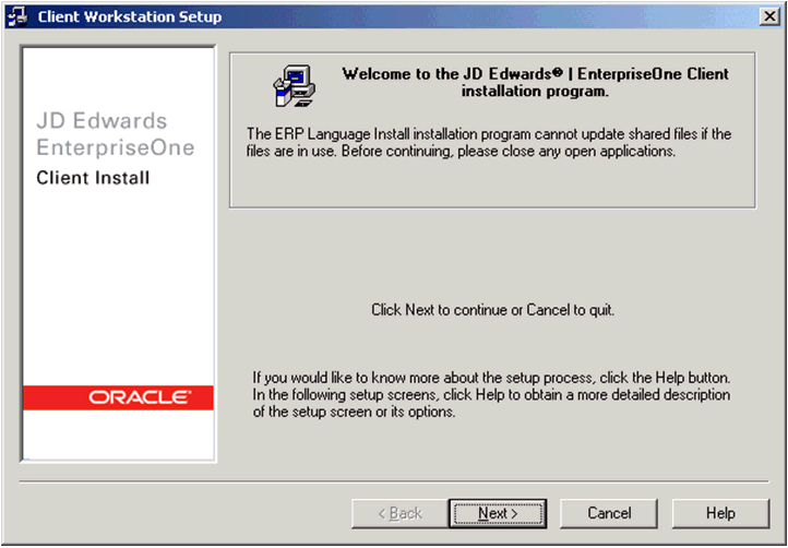

On the Welcome screen, click Next.

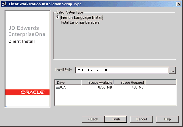

On Client Workstation Installation Setup Type, complete these fields:
| Field | Description |
| Select Setup Type | Ensure the radio button for your language is selected. |
| Install Path | The Installer provides a default path to the existing client installation on this machine:
 You must verify that this drive and path is valid for your installation. You can use the browse function to locate the directory.  |
Click Finish.

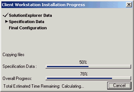

The Client Workstation Install Progress displays the progress of the language installation.

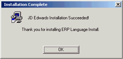

When the installation finishes, the Oracle Deployment Server Setup form indicates whether the installation was successful.
On Installation Complete, click OK.

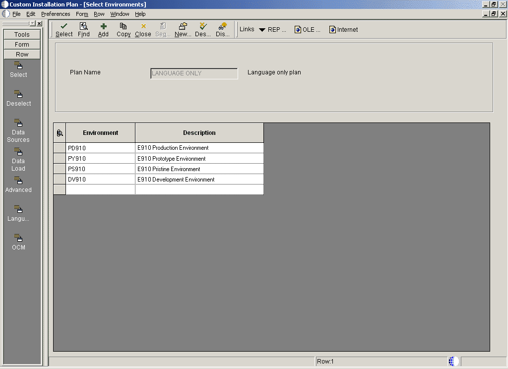

If you choose a custom installation plan, you can choose which language to install for each environment. This section assumes you are defining a custom plan.To enter information into the Installation Planner:

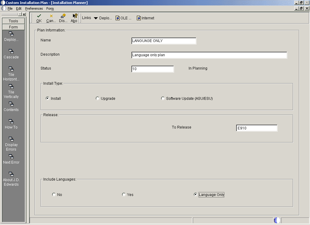

On Installation Planner, enter the basic plan information.
In the Include Language area, select the Language Only option.
To select custom or default parameters:

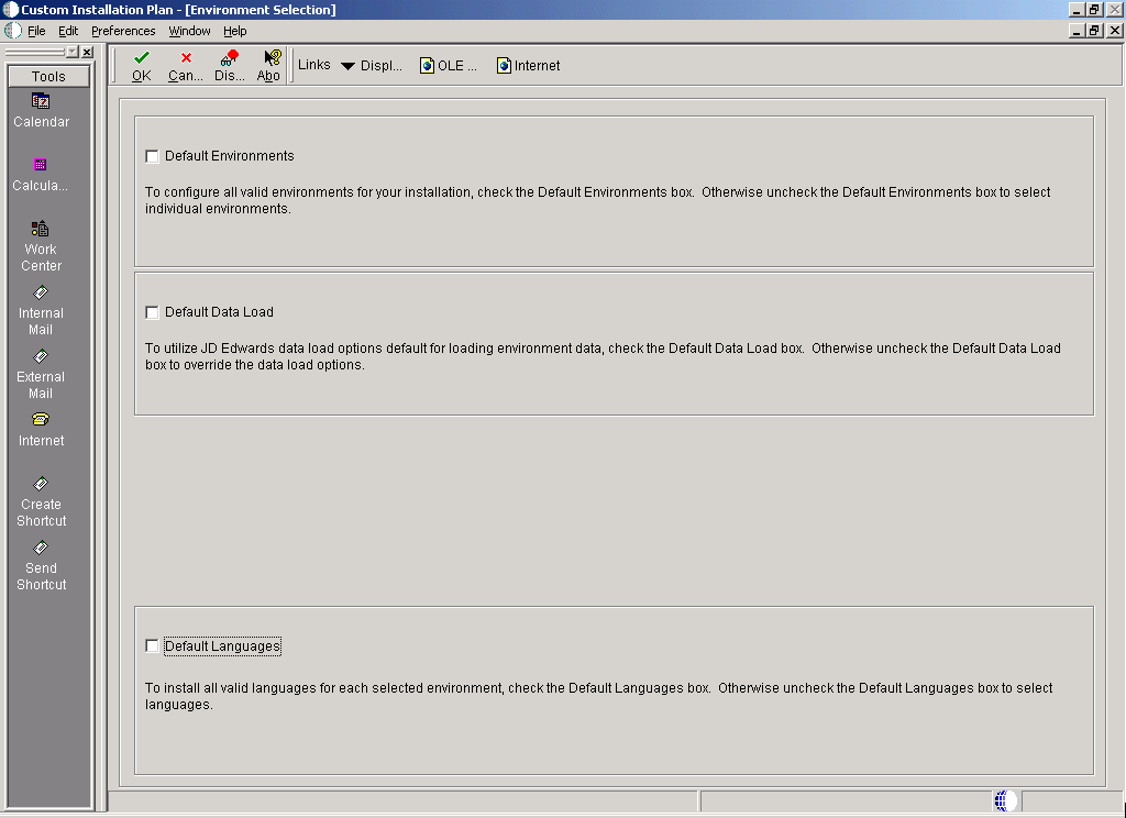

From Environment Selection, all environments and languages are the default values. Clear the options for Default Environment and Default Languages if you want to specify which language or languages to install for each environment.
To select an environment:
Choose the environment for which you wish to install a language.
The Language Selection form appears.
To select a language:
On Language Selection, to set up a language for the selected environment, choose the appropriate language.
From the Row menu, click Select.
Repeat the above steps until all your languages have been selected.
Click OK.
