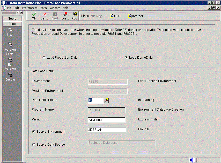

20.11.2 Specifying Environment Data Load Parameters
If you cleared Default Data Load on the Environment Selection form, the Data Load Parameters form appears.
To specify environment data load parameters:
Surrounding text describes data_load_parameters.gif.
The data load radio buttons on this form are no longer applicable as of JD Edwards EnterpriseOne Release 9.1 because data is automatically loaded by the Platform Pack Installer.
For additional details, refer to Section 6.1.2, "Loading Data (Demo Data and Production Data)".
