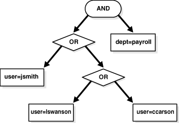

clause, which to do so, you must traverse the filter object. For example, consider the conversion of the following LDAP filter to an SQL WHERE
clause:
(&(|(user=jsmith)(user=lswanson)(user=ccarson))(dept=payroll))
The preceding LDAP filter states All records where the user is jsmith, lswanson or ccarson and whose department is payroll. Figure 18-1 shows a visual representation of this LDAP filter:

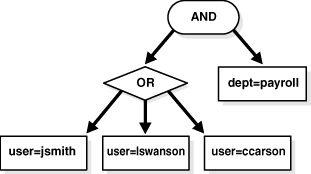

To translate the filter shown in Figure 18-1 into an SQL WHERE

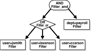

clause, you use a recursive function that traverses the tree. The example filter is represented in Oracle Virtual Directory as a hierarchy of Filter objects, which contain collections of other Filter objects to create a traversable tree. The filter shown in Figure 18-1 will have the object model shown in Figure 18-2, where the name of the class used to represent the filter element is below the operation or operand:
To traverse the tree shown in Figure 18-2, a recursive method is used that queries the getSelector()
method of the filter to determine what type of filter it is. After the type for the filter is determined, its value must be extracted by using a getFilterType
method. For example, if the filter is an equality filter, such as user=jsmith
, the value of the filter object would come from currentFilter.getEqualityMatch()
. In this case the return value is an AttributeValueAssertion
, which stores the attribute name and value as an Oracle. Once retrieved, the values can be converted into String objects. Filter_and
and Filter_or
objects return java.util.Iterator
classes for iterating through the child filters that are being operated on.
LDAP filters do not limit you to two terms per relation. The OR
portion has three operands. Since SQL only allows two operands per operation, the tree in Figure 18-2 must be converted to a binary tree.
In Figure 18-3, the OR
operation is broken up into two separate OR
operations. The final WHERE
clause from the filter is ((user=jsmith) OR ((user=lswanson) OR (user=ccarson))) AND (dept=payroll)
. The LDAP prefix notation has been transformed into a SQL like infix notation with only two operands per operation. Example 18-8 shows the source code for the transformation:
