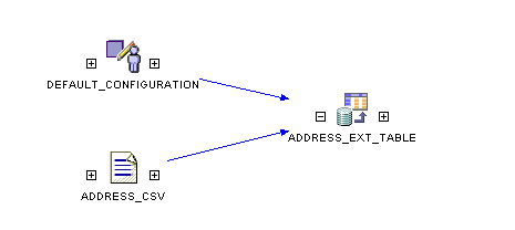

flat_file > external_table > table
Figure 7-1 shows a lineage diagram of an external table named ADDRESS_EXT_TABLE
. ADDRESS_CSV
is a flat file, and it is part of the lineage of ADDRESS_EXT_TABLE
. Thus, any change to ADDRESS_CSV
will impact ADDRESS_EXT_TABLE
Figure 7-1 Lineage Analysis Diagram for ADDRESS_EXT_TABLE

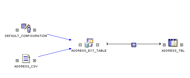

Figure 7-2 shows an impact diagram of ADDRESS_EXT_TABLE
, which includes the ADDRESS_TBL
. Any change to ADDRESS_EXT_TABLE
will impact ADDRESS_TBL
. ADDRESS_EXT_TABLE
is part of the lineage of ADDRESS_TBL
Figure 7-2 Impact Analysis Diagram for ADDRESS_EXT_TABLE

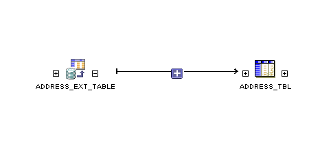

You can see both the lineage and the impact of an object by clicking the plus signs (+) on either side of the object icon, as shown in Figure 7-3.
Figure 7-3 Lineage and Impact Analysis Diagram
