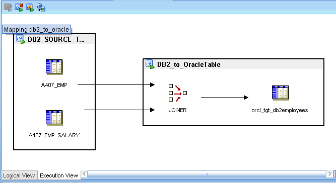

For mappings under a code template mapping, Oracle Warehouse Builder provides two different views to work with, Logical View and Execution View.
In the logical view, you can insert the various components of the mapping. This includes the source and target operators (tables), as well as the transformation operators. You can also define the data flow from the source to the target, along with the transformation operators that define how the data is transformed before it is loaded into the target.
In the execution view, you must define execution units for the components within the mapping. An execution unit is a module that holds the various mapping operators.
For example, if your mapping has a DB2 source table, an expression operator, and an Oracle target table, then you can bind the source table to an execution unit DB2_SOURCE_TABLE
, and the expression and the target table to another execution unit DB2_to_OracleTable
, as shown in Figure 12-1.
