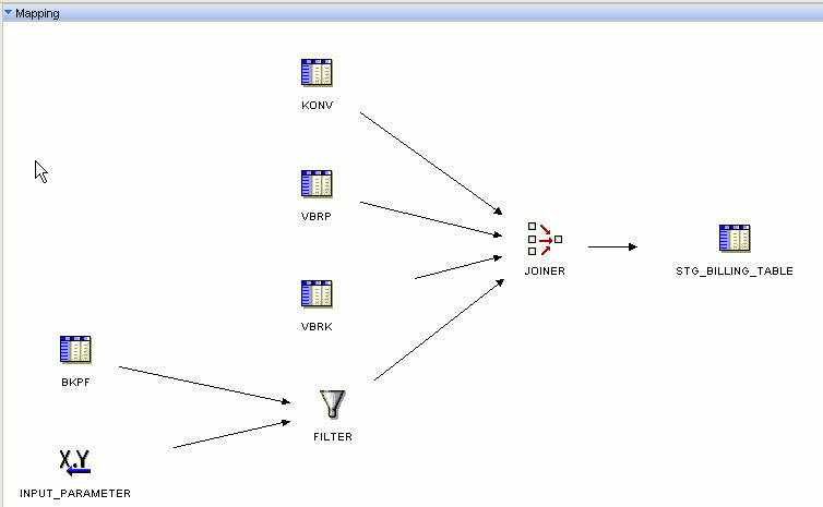

Use the Mapping Editor to create a mapping containing SAP tables. Creating a mapping with SAP tables is similar to creating mappings with other database objects. However, there are restrictions on the operators that can be used in the mapping. You can only use Table, Filter, Joiner, and Mapping Input Parameter mapping operators in a mapping containing SAP tables.
A typical SAP extraction mapping consists of one or more SAP source tables (transparent, cluster, or pooled), one or more Filter or Joiner operators, and a non-SAP target table (typically an Oracle Database table) to store the retrieved data.
You cannot have both SAP and non-SAP (Oracle Database) source tables in a mapping. However, you can use an Oracle Database table as a staging table.Figure 7-1 displays a mapping that extracts data from an SAP source.
In this example, the Input Parameter holds a Date value, and the data from table BKPF is filtered based on this date. The Joiner operator enables you to join data from multiple tables, and the combined data set is stored in a staging table.

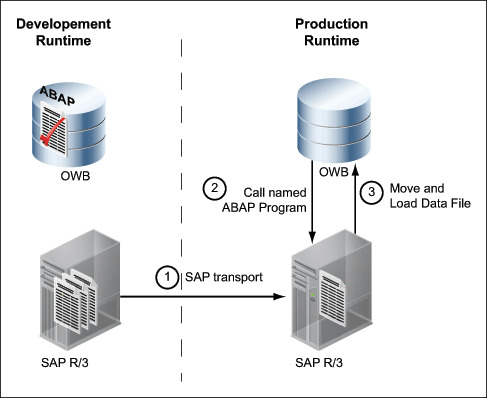

In a semiautomated system, as a Oracle Warehouse Builder user, you do not have access to the predefined function module, and therefore cannot use this function module to execute ABAP code. You create an extraction mapping, deploy it, and then send the ABAP code to the SAP administrator who verifies the code before allowing you to run it in the SAP system.
Figure 7-3 displays a diagrammatic representation of a semi automated system.
A semiautomated system works as follows:
You design the extraction mapping and generate the ABAP code for this mapping.
You then transport the ABAP code to the test system to test the code.
You then send the ABAP code to the SAP administrator, who loads it to the SAP repository.
The SAP administrator creates a new ABAP report name.
You can then call this ABAP report name to execute the ABAP code in the production environment.
Before you run the mapping in the SAP system, ensure that you have set the following configuration parameters for the mapping:
ABAP Report Name: The SAP administrator will provide the report name after verifying the ABAP code. You will then execute this ABAP file.

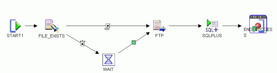

On Oracle Warehouse Builder end, you can create a Process Flow to retrieve the data file. The process flow must contain the following activities.
A File Exists activity to check for the presence of the data file.
If the file exists, then an FTP activity transfers the file to Oracle Warehouse Builder system.
If the file does not exist, then it must wait till the file is made available, and then perform an FTP.
Using SQL*Loader, the target table is loaded with data from the data file.
Figure 7-4 displays the process flow that retrieves the data file.
Figure 7-4 Process Flow to Retrieve SAP Data

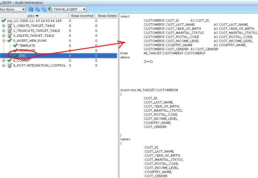

The Audit Information panel enables you to view additional details about the CT mapping execution. You can also view results for previous executions of the CT mapping. To display the Audit Information panel, from the View menu, select Audit Information.
Expand the location node to which the CT mapping is deployed to view the jobs for this CT mapping. Because you can execute a CT mapping multiple times, each execution is represented by a job. Each job contains a node for execution units, which in turn contains a node for steps. Details such as number of rows inserted, updated, deleted, and selected are displayed. Use the Execute Statement tab to view the statement used to execute a step.
During the execution of a CT mapping or Change Data Capture process, the Audit Information panel displays the job and its child nodes, such as Execution Units (for CT mapping only), Tasks, and Steps, as they are being executed. The status for each job is also displayed. You can filter tasks for a Job in the Audit Information panel based on the status (such as Skipped, Warnings, and so on). The default is set to Filter None, which means that no filtering is performed. You can also sort Jobs by Timestamps.
Use the Message tab to view any message during the execution of the steps, such as an exception from the JDBC driver during the execution of a JDBC task.

The Audit Information panel in the Design Center provides detailed information about each task that was executed as part of a CT mapping execution. You can use this information to audit errors caused during the execution of CT mappings.
However, for the Audit Information panel to display execution details, you must set certain properties as described in "Prerequisites for Auditing Code Template Mappings".
Figure 7-5 displays the Audit Information panel for a CT mapping execution.
Figure 7-5 Audit Information Panel with Details about Executed Tasks
The Audit Information panel displays the individual steps that are executed as part of the CT mapping execution. The details displayed for each step include the name of the task, the number of rows inserted, updated, or deleted for the task, and its status.
Detailed information about the steps within the CT mapping is displayed. For each step, you can see error messages, if any. You can also view the statements executed for each task. Expand the node representing each task to view details of the task execution.
Not all tasks are listed in the Audit Information panel. If the settings of a task exclude it from the audit, then the task is not displayed. For more information about including a code template task in audits, see "Prerequisites for Auditing Code Template Mappings".
For example, in the Audit Information panel displayed in Figure 7-5, the CT mapping contains the following tasks: CREATE_TARGET_TABLE, TRUNCATE_TARGET_TABLE, DELETE_TARGET_TABLE, INSERT_NEW_ROWS, COMMIT, and POST_INTEGRATION_CONTROL. The statements executed as part of the INSERT_NEW_ROWS task are displayed in the panel on the right. Notice that task 4 is not listed in the Audit Information panel. This is because the settings of this task exclude it from the audit.
For Oracle Warehouse Builder to provide detailed information about the execution of a CT mapping, you must set the following properties:
Log Audit Level
Every task in a code template contains a property called Log Audit Level. You can set a value between 0 and 5 for this property. Setting a value of 0 means that the details of this task are not included in the audit. Set this property to a value between 1 and 5 to include the details for this task execution in the audit log.
Log Level
Every execution unit in a CT mapping contains a property called Log Level. This property represents the level of logging performed for the execution unit. You can set a value between 0 and 5 for this property. Set a value of 0 to exclude this execution unit from being logged. Set this property to a value between 1 and 5 to specify the level of detail used to log the execution of this execution unit.
In the Projects Navigator, select the CT mapping whose execution must be audited.
From the View menu, select Audit Information.
The Audit Information panel is displayed in the Log window.
Expand the node that represents the CT mapping execution job.
Separate nodes are displayed for each task in the CT mapping that is included in the audit.
Expand a task node to view the list of steps performed as part of this task.
To view the statements executed as part of a particular step, select the step and then select Executed Statement.
The statements executed are displayed on the right.

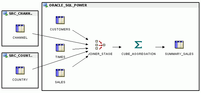

Create a CT mapping to contain the required ETL logic for extracting, transforming, and loading data.
In this example, create a mapping called LOAD_SUMMARY_SALES_MAP.
Drag and drop the source tables onto the Mapping Editor canvas.
In this example, drag and drop the CHANNEL and COUNTRY tables from the XML source module and the CUSTOMERS, TIMES, and SALES tables from the Oracle module.
Drag and drop the operators that you must use to perform the required data transformation. Connect the operator attributes.
In this example, you add the following operators:
A Joiner operator to join the data in the source tables. Set the Join Condition property for the Joiner operator to define how the source tables should be joined. In this example, you use the columns that are common between a pair of tables to join data from those tables.
An Aggregator operator to aggregate the output of the Joiner operator. Data is aggregated based on the CHANNEL_DESC and COUNTRY_ISO_CODE attributes and the SQL function CUBE is leveraged to perform aggregation.
Thus, in the Group by clause of the Aggregator operator, specify the following:
CUBE(INGRP1.CHANNEL_DESC,INGRP1.COUNTRY_ISO_CODE)
Drag and drop the target table onto the canvas.
In this example, drag and drop the SUMMARY_SALES table onto the canvas.
Create the data flows between the source and transformation operators. Map the transformed output to the target table.
In this example, the tables CHANNEL, CUSTOMERS, COUNTRY, TIMES, and SALES are mapped to the Input groups of the Joiner operator. The Output group of the Joiner operator is mapped to the Aggregator operator. The output of the Aggregator operator is mapped to the target table SUMMARY_SALES.
In the Execution View of the CT mapping, create the execution units required to perform the data transformation.
Your CT mapping should look like the one in Figure 7-6.
In this example, perform the following:
Create an execution unit for the CHANNEL table. Associate this execution unit with the LCT_SQL_TO_SQL code template.
Create an execution unit for the COUNTRY table. Associate this execution unit with the LCT_SQL_TO_SQL code template.
Create an execution unit containing the tables CUSTOMERS, SALES, and TIMES, the Joiner operator, the Aggregator operator, and the SUMMARY_SALES table. Associate this execution unit with the Oracle Target CT DEFAULT_ORACLE_TARGET_CT.
Validate and generate the CT mapping. In the Projects Navigator, right-click the CT mapping and select Generate.
Deploy the CT mapping. In the Projects Navigator, right-click the CT mapping and select Deploy.
Execute the CT mapping to extract data from the XML and Oracle source, transform it, and load it into the Oracle target table. In the Projects Navigator, right-click the CT mapping and select Start.
Figure 7-6 displays the Execution View of the CT mapping that enables you to perform the required data transformation using Oracle Target CTs.
Figure 7-6 Mapping That Uses Oracle Target CTs to Transform Source Data

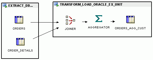

Create a mapping to contain the required ETL logic for extracting, transforming, and loading data.
In this example, create a mapping called LOAD_DB2_TO_ORACLE_MAP.
Drag and drop the source tables from the DB2 source module onto the Mapping Editor canvas.
In this example, drag and drop the ORDERS and ORDER_DETAILS tables from the DB2 module source module.
A Joiner operator to join the data in the ORDERS and ORDER_DETAILS tables. Set the Join Condition property for the Joiner operator.
An Aggregator operator to aggregate the output of the Joiner operator. Aggregate the data based on the CUSTOMER_ID attribute.
In this example, drag and drop the ORDERS_TGT operator onto the canvas.
In the Execution View of the mapping, perform the following:
Create an execution unit for the ORDERS and ORDER_DETAILS operators. Associate this execution unit with the LCT_SQL_TO_ORACLE code template.
Create an execution unit containing the Joiner, Aggregator, and ORDERS_AGG_CUST table. Associate this execution unit with the ICT_ORACLE_INCR_UPD code template.
Execute the CT mapping to extract data from the source DB2 tables, transform it, and load it into the Oracle target table. In the Projects Navigator, right-click the CT mapping and select Start.
Figure 7-7 displays the Execution View of the mapping LOAD_DB2_TO_ORACLE_MAP.
Figure 7-7 Mapping to Extract Data from IBM DB2, Transform Data, and Load it into Oracle Database
