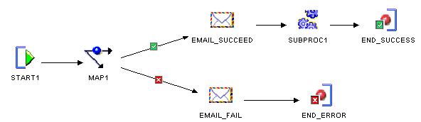

A process flow describes dependencies between Oracle Warehouse Builder mappings and external activities such as e-mail, FTP, and operating system commands. Use process flows to sequence individual steps in the ETL process. The individual steps often include mappings, but can also include manual activities or external activities such as FTP or e-mail.
Each process flow begins with a Start activity and concludes with an End activity for each stream in the flow. A process flow is considered as a type of activity, so a process flow can start other process flows.
Figure 8-1 shows an example of a process flow that starts a mapping (MAP1). If the mapping completes successfully, then Oracle Warehouse Builder sends an e-mail notification (EMAIL_SUCCEED) and starts another process flow (SUBPROC1). If the mapping fails, then Oracle Warehouse Builder sends an email (EMAIL_FAIL) and ends the process flow.
Figure 8-1 Sample Process Flow
This illustration is described in the surrounding text.
Description of "Figure 8-1 Sample Process Flow"
When you design a process flow in Oracle Warehouse Builder, you use an interface known as the Process Flow Editor. Alternatively, you can create and define process flows using Oracle Warehouse Builder scripting language, OMB*Plus, as described in Oracle Warehouse Builder API and Scripting Reference.
About Process Flow Modules and Packages
Process flows must be grouped into process flow packages, which in turn are grouped in process flow modules. The process flow modules and packages provide two levels to manage and deploy process flows. You can validate, generate, and deploy process flows at either the module or the package level.

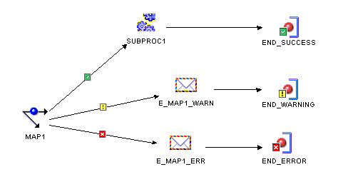

You can design a process flow that starts other process flows as long as they are in the same module. You can copy process flows from one package to another package in the same or a different module, and you can copy packages to a different module. To do so, use the Copy and Paste commands available under Edit on the Design Center main menu.
For example, Figure 8-1 shows a process flow PROC1 that includes process flow SUBPROC1. For PROC1 to run successfully, SUBPROC1 and PROC1 can be in the same or separate process flow modules, but they must be deployed to the same location.

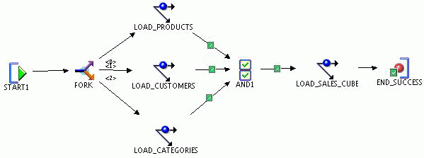

The cube SALES_CUBE is loaded using data in the PRODUCTS, CATEGORIES, and CUSTOMERS dimensions. These dimensions, in turn, are loaded using one or more transaction tables. Data must be loaded into the cube only if all the dimensions are loaded successfully.
You create separate mappings to load the cube and dimensions. However, you want a sequential flow in which the three dimensions PRODUCTS, CATEGORIES, and CUSTOMERS are loaded first and, if these dimensions are loaded successfully, the cube SALES_CUBE is loaded. Use a process flow to link these mappings and create a sequential flow.
Figure 8-2 displays the process flow that loads the SALES_CUBE. This process flow is created after you complete the steps listed in "Steps to Define the Process Flow".
Figure 8-2 Process Flow that Loads a Cube
Description of Figure 8-2 follows
Description of "Figure 8-2 Process Flow that Loads a Cube"
Before You Begin
Create the following mappings:
  1. Create a Oracle Workflow location to which the process flow will be deployed.
    See "Creating Oracle Workflow Locations" for information about creating Oracle Workflow locations.
  2. In the Projects Navigator, expand the project node under which you want to create the process flow and then expand the Process Flows node.
  3. Right-click the Process Flow Modules node and select New Process Flow Module.
    The Create Process Flow Module wizard is displayed.
  4. On the Name and Description page, provide a name and an optional description for the process flow.
  5. On the Connection Information page, in the Location field, select the location created in step 1. Click Finish to create the process flow module.
    The Create Process Flow Package dialog box is displayed.
  6. Enter a name and an optional description for the process flow package and click OK.
    The Create Process Flow dialog box is displayed.
  7. Enter the name and an optional description for the process flow and click OK.
    The Process Flow Editor is displayed. The editor canvas contains the Start activity named START1 and a Stop activity called End_success. Use the editor to add other activities that are part of your process flow and to define relationships between them.
  8. From the Component Palette, drag a Fork activity and drop it on to the editor canvas.
  9. From the Projects Navigator, drag the following mappings and drop them on to the editor canvas: LOAD_PRODUCTS, LOAD_CATEGORIES, and LOAD_CUSTOMERS.
    When you drag a mapping and drop it onto the canvas, the mapping activity is displayed on the canvas with a default name such as MAPPING_n. The activity name highlighted in blue so that you can change the name, if required. For each activity, enter the same name as the mapping. For example, for the LOAD_PRODUCTS mapping, enter the name of the activity as LOAD_PRODUCTS.
    Position these activities in a vertical line, one below the other, to the right of the Fork activity.
  10. Create the following transitions:
    • From the Fork activity to the LOAD_PRODUCTS activity
    • From the Fork activity to the LOAD_CATEGORIES activity
    • From the Fork activity to the LOAD_CUSTOMERS activity
    To create a transition, select the source activity. The cursor is displayed as a small horizontal arrow on the activity. Drag and drop on the target activity.
  11. From the Component Palette, drag and drop an AND activity on to the editor.
  12. Define a conditional transition, with the condition defined as SUCCESS, from the LOAD_PRODUCTS activity to the And activity.
    A conditional transition is one that is based on a predefined condition. To define a condition for the transition:
    1. On the editor canvas, select the transition.
      The Property Inspector displays the properties of the selected transition.
    2. Click the Ellipsis button on the Condition property.
      The Edit Property dialog box is displayed.
    3. Select Enumerated Condition. In the list below this option, select Success and click OK.
  13. Define a conditional transition, with the condition defined as SUCCESS, from the LOAD_CATEGORIES activity to the And activity.
  14. Define a conditional transition, with the condition defined as SUCCESS, from the LOAD_CUSTOMERS activity to the And activity.
  15. From the Projects Navigator, drag and drop the mapping LOAD_SALES_CUBE onto the editor canvas. Enter the name of the activity as LOAD_SALES_CUBE.
  16. Create a transition from the AND activity to the LOAD_SALES_CUBE activity. Select the AND activity to display a small horizontal arrow. Drag and drop on to the LOAD_SALES_CUBE activity.
  17. Create a conditional transition, with the condition defined as SUCCESS, from the LOAD_SALES_CUBE activity to the End_success activity.

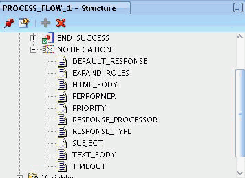

  5. In the Property Inspector, add parameters for the activity by clicking New Process Activity Parameter at the top of the Structure panel.
    The parameters for an activity vary according to the type of activity. For each activity, Oracle Warehouse Builder defines read-only parameters Name, Direction, and Data Type. And for each parameter, you can specify values for Binding, Literal, Value, and Description in the Property Inspector.
    For example, Figure 8-3 shows the parameters for a Notification activity. The parameters include DEFAULT_RESPONSE, EXPAND_ROLES, HTML_BODY, PERFORMER, PRIORITY, RESPONSE_PROCESSOR, RESPONSE_TYPE, SUBJECT, TEXT_BODY, and TIMEOUT.
    Figure 8-3 Parameters for a Notification Activity
    Description of Figure 8-3 follows
    Description of "Figure 8-3 Parameters for a Notification Activity"

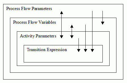

Figure 8-4 shows the direction in which the data is passed.
Figure 8-4 Relationship Between the Scope and the Direction in Which the Data is Passed
Description of Figure 8-4 follows
Description of "Figure 8-4 Relationship Between the Scope and the Direction in Which the Data is Passed"
Process flows adhere to the following rules for allowing the data to be passed between data stores:
  1. Process flow variables can be initialized from process flow parameters, but the reverse is not allowed.
  2. Activity parameters can pass data bidirectionally between process flow variables and process flow parameters.
  3. Transition expressions can be evaluated against their source activity parameters, process flow parameters, and process flow variables.
  4. A data store cannot be accessed from another data store within the same scope.

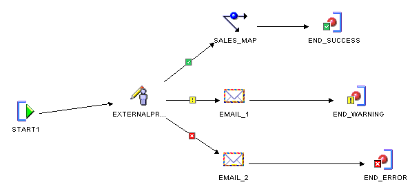

Create a process flow that starts a mapping on the condition that the User Defined activity completes successfully. For more information about creating the process flow, see "Steps for Defining Process Flows".
Figure 8-6 displays the process flow you create to extract data from a generated flat file.
Figure 8-6 Process Flow with User Defined Activity Transitioning to a Mapping
Description of Figure 8-6 follows
Description of "Figure 8-6 Process Flow with User Defined Activity Transitioning to a Mapping"

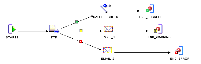

Creating the Process Flow
Use the Process Flow Editor to create a process flow with an FTP activity that transitions to the salesresults mapping on the condition of success.
Your process flow should appear similar to Figure 8-7.

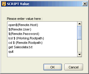

  5. Click the Ellipsis button to the right of the Value field displayed in the Property Inspector.
    Oracle Warehouse Builder displays the SCRIPT Value editor. Write or copy and paste FTP commands into the editor.
    Notice that the script in Figure 8-8 includes ${Remote.User} and ${Remote.Password}. These are substitution variables. See "Using Substitution Variables" for more details.
    Figure 8-8 SCRIPT Value Editor Using Substitution Variables
    Description of Figure 8-8 follows
    Description of "Figure 8-8 SCRIPT Value Editor Using Substitution Variables"
