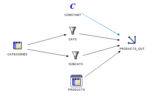

Figure 6-1 displays a mapping that loads data into the PRODUCTS
dimension, represented by the operator PRODUCTS_OUT
. The source data is stored in two tables, CATEGORIES
and PRODUCTS
. The CATEGORIES
table stores both the category and subcategory information. So the data from this table is filtered using two Filter operators CATS
and SUBCATS
. The filtered data is then mapped to the CATEGORIES
level and the SUBCATEGORIES
dimension levels. The TOTAL
level of the dimension is loaded using a Constant operator. The data from the PRODUCTS
table is mapped directly to the PRODUCTS
level in the dimension.

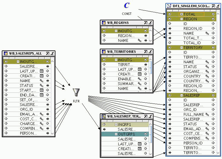

The DF1_SINGLEH1_SCD1 is a dimension containing the levels Total, Region, Territory, and Salesrep. This dimension contains existing data that was loaded earlier using another mapping. The tables WBSALESREP_ALL, WB_REGIONS, WB_TERRITORIES, and WBSALESREPTERRITORIES contain the data that must be removed from the various levels in the dimension.
Use the following steps to remove data from the DF1_SINGLEH1_SCD1 dimension.
Define a mapping as described in "Defining Mappings".
From the Projects Navigator, drag and drop the DF1_SINGLEH1_SCD1 dimension onto the mapping canvas.
Set the Loading Type property of the Dimension operator to Remove.
From the Projects Navigator, drag and drop the following tables onto the mapping canvas: WBSALESREP_ALL, WB_REGIONS, WB_TERRITORIES, and WBSALESREPTERRITORIES.
Add a Constant operator to the mapping. Create two output attributes ID and Name. To the Expression property of both attributes, assign the values to remove from the Total level.
For example, if you set the Expression attribute of ID to 100 and that of Name to Asia, then all level records, in the Total level, whose ID and Name match these values are deleted. Also, because the ID attribute of the Constant operator is mapped to the Region attribute, all child records of the Total level records that are removed are also removed.
Map the attributes from the source operators to the Dimension operator.
Figure 6-5 displays the mapping with the attributes connected to the Dimension operator.
Figure 6-5 Mapping that Removes Data From a Dimension
The business identifier of the source records is compared to the business identifier of the dimension level record to which it is mapped. If the business identifier matches, then the corresponding record is removed from the dimension.
