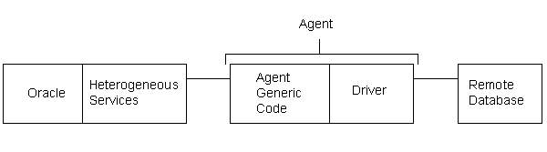

Figure 1-1 describes how Oracle Database uses Heterogeneous services to access a remote non-Oracle source.
Figure 1-1 Heterogeneous Services Architecture
Description of Figure 1-1 follows
Description of "Figure 1-1 Heterogeneous Services Architecture"
The Heterogeneous Services component in the database communicates with the Heterogeneous Services agent process. The agent process, in turn, communicates with the remote database.
The agent process consists of agent-generic code and a system-specific driver. All agents contain the same agent-generic code. But each agent has a different driver depending on the type of data being sourced.
