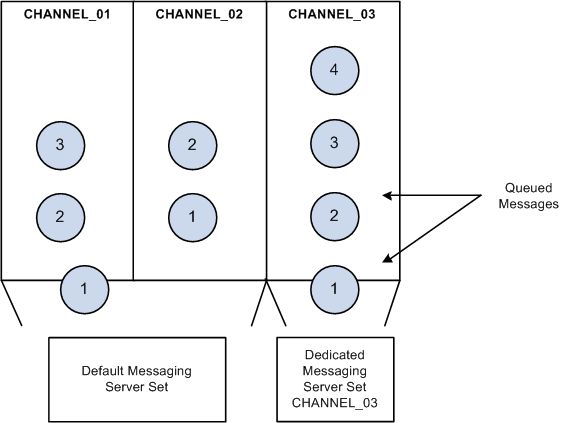

When you create a new messaging server, you assign it to a particular queue using PSADMIN. If a given queue is the most active and creates performance bottlenecks, you can dedicate several messaging servers to that queue to cope with the message volume. A messaging server is capable of handling multiple message queues.
The following illustration depicts a dedicated messaging server set assigned to QUEUE_03:
Dedicated messaging server set
In this scenario, the default messaging server set (_dflt process collection) continues to process the messages in the other message queues while the dedicated messaging server set processes only the messages within a specified queue. Unless you create and configure dedicated messaging servers, the default messaging server set handles all incoming messages. Remember that a messaging server set is a collection of six messaging server processes.
Note. Before you can assign messaging servers to message queues, you must first define the message queues using PeopleSoft Application Designer.
