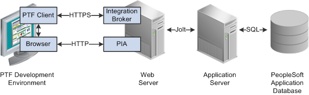

Understanding the PTF Development EnvironmentThe following diagram illustrates the PeopleSoft Test Framework (PTF) development environment:
Diagram of the PTF development environment
A PTF development environment consists of the following elements:
A PTF client instance.
A connection to a PeopleSoft application database where test assets are stored.
A Microsoft Internet Explorer browser instance.
A connection to a PeopleSoft application that is to be tested.
The PTF client is a standalone program that runs on a Microsoft Windows workstation.
The PTF client connects to the PeopleSoft application database where test assets are stored using a secure HTTPS connection through Integration Broker Web Services.
The PTF client connects to the PeopleSoft application that is to be tested through a Microsoft Internet Explorer browser session. The browser connects to the PeopleSoft application using HTTP through the PeopleSoft Pure Internet Architecture (PIA).
Note. The PeopleSoft application database where test assets are stored and the PeopleSoft application that is to be tested are not required to be on the same database, but we strongly recommend you use the same database for both.

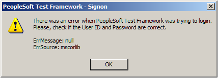

Note. The Default User ID for the ANONYMOUS node must have, as a minimum, a PTF User role.
If PTF security is not configured properly ou may receive the following error when signing on the the PTF client:
Signon error message
Possible causes and solutions for this error are:
The user ID for the ANONYMOUS node does not have PTF privileges. Add at least the PTF User role to the user profile.
The user ID you entered in the User field in the Environment Login does not have PTF privileges. Add at least the PTF User role to the user profile.

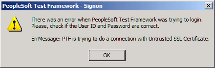

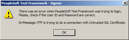

If you receive the following error message, select the Allow Unstrusted SSL checkbox if you want to enable PTF to connect without a trusted SSL certificate:
Error Message: PTF is trying to do a connection with Untrusted SSL Certificate.

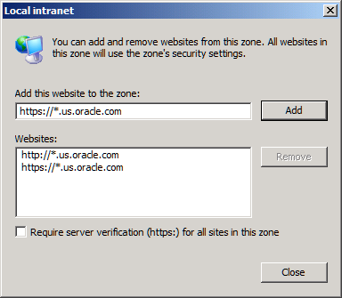

Configuring the Browser Security Settings
You must configure the client browser Security settings to accept the test application URL.
If browser security settings are not properly configured you may encounter problems with PTF test playback.
To configure the browser security settings:
In Microsoft Internet Explorer, select Tools, Internet Options.
In the Internet Options dialog box, access the Security tab.
Click the Local intranet button.
Click the Sites button.
Click the Advanced button.
In the Add this website to the zone field, enter the domains for the test applications.
Add entries for both http and https.
For example:
http://*.<domain_name> https://*.<domain_name>
Determine the domain name based on the URL for the test application. For example, if the URL is:
http://rtdc79614vmc.us.oracle.com:80/PTTRN/signon.html
then the domain name is us.oracle.com
Click the Add button.
Click the Close button.
Click the OK button to close each open dialog box.
This example shows the Local intranet dialog box:
Microsoft Internet Explorer Local intranet dialog box

You will receive the following signon error if PTF security has not been configured correctly:
The user ID and password you entered are not valid for the PeopleSoft application corresponding to the entry in the Server:Port field.

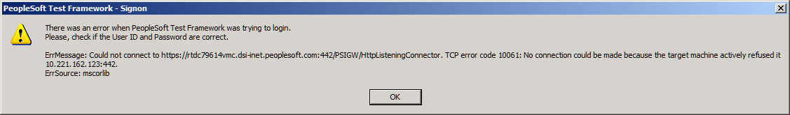

You will receive the following error message if you specified the wrong HTTPS port in the environment login URL:
Wrong HTTPS error message
The default port is 443. If a different port was specified during installation, you will need to contact your system administrator to determine the correct port number.
If you receive the following error message, select Allow Untrusted SSL on the Configuration Options page.
Untrusted SSL Certificate error message
See Defining PTF Configuration Options.
