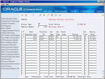

You enter information about multiple jobs for an employee who holds more than one job or position. For example, you might employ an individual whose primary job is an English teacher and whose secondary job is a basketball coach.
You define occupational pay rates for employees who perform various jobs and have different hourly rates for each job.
When you enter multiple job information, you have the ability to link the information to position control. Entering multiple job information also offers more flexibility than defining occupational pay rates. When you enter multiple job information, you can enter start and stop dates for each job. When you define occupational pay rates, you can enter only one start and stop date that applies to all jobs.
From Canadian Payroll Master (G77), choose Employee Information
From Employee Information (G7711), choose Employee Multiple Job Entry
For employees who have more than one job or position within your organization, you can enter multiple job information. Entering multiple job information allows you to:
Track separate job and pay information for each job.
Define job start and stop dates for each position.
Avoid entering timecards for an hourly employee by entering a standard number of hours to pay in each payroll, regardless of the number of hours worked.
Set an employee to autopay status for more than one job. Autopay status means that you do not need to enter timecards for the employee's regular hours. You enter a timecard only when the employee has exception time, such as vacation or sick time.
For example, if you have an employee who is an English teacher for nine months per year as well as a basketball coach for three months per year. You can track the different rates of pay for each of these jobs. You can also assign different effective dates to each job so that the employee receives payments for teaching during the nine months that he teaches, and receives payments for coaching only during the three months in which he actually coaches.
When you inquire on a specific employee, the system displays the total current salary for all jobs the employee holds.

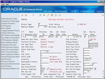

To enter employee multiple job information
On Employee Multiple Job Entry
Figure 6-1 Employee Multiple Job Entry screen
Complete the following fields:
Address Number
Home Business Unit
Complete the following optional fields:
Position ID
Job Type
Job Step
Union Code
Complete one of the following fields:
Salary
Hourly Rate
If you entered an effective salary, complete the following field:
Salary Frequency
6. Complete the following fields:
Change Reason
Effective Date
Pay Class
FLSA Exempt (Exempt in Canada)
EEO Job Category (EOC in Canada)
For employees with contract calendars attached, complete the following field:
Dock Component Flag
To enter pay information for the job, complete the following fields:
Date Pay Starts
Date Pay Stops
Pay on Standard Hours
Periods per Year
Standard Hours per Day
Standard Days per Year
Standard Hours per Year
FTE
Supervisor
Next Review Date
Next Review Type
Default Auto Pay
Complete the information for each job the employee holds.

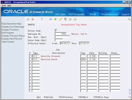

From Additional Employee Data & Reports (G77111), choose Occupational Pay Rates
You define occupational pay rates for employees who perform various job types and have different hourly rates for each job type. Pay rates are specific to an employee. They can be specific to a business unit and union for that employee.
To define occupational pay rate tables
Employee Number
Effective Dates
Job Type
Job Step
Hourly Rate
Billing Rate
Piece Rate
