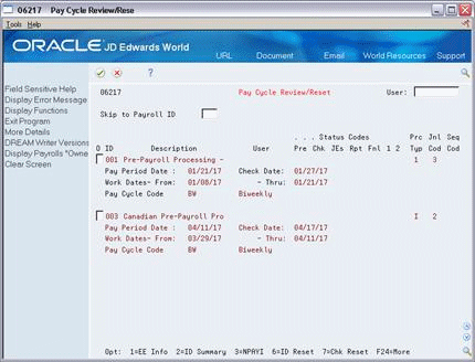

To review payroll cycle information
On Payroll Cycle Review/Reset
Figure 21-1 Pay Cycle Review/Reset screen
Review the information in the following fields:
Status Codes - Pre-Payroll Processing (Pre)
Status Codes - Print Payroll Cheques (Chk)
Status Codes - Payroll Journal Entries (JEs)
Status Codes - Reports Only (Rpt)
Status Codes- Final Update (Fnl)
Status Codes - Payroll01 (1)
Status Codes - Payroll02 (2)
Type of Processing (Prc Typ)
Payroll Expense Type (Jnl Cod)
Sequence Code (Seq Cod)
Access the detail area.

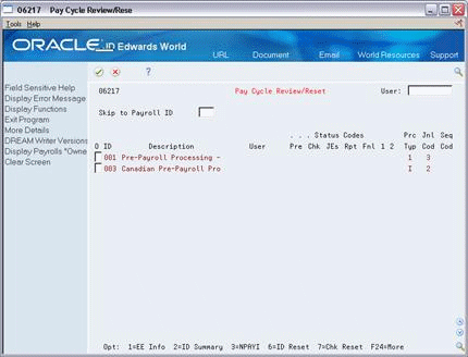

Figure 21-2 Payroll Cycle Review/Reset screen (Detail area)
Pay Period Date
Check Date
Work Dates
Pay Cycle Code

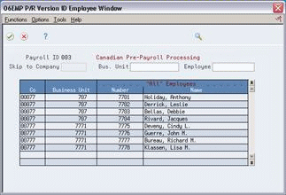

Choose the Employee Information option to review a list of employees locked by this payroll ID.

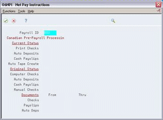

Choose the NPAYI option to access information about net pay instructions.

| Net pay instructions | The system stores information about net pay instructions in the NPAY1 data area. |
| Employee information option | During full processing the system displays all employees locked by this payroll ID. During processing only for changes, the system displays any employees whose information has changed and for whom you must process a pre-payroll only for changes. |
