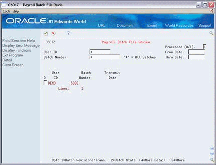

To revise uploaded timecard information
Figure 18-1 Payroll Batch File Review screen
Complete the following fields:
Processed
User ID
Batch Number
To further limit your search, complete one or more of the following optional fields:
From Date
Thru Date
If the system highlights the User ID, the batch has been processed.

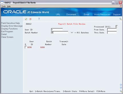

Access the detail area.
Figure 18-2 Payroll Batch File Review screen
Review the following field to see the number of lines in each batch:
Lines

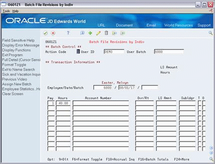

Choose the Batch Revisions/Transactions option for the batch you need to review.
Based on how you set the processing options, the system displays either Batch File Revisions by Individual or Batch File Revisions by Job. These forms are similar to the regular time entry forms. You can add, change, or delete records in an unprocessed batch.
Figure 18-3 Batch File Revisions by Individual screen
On Batch File Revisions, review the following field:
User Batch

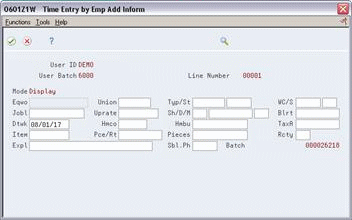

To review detail information for an employee, choose the Full Detail function on the employee's record line.
Figure 18-4 Time Entry by Employee Additional Information screen
On Additional Information, choose the Update function to revise any information.
Change or enter information in any of the fields.
Enter corrections or override information only. The server fills in blank fields during the processing program.
