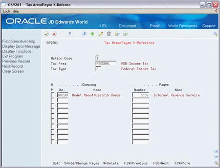

| Tax area and payee cross-reference | You set up cross-references between tax areas and payees for all accounts payable vouchers. |

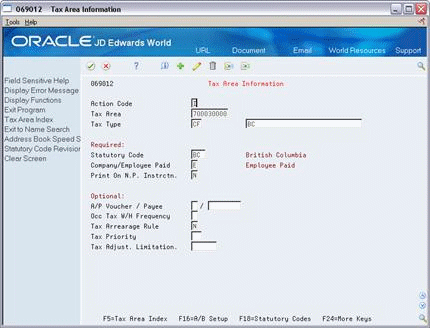

You set up tax areas in which your employees live and work for which taxes apply. The Vertex software performs the calculations based on the information you set up. Vertex calculates the employee-paid amounts even if you do not set up the tax area information.
In the Payroll system, a tax area is made up of two parts:
Tax area code - The tax area code is an identifying number assigned to all taxing authorities in the United States and Canada by Vertex, Inc. The system contains all federal, provincial, and state income tax area codes. You only add local and any new taxes. The tax area code, called the GeoCode, can consist of up to nine characters (XXYYYZZZZ) and is comprised of three distinct parts. The first two numbers identify the state (XX), the next three numbers identify the county (YYY), and the last four numbers identify the locality (ZZZZ).
XX = State (country 70 for Canada)
YYY = County (province in Canada)
ZZZZ = City or locality (does not apply to Canada)
Tax type code - The tax type code represents the kind of tax that you are defining. These codes are predefined by JD Edwards World, such as CA for federal income and CC for employee-paid Canadian employment insurance.
The GeoCode and the JD Edwards World tax area and tax authority are synonymous. GeoCode uses up to nine digits (XXYYYZZZZ) to structure U.S. and Canadian payroll.

To set up tax area information
On Tax Area Information
Complete the following fields:
Tax Area
Tax Type
Description
Company/Employee Paid
Print on Net Pay Instruction
If the tax area is a province, state, county, city, or local, complete the following field:
Statutory Code
Complete the following optional fields:
A/P Voucher
Payee
Occupational Tax Withholding Frequency
Tax Arrearage Rule
Tax Priority
Tax Adjustment Limitation
| Field | Explanation |
| Tax Area | A code that identifies a geographical location and the tax authorities for the employee's work site. Authorities include both employee and employer statutory requirements. In Vertex payroll tax terminology, this code is synonymous with GeoCode. Refer to Vertex System's Master GeoCode List for valid codes for your locations. |
| Tax Type | A user defined code (07/TT) that identifies the type of payroll tax being processed.
Refer to the associated user defined code records for the current descriptions of these codes. The values and meanings associated with this user defined code are pre-set by JD Edwards World. You should not alter the values and meanings. Form-specific information For Canadian provincial tax types: Set up tax type CF for every tax area even if there is no provincial tax because wage history is maintained by province. |
| Description-Alpha | Categorizes data item names. Enter text in upper and lower case. The system uses this field to search for similar data items. To enter an alpha description, follow these conventions:
Dates - Begin all Date fields with Date Amounts - Begin all Amount fields with Amount Units - Begin all Unit, Quantity, and Volume fields with Units Name - Begin all 30-byte description fields with Name Prompt - Begin any Y/N prompting field with Prompt Address Number - Begin all address numbers (employee, customer, owner) with Address Number Form-specific information For Tax Area Information, the first 12 characters of the description print on the pay stub. Because the tax area index sorts on this description:
| Print On N.P. Instrctn | Identifies whether the item is to be printed on the pay stub and whether the item is to be printed on a separate cheque from other payroll items. Valid codes are:
Pay Types/Payroll Taxes: Y – Print on pay stub (default) S – Print separate check (one item per check) C – Print separate check (C types combined) N – Do not print on pay stub Deduction/Benefit/Accrual Types: Y – Print as total deductions (default) S – Print separate check (one item per check) C – Print separate check (include detail) N – Do not print on pay stub I – Print individual transactions T – Print by DBA Print Group The separate cheque feature is not available for any payroll taxes being withheld from the employee's paycheque. Form-specific information Enter a Y for taxes paid by the employee. |
| Statutory Code | This code is used to specify the two-character or three-character state or province code that is printed on statutory reports such as W-2 and T4s.
For example, on W-2s and T4s, instead of printing 06 which might be the taxing authority for the state of Colorado, the system prints the statutory code CO. Form-specific information If you leave this field blank, the system uses the default value Federal. The statutory code field is left blank for all federal taxes. The second description is not a GeoCode. JD Edwards World recommends not changing this description because it is used for T4 reporting. |
| Co/ Emp | A code that specifies whether the payroll tax associated with the tax authority is paid by the company (expense) or a employee deduction (withholding). Codes are:
C – Company Paid E – Employee withheld If a code of E is used for employee withheld, then an associated DBA must be set up in order for this table to calculate correctly. DBA No. 9050 can be used as an example when setting up employee paid workers compensation. |
| A/P Voucher (Y/N) | The Yes or No Entry field is a common single character entry field for simple yes or no responses on prompt forms.
Form-specific information Indicates whether the system creates a voucher for this payroll tax in the Accounts Payable system. |
| A/P Voucher / Payee | The Address Book number for the supplier who receives the final payment.
In Benefits Administration, this is the Address Book number of the company that issues the plan and receives premium payments for it. For Wage Attachments, Payee is the Address Book number of the agency, company, individual, or court who is to receive the payment of the cheque. |
| Occ Tax W/H Frequency | This code is used to designate if the occupational head tax is to be withheld monthly (M), quarterly (Q), or annually (A). |
| Tax Arrearage Rule | A code indicating the method the system uses to back off payroll taxes when the employee is in a negative pay situation. Valid codes are:
P – The tax can be reduced as much as needed, either partially (to the stated limit) or in full. N – The tax can not be reduced. Q – The tax can be reduced as much as needed, and the amount is placed in arrears. When left blank the system enters the default value N. |
| Tax Priority | The prioritized sequence used by the system to back off payroll taxes when the employee is in a negative pay situation. Use a range of numbers from 01 to 99 to indicate the sequence. |
| Tax Adjust. Limitation | The maximum amount of payroll tax backed off net pay in order to meet the 'Minimum Check' requirements. |

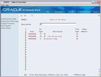

Locating tax areas using the tax area index allows you to rapidly search for a specific taxing authority by the tax area's description.
The system sorts the tax areas alphabetically by description. To make searching for tax areas easier, JD Edwards World recommends that you enter a description beginning with the state name or postal code.
To locate tax areas using the tax area index
On Index of Tax Areas
Description

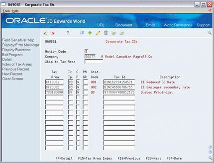

You set up tax IDs for employment insurance (EI) to store employee EI tax history and for reporting purposes.
You must set up tax area CFEDU01 for the employer-paid portion of EI. If your company is eligible for any reduced rates for EI, you can set up additional tax areas in the form of CFEDUxx.
If your company obtains a new tax ID, you must update affected records in the Tax Ledger (F0716) and Taxation Summary by Province (F0713) files. See Section 26.5, "Reposting the Tax ID to the Tax Ledger" for details.Set up a statutory code (U01, U02, and so forth) in user defined code list 07/SC for each tax area you enter
To set up tax IDs for Canadian employment insurance
Company
Tax Area
Tax Type
Tax Identification Number
Form-specific information For Canadian Payroll Tax Area CFEDU01 for tax type CD is required. You can enter up to ten different tax rates for EI. Tax Area 700190000 for tax type CF is required for Quebec taxes. |
| Tx Tp | A user defined code (07/TT) that identifies the type of payroll tax being processed.
Refer to the associated user defined code records for the current descriptions of these codes. The values and meanings associated with this user defined code are pre-set by JD Edwards World. You should not alter the values and meanings. Form-specific information For Canadian payroll: Do not enter a line for federal tax type CA. Tax type CD is required. You can enter up to ten different rates for EI. |
| Tax Id | A number that identifies your company to the tax authority. Such numbers include social security number, federal or state corporate tax IDs, sales tax number, etc.

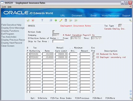

Setting up employment insurance rates allows you to define company-paid federal employment insurance.
You must set up these rates and the annual limit for each company. When you set up and use the rates for tax type CD, they override the employer-paid tax rates provided by Vertex. The Payroll system uses these insurance rates for reporting on records of employment (ROEs).
Define a valid tax type code for each tax authority number (tax area) you use. See Section 49.2, "Setting Up Tax Area Information".
To set up Canadian employment insurance rates
Figure 49-4 Employment Insurance Rates screen
Tax Type
Company
Effective Date of Rate From
Effective Date of Rate Thru
Tax Authority
Rate
Annual Earnings Limit
Exclude Premium Pay
Refer to the associated user defined code records for the current descriptions of these codes. The values and meanings associated with this user defined code are pre-set by JD Edwards World. You should not alter the values and meanings. Form-specific information For Canadian employment insurance (EI) rates, these are the Tax Types: CC – Canadian EI - Employee paid CD – Canadian EI - Company paid CI – Only the hours are exempt from EI |
| Rate | The rate used to compute Canadian employment insurance premiums. This is represented as a decimal fraction. |
| Annual Earn Limit | The annual limit for the unemployment insurance premium.
Form-specific information When you enter an amount in this field, you override the amount defined by Vertex. For Canadian payroll, you should enter the annual limit. The system uses this entry for ROE processing. |
| Exc Prm | A code that indicates whether premium pay should be excluded from the calculation.
When dealing with Workers Compensation Rates, this field relates only to those pay types that are defined in the insurance basis tables. When dealing with Canadian employment insurance rates, this field relates to all pay types that are defined as Taxable. |

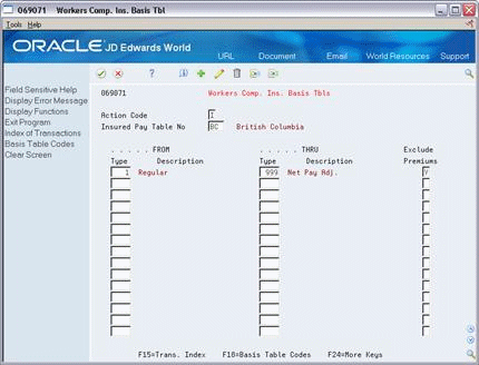

You set up workers compensation insurance basis tables to maintain groups of pay types or benefits for which insurance premiums for workers compensation and general liability insurance are calculated. Typically, each table represents a state or province and includes the types of earnings that are insurable in that state or province for workers compensation. The state or province usually supplies the information you need to set up the tables.
Define the names of the insured pay tables in user defined code list 07/IP.
Define the valid values for workers compensation codes in user defined code list 00/W. See Section 33.1, "Setting Up User Defined Codes for Payroll".
To set up workers compensation insurance basis tables
On Workers Compensation Insurance Basis Tables
Figure 49-5 Workers Compensation Insurance Basis Tables screen

Insured Pay Table Number
From PDBA Code
Thru PDBA Code
Exclude Premiums
| Insured Pay Table No | A code that identifies a table of pay, deduction, and benefit types that define the basis for various payroll calculations. These tables are used in several different processes, such as defining insured pay types for workers compensation and identifying pay types to be included in automatic timecard generation, step progression processing, and retroactive pay processing.
Step progression processing uses valid pay types from the Workers Compensation Table. You can add a code to the user defined code list (07/IP), then use that code to define a range of pay types in the Workers Compensation Table (for example, STP for Step Progression). The Step Progression table uses the range of defined pay types to determine when an employee has met the step progression requirements and automatically moves to the next step. |
| Exclude Premiums (Y/N) | A code that indicates whether premium pay should be excluded from the calculation.

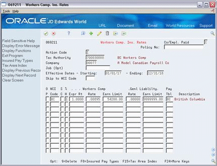

Set up workers compensation insurance rates to calculate workers compensation insurance premiums. You define these rates by the province, company number, and a range of dates.
Typically, the state, province, or insurance carrier supplies you with the information you need to set up the insurance rates.
The system calculates workers compensation in the payroll journal entries step of the payroll cycle. It calculates workers compensation for each timecard and updates each timecard with the workers compensation amount in the Time Entry table (F06116). This calculation is performed by JD Edwards World software while all other tax calculations are performed by Vertex.
Define a tax authority code (tax area code) for each applicable state or province that has the tax type code of W specified on Tax Area Information. See Section 49.2, "Setting Up Tax Area Information".
To set up workers compensation insurance rates
On Workers Compensation Insurance Rates
Figure 49-6 Workers Compensation Insurance Rates screen
Tax Authority
Company
Effective Dates - Starting
Effective Dates - Ending
Workers Compensation Insurance Code
Percentage/Hourly (%/H)
Experience Rating
Workers Compensation Insurance Limit
Complete the following optional field:
Subclass (SC)
| WCI Code | A user defined code (00/W) that represents a workers compensation insurance (WCI) code. This code should correspond to the classifications on your periodic workers compensation insurance reports. |
| S C | The subclass code defines any special circumstances associated with the workers compensation insurance (WCI) code that result in multiple rates for the same WCI code. The multiple rates may be due to location, risk, and so forth. The subclass should remain blank if multiple rates do not exist. Default codes are:
Blank There are no special circumstances associated with this code. F – There are special circumstances associated with this code. |
| Deduction/Benefit Method(%/H) | A user defined code 07/BM that indicates what method the system uses to calculate Workers Compensation, for example, rate times percent or rate times hours. The default is %.
Form-specific information The following list outlines the limits for each method: % (percent of gross) Pay period limit Enter an annual limit that the system divides by the pay frequency during the payroll cycle. The system compares the result to the employee's pay period earnings. H (rate times hours) No limit 1 (percent of gross) Monthly limit Enter a monthly limit. The system compares this amount to the employee's monthly earnings which are based on the cheque month. 6 (percent of gross) Annual limit This includes all workers compensation codes for an employee. |
| Expr Rt | The multiplier assigned by the insurance carrier which is used to modify the standard premium rate for workers compensation insurance from the table. This rate is based upon the insurance company's experience with the particular job type and the hazards associated with it. For example, if the insurance company trends indicate that construction workers in New Jersey have more work-related accidents than workers in New York, the company will rate the work done in New Jersey more hazardous. |
| Rate | This rate is used to calculate the insurance premiums for General Liability. The Rate is represented as a decimal fraction. |
| Earn Limit | This is the limit for General Liability. Depending on the benefit method chosen, this limit could be annual or monthly. General Liability is not calculated on amounts that exceed this limit. If a limit does not exist, leave this field blank and the system uses the default value 9,999,999.00. |

You set up cross-references between tax areas and payees for all accounts payable vouchers. You use this when the Payroll system is integrated with the Accounts Payable system and the payee specified for the tax type in the Tax Area Information program is not applicable for all your companies.
To set up tax area/payee cross-reference
On Tax Area/Payee Cross-Reference
Figure 49-7 Tax Area/Payee Cross-Reference screen
Tax Area
Tax Type
Company Number
Payee Number
