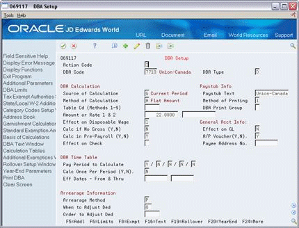

When you set up a simple DBA, you specify the minimum amount of information the system needs to perform the calculation. Typically, you will want to calculate a simple DBA in one of two ways:
When you set up a simple DBA, you can do one of the following:
Specify the actual amount or rate to calculate
Omit the actual amount or rate to calculate
If you omit the actual flat dollar amount or the percentage rate information during setup, you can enter it when you assign the DBA at the group, employee, or timecard level.
To designate whether this is a deduction, benefit, or an accrual complete the following field:
DBA Type
Complete the following fields:
DBA Code
Source of Calculation
Method of Calculation
If you want the same amount or rate to apply to all employees assigned the DBA, complete the following field:
Amount or Rate 1
To include a brief description of the DBA, complete the following field:
Paystub Text
If this is a benefit, complete the following field:
Effect on Check
If you want the DBA to be effective for a specific period of time, complete the following fields:
Effective Date From
Effective Date Thru
Use the Add action.

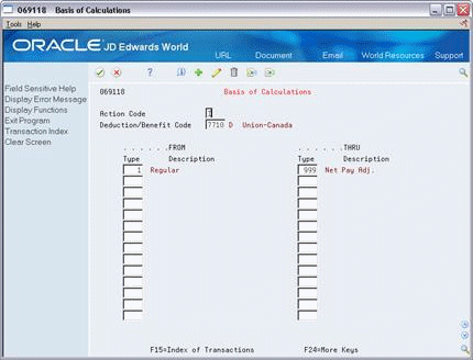

On Basis of Calculations, if you want to include all pay types (1 - 999) for calculating the DBA, exit the Basis of Calculation screen without making any entries.
On Basis of Calculations, if you want to limit the PDBAs, complete the following fields with the range of pay types you want included in the calculation and press Enter:
From PDBA Type
Thru PDBA Type
On DBA Setup, locate the DBA.
Review the values supplied by the system for the following fields:
Effect on Disposable Wage
Calculate if No Gross
Effect on General Ledger
A/P Voucher
Pay Period to Calculate
Calculate Once Per Period
Arrearage Method
When to Adjust Deductions
If you want DBA information to appear on the employees' pay stubs, verify the following fields:
Method of Printing
Calculate in Pre-Payroll

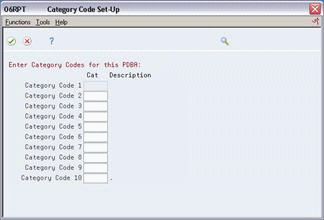

You set up category codes for DBAs as a way to group together DBAs for reporting purposes. You can use category codes one through ten for these purposes.
To set up category codes for DBAs
On DBA Setup
Complete the applicable steps for setting up a simple DBA.
On Category Codes Setup, complete the following field:
Category (Cat)
| Field | Explanation |
| Cat | This is a Payroll system category code for Deductions, Benefits and Accruals. You may define the use and description of this code to fit the needs of your organization. |

On Basis of Calculations, complete the following fields with the DBA code that the DBA is based on:
From DBA Type
Thru DBA Type
If the DBA entered for the basis of calculation is assigned at the group level and the new DBA is assigned at the employee level, choose the Additional Information function.

From Pay/Deductions/Benefits Setup (G7742), choose DBA Setup
To verify that you have set up your DBA correctly, you can assign it to an employee and process an interim payment for that employee. The interim payment detail displays the DBA amount and also the basis of calculation. For example, if a deduction is a percentage of an employee's gross pay, the basis of calculation is the gross amount.
On DBA Setup
Follow the steps for setting up a simple deduction, benefit, or accrual.

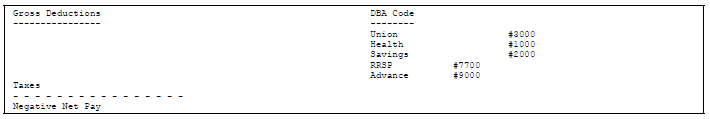

The system adjusts the DBAs in the following order if the When to Adjust Deductions field is 0 (default) and the Order to Adjust Deductions is blank:
Figure 35-9 Example: When to Adjust Deductions = 0 and Order to Adjust Deductions = blank
In this example, you want the RRSP adjusted (not deducted) before the Advance, Union dues, and Health. Therefore, assign RRSP a value of 0 in the When to Adjust Deductions field. Assign Advance, Union dues, and Health a value of 1.
The following illustrates the sequence of adjustments the system will use to bring the payment balance to .00:
Company policy might be to deduct the advance from the employee's pay before taxes are deducted. The government will make up any tax inequity with this employee at year end, but the company may not be able to retrieve the advance amount if the company no longer employs the individual. Enter 2 in the When to Adjust Deductions field for the Advance. The sequence of adjustments is as follows:
Figure 35-10 Example: Payroll Calculations to Adjust Negative Pay
This example illustrates how the codes in the When To Adjust and Order to Adjust fields would work for one employee. When you set up your DBAs you must consider how these codes impact all employees using these deductions.

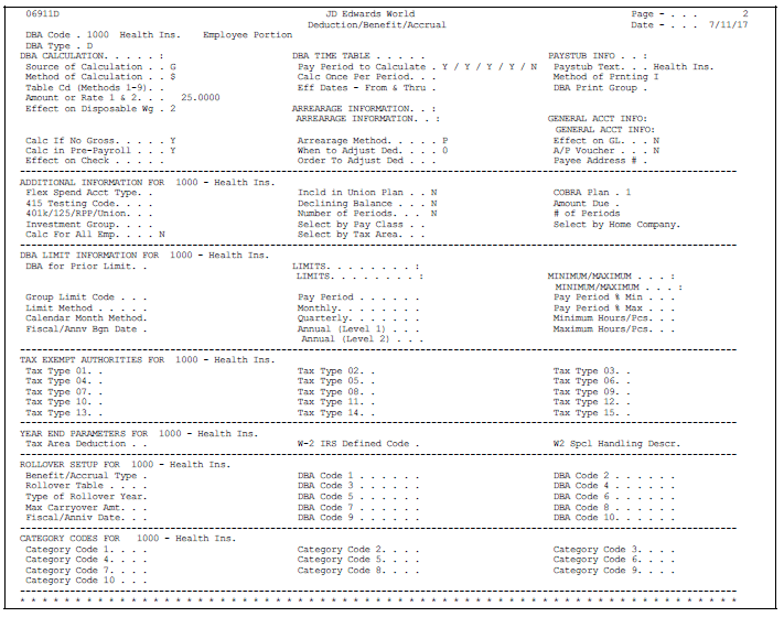

After you have set up all of your DBAs, you can review a detailed listing of them in order by DBA code.
Figure 35-13 Deduction, Benefit, and Accrual report

From Pay/Deductions/Benefits Setup (G77442), choose Basis of Calculation Report

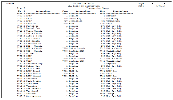

The Basis of Calculations report prints a list of basis of calculations tables to review. Review this report to verify the accuracy of your entries.
Figure 35-14 Basis of Calculations report
