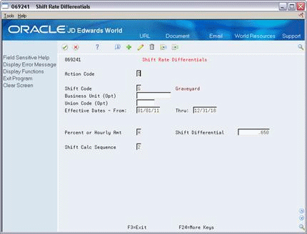

From Canadian Payroll Master (G77), enter 29
From Payroll Setup (G774), choose Group Constants
From Group Constants (G7745), choose Shift Rate Differentials
A shift differential is a flat dollar or percentage amount added to an employee's hourly rate. You set up shift rate differential codes to assign them to employees who receive additional compensation for shift work.
You assign shift differentials to user defined shift codes (07/SH). You can also assign business units and union codes to shift differentials. When you define a shift differential, you must set effective dates for the table. The system compares the effective dates to the work dates you enter in time entry.
A shift rate differential can be either a flat dollar amount or a percentage of the employee's hourly rate. The system uses a flat dollar amount or a percentage shift differential with either of the following two methods:
The first method is hourly rate plus the shift differential, multiplied by the pay type multiplier and then multiplied by the hours worked.
The second method is hourly rate multiplied by the pay type multiplier plus the shift differential and then multiplied by the hours worked.
The difference between the two methods is significant only when a multiplier other than 1 is specified.
Use shift code information to ensure that an employee is paid the correct amount for working on a shift with a rate differential. If an employee:
Always works a shift for which a shift rate differential is applicable, include the shift code in the employee's master record
Occasionally works a different shift, you can override the information on the applicable time card
To set up shift rate differentials
Figure 42-3 Shift Rate Differentials screen
Complete the following fields:
Shift Code
Effective Date From
Effective Date Thru
Percent or Hourly Amount
Shift Differential
Shift Calculation Sequence

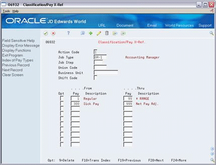

From Group Constants (G7745), choose Classification/Pay X-Reference
You set up pay type cross-reference tables to indicate valid pay types by job type and job step. For example, use these tables to prevent a salaried person from receiving overtime pay or a temporary employee from receiving holiday pay.
To verify pay types against the pay type cross-reference tables, you must set the appropriate processing options in the time entry programs.
To set up pay type cross-reference tables
On Classification/Pay Cross-Reference
Figure 42-4 Classification/Pay Cross-Reference screen
Job Type
From Pay Type
Thru Pay Type
Complete the following optional fields:
Job Step
Union Code
Business Unit
Shift Code
| Field | Explanation |
| From | The number and description of the PDBA you want the system to use to calculate the corresponding DBA.
Form-specific information When you are defining the range of pay types, and the range includes only one pay type, the from and thru fields must contain the same pay type number. |
| Thru | The number and description of the pay type you want the system to use to calculate the corresponding pay type. This is the ending number in the range that is the basis of the calculation.
Test for conditional import. Nancy b Form-specific information When you are defining the range of pay types, the thru value must be greater than or equal to the value in the from field. If the range includes only one pay type, the from and thru fields must contain the same pay type number. |
| Shift Code | A user defined code (07/SH) that identifies daily work shifts. In payroll systems, you can use a shift code to add a percent or amount to the hourly rate on a timecard.
For payroll and time entry: If an employee always works a shift for which a shift rate differential is applicable, enter that shift code on the employee's master record. When you enter the shift on the employee's master record, you do not need to enter the code on the timecard when you enter time. If an employee occasionally works a different shift, you enter the shift code on each applicable timecard to override the default. |

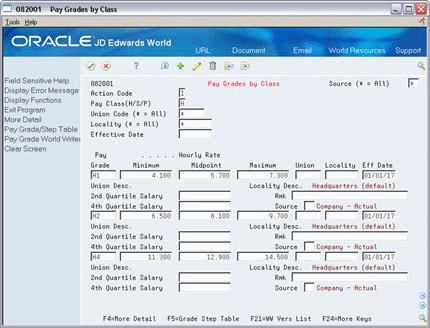

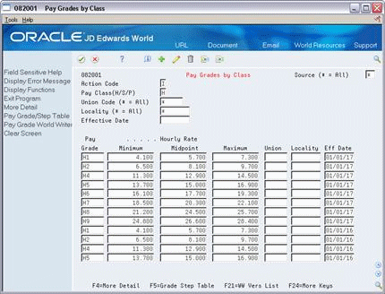

From Payroll Setup (G774), choose Pay Grade / Contract Setup
From Pay Grade / Contract Setup (G7749), choose Pay Grades by Class
To establish categories for grouping employees according to pay ranges, you can set up pay grades for each pay class within your organization. (A pay class indicates how an employee is paid, such as salary, hourly, and so on.) For example, within the pay class Salaried you can set up pay grades 1 through 10. For each of these pay grades, you define a minimum, midpoint, and maximum salary amount. These amounts define the pay range for the pay grade. For example, the pay range for pay grade 1 might be:
Minimum = 20000.00
Midpoint = 25000.00
Maximum = 30000.00
This means that the annual salary for an employee in pay grade 1 can be any amount between 20000.00 and 30000.00.
When you define pay grades by class, you establish a permanent record of the pay ranges for your organization's pay grades. The system uses these pay ranges to calculate compa-ratios for the employees that you assign to these pay grades. When you enter employee information, the system displays an error or warning message when you enter a rate that is not within the pay range for the employee's pay grade.
This program updates the Pay Grade and Salary Range Table (F082001).
Complete the following field:
Pay Class
To specify information that applies to all (or most) of the pay grades in this pay class, complete any of the following fields:
Source
Union Code
Locality
Effective Date
To define a pay grade, complete the following fields:
Pay Grade
Minimum
Midpoint
Maximum
To enter information that varies from the information that you entered for the pay class, complete the following optional fields:
Union
Locality
Effective Date
Complete any of the following optional fields:
Second Quartile
Fourth Quartile
Remark
Source
| Source (* = All) | A user defined code (08/SS) that identifies the source of the salary information. To display all pay grades regardless of the source, place an asterisk (*) in this field. |
| Pay Class(H/S/P) | A code that indicates how an employee is paid. Valid codes are:
" " – Blank H – Hourly S – Salaried P – Piecework |
| Union | A user defined code (07/UN) that represents the union or plan in which the employee or group of employees work or participate. |
| Locality (* = All) | A user defined code (07/SL) that defines the different salary localities within an organization. For example, you can compare salaries for employees on the East Coast with employees in the Midwest.
Form-specific information This field appears in following two sections of this form:
| Effective Date | The date on which this transaction takes effect. The effective date is used generically. It can be the date of the next raise, a lease effective date, a price or cost effective date, a currency effective date, a tax rate effective date, change in well status, or whatever is appropriate. |
| Pay Grade | A code that designates a category for grouping employees according to pay ranges. For each pay grade, you enter a pay range that includes a minimum, a midpoint, and a maximum pay rate. The system uses these pay ranges to calculate compa-ratios for the employees that you assign to pay grades. After you enter a pay grade for an employee, the system displays an error or warning message if you enter a rate for the employee that is not within the pay range for the employee's pay grade.
To set up pay grades, use Pay Grades by Class (P082001). |
| Minimum | The minimum salary or hourly rate allowed for a pay grade.
The system displays a warning or error message (depending on processing options) when you enter a pay rate for an employee that is lower than the minimum rate for the pay grade. |
| Midpoint | The midpoint salary or hourly rate for a pay grade or pay range.
For job IDs with a defined pay grade, you enter the midpoint amount in the Pay Grade table (F082001). For job IDs that you evaluated by points, the system calculates the midpoint amount using a Pay Range Formula table (F08290). The system calculates a compa-ratio (data item #CRA) for an employee by dividing the employee's salary or rate by the midpoint for the employee's pay grade. |
| Maximum | The maximum salary or hourly rate for a pay grade.
The system displays a warning or error message (depending on processing options) when you enter a pay rate for an employee that is higher than the maximum rate for the pay grade. |
| Rmk | A generic field that you use for a remark, description, name, or address. |

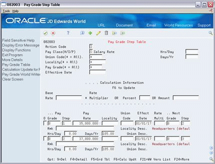

From Payroll Pay Grade / Calendar Setup (G7749), choose Pay Grades Step Table
To ensure that all of the employees working in a job receive the same rate of pay, and to establish progression within a pay grade, you can set up pay grade steps. For example, you might have a pay grade A that contains pay steps A1, A2, and A3. Employees in step A1 receive 15.00 per hour, employees in step A2 receive 15.50 per hour, and employees in step A3 receive 16.00 per hour.
Setting up pay grade steps lets you automate the following:
Tracking pay information for employees. When you enter employee information, the system calculates the employee's salary or hourly rate, based on the pay grade step that you enter for the employee.
Moving employees from one pay grade step to the next.
Updating pay rates for multiple pay grades and pay steps.
When you set up pay grade steps, you can save time and reduce calculation errors by having the system automatically calculate the pay rates for a group of steps. You enter a base pay rate that applies to the group of steps, and then enter a pay rate multiplier for each step. The system calculates the rate for each step by multiplying the base pay rate by the step's pay rate multiplier.
Setting up pay grade steps includes:
Setting up pay grade steps individually
Setting up pay grade steps using a pay rate multiplier
When you set up pay grade steps individually, you enter a pay rate for each pay grade step. When you set up pay grade steps using a pay rate multiplier, you enter a base pay rate, and apply a pay rate multiplier to each pay grade step.
| Topic | Description |
| Setting up pay grades in the Pay Grade/Step table | You can define the pay grades at the same time that you define pay grade steps. You do not need to define a pay grade in the Pay Grade and Salary Range table (F082001) to set up pay grade steps. |
To set up pay grade steps individually
Pay Class
To specify information that applies to all (or most) of the pay grade steps you need to define, complete any of the following fields:
Union Code
Locality
Hours/Days
Days/Year
Effective Date
For each pay grade step that you need to define, complete the following fields:
Pay Grade
Pay Grade Step
Pay Rate
Next Pay Grade
Next Pay Grade Step
Access the detail area.
To specify information for this pay grade step that varies from the information that you entered for the pay class, complete the following fields:
Locality
Union Code
Effective Date
Hours/Day
Days/Year
| Hrs/Day | The number of hours in a day that the employee's normal work schedule is different from the standard. If you leave this field blank, the default is the standard number of hours per day as defined in the payroll company constants.
For example, if the standard number of hours in a day is 8 and an employee is scheduled for 7 hours per day on a regular basis, enter 7 in this field. |
| Days/Yr | The number of work days in a year. The number of standard days per year multiplied by the number of hours per day equals the standard hours per year. When you have set up the human resources constants to use the pay grade step table as the default pay rate source, the system calculates the salary for an employee by multiplying the standard days per year by the employee's hourly rate. |
To set up the pay grade steps using a rate multiplier
Pay Class
To specify information that applies to all (or most) of the pay grade steps that you need to define, complete any of the following fields:
Union Code
Locality
Hours/Days
Days/Year
Effective Date
Base Rate
Pay Grade
Pay Grade Step
Rate Multiplier
Next Pay Grade
Next Pay Grade Step
Locality
Union Code
Effective Date
Hours/Day
Days/Year
To calculate the pay rate for each pay grade step you entered, choose the Calculation Update function.
The Shift Table report prints a detailed list of the shift differential tables. Review the report to verify that the shift rate differential you entered is correct. You cannot change the data sequence or selection for this report.
