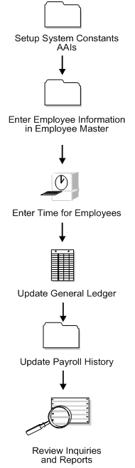

1.4 Time Accounting System Flow
Figure 1-1 Time Accounting System Flow
Description of Figure 1-1 follows
Description of "Figure 1-1 Time Accounting System Flow"
