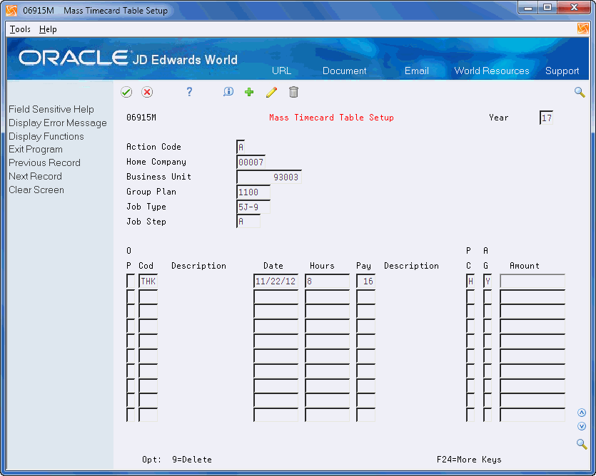

You use the Mass Timecard Table Setup program (P06915M) to create and maintain timecard tables or templates that define the mass timecards. The system creates the timecards based on the mass timecard tables. The key to the timecard table is the UDC 07/MT value that you enter in the Code field. Other key fields include the Year, Home Company, Business Unit, Union Code, Job Step, Job Type, Date, and Pay Class.
The system stores the mass timecard information in the Mass Timecard Generation Table File (F06915M).
There can only be multiple records with the same mass timecard code for the same date when those records have unique pay class values. If the pay class value of a record is blank there can be no other records in the F06915M with the same mass timecard code and date values because the system uses a blank pay class value to create timecards for all pay classes.

To set up mass timecards tables
On Mass Timecard Table Setup, complete the Home Company field.
Complete the following optional fields and click Add.
Year
Business Unit
Group Plan
Job Type
Job Step
Code
Date
Hours
Pay (Type)
Pay Class (PC)
Automatic T/C Generation Flag (AG)
Figure 16-1 Mass Timecard Table Setup screen
| Field | Explanation |
| Group Plan | A user defined code (07/UN) that represents the union or plan in which the employee or group of employees work or participate. |
| Code | A user defined code (07/MT) that designates the type of timecards that will be created in Pre-Payroll by the Mass Timecard Generation process. |
| Hours | The number of hours associated with each transaction. |
| Pay | A code that defines the type of pay, deduction, benefit, or accrual.
Pay types are numbered from 1 to 999. Deductions and benefits are numbered from 1000 to 9999. |
| Pay Class (PC) | A code that indicates how an employee is paid. Valid codes are:
Blank H Hourly S Salaried P Piecework |
| Automatic T/C Generation Flag (AG) | A flag which identifies whether these timecards are to be automatically generated in Pre-Payroll as part of the Mass Timecard Generation process. |
