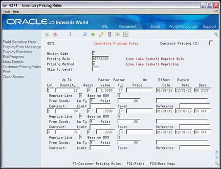

On Inventory Pricing Rules
Figure 26-1 Inventory Pricing Rules (Repricing) screen
Description of Figure 26-1 follows
Description of "Figure 26-1 Inventory Pricing Rules (Repricing) screen"
  1. Complete the following fields:
    • Pricing Rule
    • Pricing Method

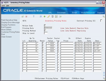

  2. For basket repricing, access the fold area.
    Figure 26-2 Inventory Pricing Rules (Basket Repricing) screen
    Description of Figure 26-2 follows
    Description of "Figure 26-2 Inventory Pricing Rules (Basket Repricing) screen"
  3. Complete the following field:
    • Reprice Line
Field Explanation
Reprice Line or Order Code that is applicable only if you are using pricing method R (Basket Repricing). Y (yes) tells the system to apply the pricing rule to the unit and calculate the extended price. N (no) tells the system to write a new order detail line for the amount of the additional discount into the sales order.
The Order Repricing Program (P421301) provides an option to reprice orders that had already been repriced. You can alter the results of this process by adjusting this field. If you would like to re-discount the order based on the original unit price, you must have this field set to N or blank PRIOR TO repricing the order. However, if you would like to re-discount based on the discounted unit price, set this field to Y to adjust the individual detail lines. For more detail on this process, please refer to the help instructions of the Order Repricing Program (P421301).

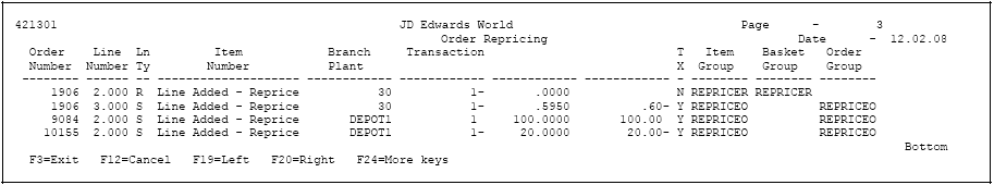

The Standard Order/Basket Reprice program generates a report listing the order lines that the program repriced.
Figure 26-3 Order Repricing report
Description of Figure 26-3 follows
Description of "Figure 26-3 Order Repricing report"
