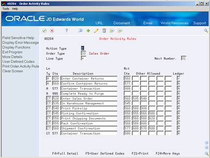

To set up order activity rules
On Order Activity Rules
Figure 7-1 Order Activity Rules
Description of Figure 7-1 follows
Description of "Figure 7-1 Order Activity Rules"
Complete the following fields:
  • Order Type
  • Line Type
  • Next Number
  • Sta
  • Description
  • Next Sta
  • Other Allowed
  • Ledger
