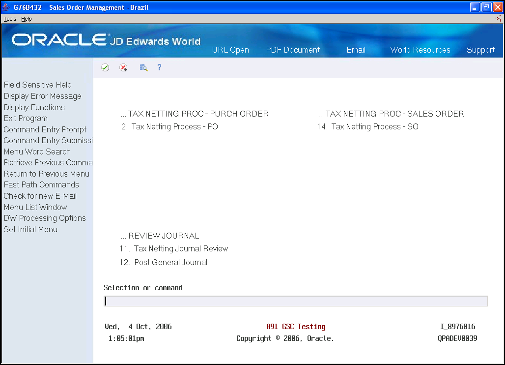

From Localizations - Brazil (G76B), choose Purchase Order Management or Sales Order Management
From Purchase Order Management - Brazil (G76B43), choose Tax Netting Process or
From Sales Order Management - Brazil (G76B42), choose Tax Netting Process
From Tax Netting Process - Brazil (G76B4322), choose Tax Netting Process - PO or Tax Netting Process - SO
Figure 44-1 Sales Order Management - Brazil screen

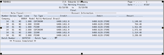

You can run the Tax Netting Process program in either proof or final mode. When you run the program in proof mode, you can review the report that the system produces to determine if any errors exist. The report includes:
Date range for the processed records.
Whether the report is for the proof or final run of the program.
If you set the processing option to print in detail, information is printed about the nota fiscal for each record, including the number, series, line, and tax type.
Additionally, the report shows whether each transaction generated a debit or credit journal entry, and the amount of the entry. The Debit Account Number and Credit Account Number is also printed.
Errors that occurred during processing. If any validation error is detected when assigning the account, an error message is printed below the detail line. After you correct any errors, you can run the report in final mode to create the journal entries and the batch.
The batch number and batch type (if you set the processing option to run the program in final mode and no errors occurred during processing) are also printed.
Figure 44-2 Example of the Tax Netting Report

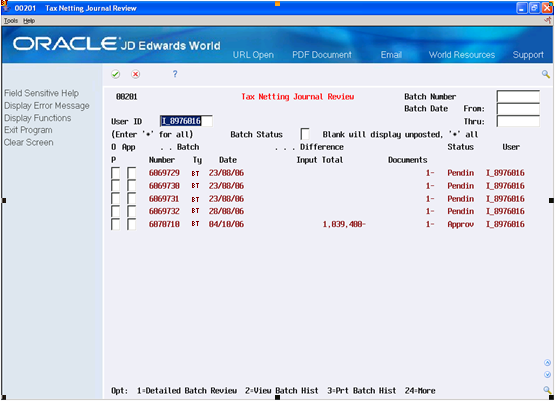

When you run the Tax Netting Process program in final mode, and there are no errors, the system writes records to the F0911 table for each selected, unprocessed record in the Nota Fiscal Taxes Detail - Brazil File (F76B4001). The processed flag in F76B4001 is set to '1,' the batch type is set to 'BT' and the batch number is populated. The batch can be reviewed and posted.

Figure 44-3 Tax Netting Journal Review screen
