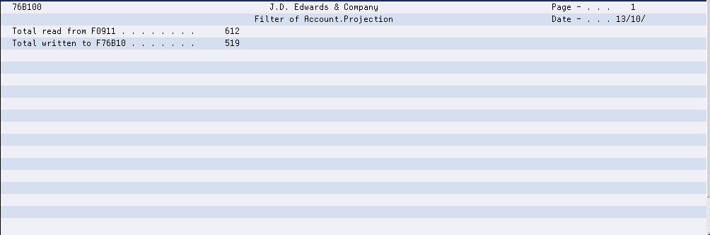

Figure 55-1 Report: Accounting Transactions - R76B100
If there are editing errors, they are printed in the report as well:
Open Error in File F76B10
Account invalid
Cost center invalid
Duplicate key (This message appears when the program tries to write a record with duplicated key. File F76B10LA, has a Unique Key restriction.)
In the report, a summary of the process is also printed with the number of records read from F0911 - Account Ledger and the number of records written into F76B10 - Accounting Projections Workfile.

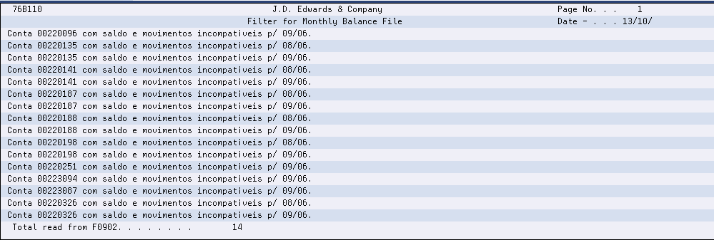

Figure 55-2 Report: Monthly Account Balance - R76B110
Printed errors that may be generated from the process:
Erroneous month
Through month cannot be lower than from month to report
Error on CLRPFM for file F76B80. Verify JOBLOG
Open Error for file F76B80
Account with balance and transactions non compatibles for period month/year
Account invalid in F0901
Error on CLRPFM for file F76B72. Verify JOBLOG
Error on CLRPFM for file F76B74. Verify JOBLOG
Error in account processing
Error in cost center processing
Duplicate key (this message appears when the program tries to write a record with duplicated key. File F76B80LA, has a Unique Key restriction)
The summary of the process is printed, indicating the number of records read from F0902 - Account Balance file and the number of records written into F76B80 - Monthly Accounting Balance Workfile
See Section 70.2, "Processing Options for Filter for Monthly Balance File (P76B110)"

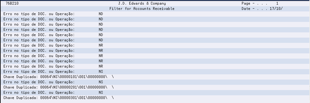

Figure 55-3 Report: Filter for Accounts Receivable - R76B210
Error on CLRPFM for file F76B20. Verify JOBLOG
Error on CLRPFM for file F76B70. Verify JOBLOG
Open Error for file F76B20
Error on AAI detailed account for transaction
Error on document or transaction type
Error on account processing
Error on customer processing
Duplicate key for transaction (this message appears when the program tries to write a record with duplicated key. File F76B20LA, has a Unique Key restriction)
The summary of the process is printed, indicating the number of records read from F0311 - Account Receivable Ledger and the number of records written into F76B20 - Customers and Suppliers Workfile
See Section 70.3, "Processing Options for Filter of Accounts Receivable (P76B210)".

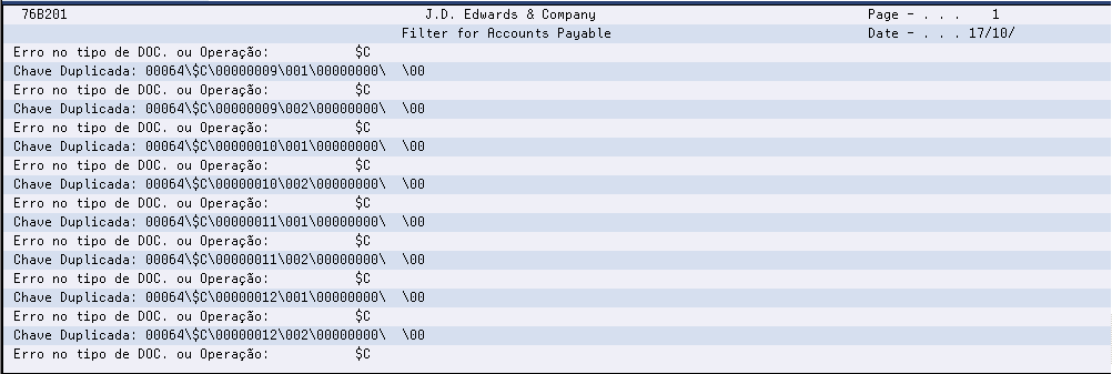

Figure 55-4 Report: Filter for Accounts Payable - R76B201
Error on supplier processing
The summary of the process is printed, indicating the number of records read from F0411JD file and the number of records written into F76B20 - Customers and Suppliers Workfile

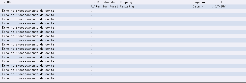

Figure 55-5 Report: Filter for Asset Registry - R76B630
Error on CLRPFM for file F76B63. Verify JOBLOG
Open Error on file F76B63
Duplicate key (this message appears when the program tries to write a record with duplicated key. File F76B63LA, has a Unique Key restriction)

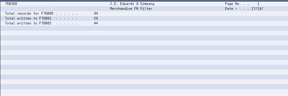

Figure 55-6 Report: Merchandise/Service N.F. Filter - R76B300
Error on CLRPFM for file F76B81. Verify JOBLOG
Error on CLRPFM for file F76B82. Verify JOBLOG
Error on CLRPFM for file F76B76. Verify JOBLOG
Error on CLRPFM for file F76B78. Verify JOBLOG
Open Error on file F76B81
Open Error on file F76B82
Error - Address Number
Error - Fiscal Note without Header record in F76B04
Error - Transaction Nature
Error - Item / Services
Duplicate key in header file (this message appears when the program tries to write a record with duplicated key. File F76B81LA, has a Unique Key restriction)
Duplicate key in detail file (this message appears when the program tries to write a record with duplicated key. File F76B82LA, has a Unique Key restriction)
The summary of the process is printed, indicating the number of records read from F76B05 - Nota Fiscal Item and the number of records written into F76B81 - Fiscal Note Master - Merchandise/services Workfile. F76B82 - Fiscal Note Master - Merchandise/services - Item Workfile

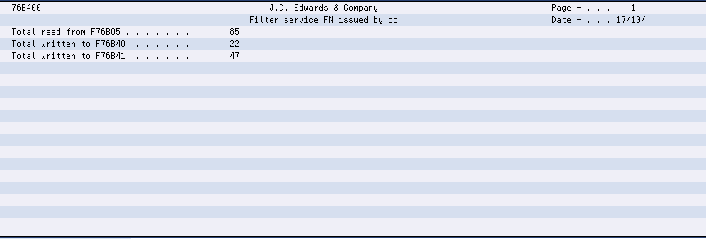

From Work files Creation - Brazil (G76B0060), choose 7-Service F.N. Issued by Company
Resolution IN86 establishes that files with information related to service nota fiscal not eligible to ICMS Tax transactions must be generated according to the format determined by the Fiscal Authority and presented to the Fiscal authority in a magnetic media.
This process executes the Workfile creation step, taking the data from Nota Fiscal Item file (F76B05) and generating the workfiles for:
Services Fiscal Notes (F76B40)
Services Fiscal Notes Detail (F76B41)
Address Book Registry (F76B70)
Item List (F76B78)
Base file: F76B05- Nota fiscal Item file.
Particular values are:
For each record read from Nota Fiscal Item file is determined the Type of transaction that this record represents. This determination is performed in agreement with the Operation Type Code (BNOC)

Figure 55-7 Report: Filter Service FN Issued by co - R76B400
Error on CLRPFM for file F76B40. Verify JOBLOG
Error on CLRPFM for file F76B41. Verify JOBLOG
Open Error on file F76B40
Open Error on file F76B41
Error - Fiscal note without header record in F76B04
Error - Item nbr. / services
Duplicate key in header file (this message appears when the program tries to write a record with duplicated key. File F76B40LA, has a Unique Key restriction)
Duplicate key in detail file (this message appears when the program tries to write a record with duplicated key. File F76B41LA, has a Unique Key restriction)
The summary of the process is printed, indicating the number of records read from F76B05 - Nota Fiscal Item and the number of records written into F76B40 - Services Fiscal Note workfile, F76B41 - Services Fiscal Note Detail workfile
See Section 70.7, "Processing Options for Service Note Issued by Co - Non ICMS (P76B400)".

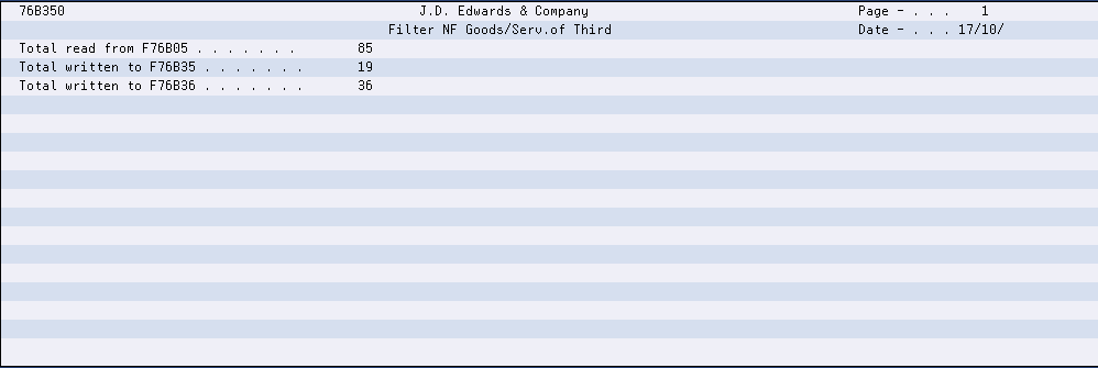

Resolution IN86 establishes that the data related to NF Goods/Services emitted by others must be informed in a magnetic support, in agreement with a format specified by the corresponding Fiscal Authority.
Master Notes of Goods/Services Emitted by Third Parties (F76B35)
Items Notes of Goods/Services Emitted by Thirds Parties (F76B36)
Transaction Nature (F76B76)
Item list (F76B78)
For each record read from Nota Fiscal Item file is determined the Type of transaction that this record represents. This determination is performed in agreement with the Operation Type Code (BNOC).
Acquisition - If the corresponding field from the file is not included in (1, 2, 3), set to '1'. Ledger Type - Is set to AA (hardcode).
If BNOC < 5000 - Inbound Transaction.
If BNOC > 5000 - Outbound Transaction.
This process will take only those records with BNOC < 5000.
Document template: is completed with the description 1 from the UDC 76/TN, accessed from (BNOC/BSOP) fields. If no records are found, takes value '01'.
Figure 55-8 Report: Filter NF Goods/Serv. Of Third - R76B350
Error on CLRPFM for file F76B35. Verify JOBLOG
Error on CLRPFM for file F76B36. Verify JOBLOG
Open Error on file F76B35
Open Error on file F76B36
Error - Item Nbr./ Services
Duplicate key in header file (this message appears when the program tries to write a record with duplicated key. File F76B35LA, has a Unique Key restriction)
Duplicate key in detail file (this message appears when the program tries to write a record with duplicated key. File F76B36LA, has a Unique Key restriction)
The summary of the process is printed, indicating the number of records read from F76B05 - Nota Fiscal Item and the number of records written into F76B35 - Master Notes of Goods/Services Emitted by Third Parties workfile. F76B36 - Items Notes of Goods/Services Emitted by Third Parties workfile
See Section 70.8, "Processing Options for NF Goods/Serv. Emitted by Third (P76B350)".

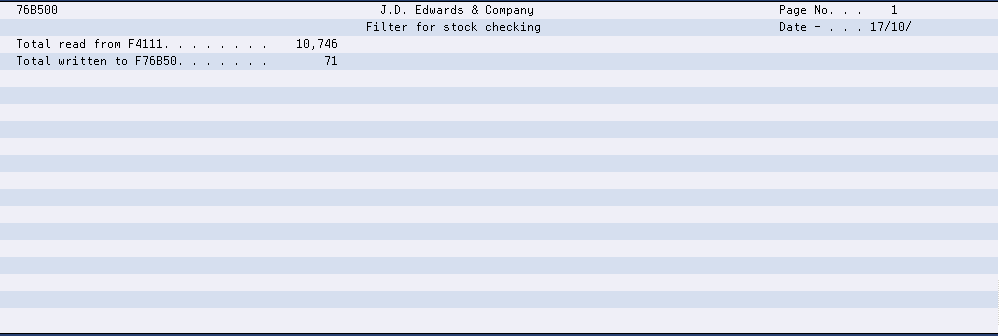

Figure 55-9 Report: Filter for Stock Checking - R76B500
Error on CLRPFM for file F76B50. Verify JOBLOG
Open Error on file F76B50LA
Error on item processing

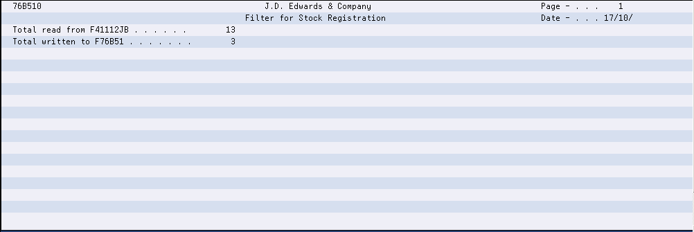

Resolution IN86 establishes that the data related to Inventory Register must be informed in a magnetic support, in agreement with a format specified by the corresponding Fiscal Authority.
This process executes the Workfile creation step, taking the data from Item ASOF file (F41112) and Branch Plant Fiscal Company Cross Reference file (F7606B) and generating the workfiles for:
Registration of Stock (F76B51)
Item list (F76B78)
Base file: F41112JB (Join Item ASOF File and Branch Plant - Fiscal company cross reference).
Stock Situation - Take the corresponding category code for Business Unit from Business Unit Master.
Figure 55-10 Report: Filter for Inventory Register - R76B510

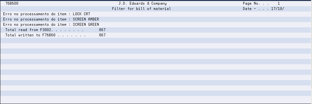

Resolution IN86 establishes that the data related to Bill of Material must be informed in a magnetic support, in agreement with a format specified by the corresponding Fiscal Authority.
This program executes the Workfile creation step, taking the data from Bill of Material Master File file (F3002) and generating the workfiles for:
Bill of Material for reporting purpose file (F76B60)
Item list (F76B78)
Base file: F3002 (Bill of material master file).
Batch Quantity<>0
Type of Bill of Material: M
Figure 55-11 Report: Filter for Bill of Material - R76B60
Error on CLRPFM for file F76B60. Verify JOBLOG
Open Error for file F76B60
Duplicate key (this message appears when the program tries to write a record with duplicated key. File F76B60LA, has a Unique Key restriction)

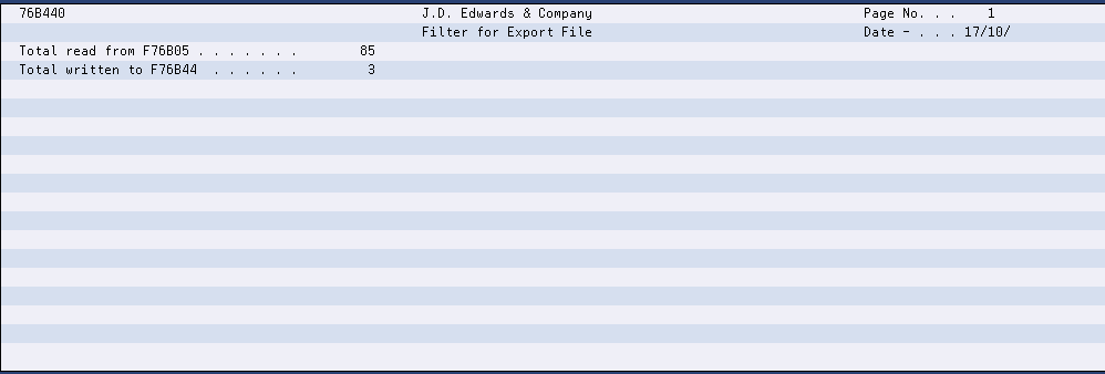

Figure 55-12 Report: Filter for Export File - R76B440
Error on CLRPFM for file F76B44. Verify Joblog
Open error on file F76B44
Closed process. Verify errors above
Duplicated Key error: Nota/Series/Type/Co (this message appears when the program tries to write a record with duplicated key. File F76B44LA, has a Unique Key restriction)
The summary of the process is printed, indicating the number of records read from F76B05 - Nota Fiscal Items, and the number of records written into F76B44 - "Export File" workfile
See Section 70.12, "Processing Options for Filter for Export File (P76B440)".
