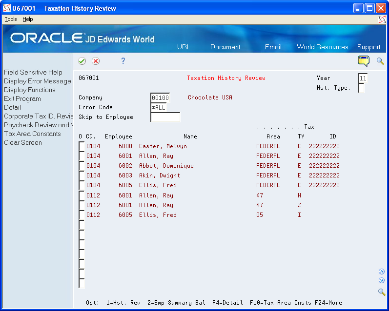

From Integrity, Rollover & Repost (G072471), choose Taxation History Review
On Taxation History Review, complete the following fields:
Year
Company
To limit your search, complete the following field:
Error Code
Choose Detail (F4) to review the error code in the employee record.
Description of the illustration ''tax_his_review_errors.gif''

To review or revise an employee's taxation history, enter 1 in the Option field to access Tax History Revisions.
On Tax History Revisions, enter any necessary corrections.

From Integrity, Rollover & Repost (G072471), choose Payroll Month PDBAs Review
On Payroll Month PDBAs Review, complete the following fields:
Error Code
Description of the illustration ''pyrol_mnth_pdbs_revi_ers.gif''
Access the detail area to review the error code in the employee record.
Perform one of the following:
To enter or correct a corporate tax ID number, choose Corporate Tax ID Revisions (F8).
To void a paycheck, choose Paycheck Review and Void (F9).
To review or revise an employee's tax history, enter 1 in the Option field to access Transaction History Revisions.
On Transaction History Revisions, enter any necessary corrections.
