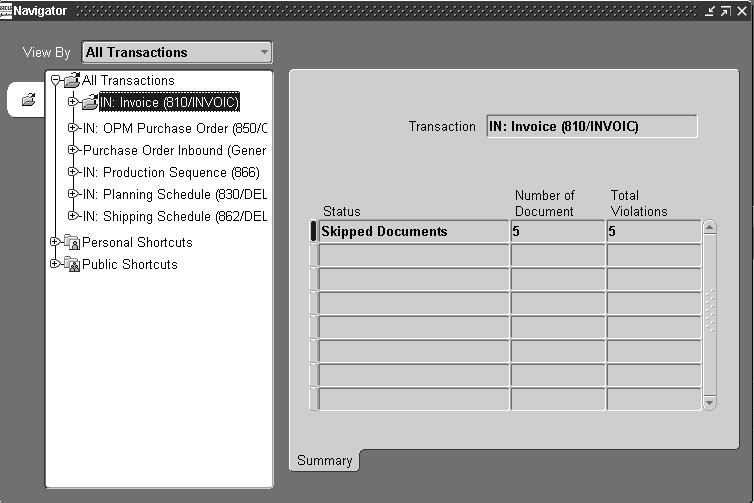

The navigator has a View By poplist that allows you to choose between the following viewing options: All Status, Status with Errors, All Transactions, and Transactions with Errors.
The Transaction selections display a hierarchical tree of transactions organized by transaction type. Some lines (”nodes”) in the tree can be expanded (and collapsed) to display lower level nodes.
Each node in the tree is color-coded and icon-coded as follows:
Green color/check mark icon: Transaction processed OK
Red color/letter "X" icon: Column or Process rule violations detected
Yellow color/triangle icon: Transaction not processed
The following table gives examples of the levels displayed in the hierachical tree.

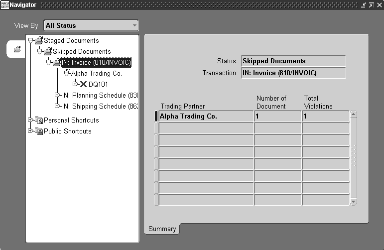

The Status selections display a hierarchical tree of transactions organized by status: The following actions are possible:
Aborted
The request was aborted based on rules.
Application Insert Failed
A failure occurred while inserting the document into the opend interface tables.
Reprocessing
This document (and the group to which it belongs) was resubmitted and is either being validated or is waiting to be validated.
Skipped Documents
The documents were skipped based on rules.
Unprocessed
The documents have been added to the staging tables but not validated yet.
The following table lists valid status information:
| Level | Sample |
| Status | Skipped Documents |
| Trading Partner | ABC Company |
| Document (Header) | 123456 |
| Line | 123467 |
You can use the View By poplist to display All Status, All Transactions, Status with Errors, or Transactions with Errors. Selecting an All option displays all documents in the staging table. Selecting with Errors displays only the documents with errors and the levels that contain errors. For example, if an invoice has a violation at line 3, only the header and line 3 are displayed. Lines 1 and 2 are not displayed.

The Summary tab on the right side of the window displays read-only summary information that corresponds to the level selected on the left side of the window. For example, if you drill down on the Transaction Type level, three more levels appear.
Summary information displays for each level. Lower levels display summary information that pertains to the level above.
Summary information is dynamic. When you select nodes in your tree, summary information for the node changes as well.
