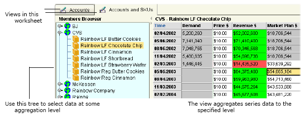

A worksheet consists of one or more views, usually displayed as tabs within the worksheet. Each view retrieves a set of data that is aggregated in a specific way and that may also be filtered. The following shows an example:
Use this tree to select data at a level of aggregation. The view aggregates series data to the specified level. Here, views are shown as tabs within the worksheet. You can also display views as child windows of the worksheet.
The first interesting feature of any worksheet view is the aggregation level or levels that it uses. For example, you might want to view data at the account level, as follows:
The worksheet might include a dropdown list instead of this tree control. For example:
In either case, you can view data for any account. For example, for the quarter that started on February 3, 2003, the Demand for the CVS account was 1, 571, 396 units, and the unit price was $9.99. You can edit any data that is shown in white, such as the price and market plan.

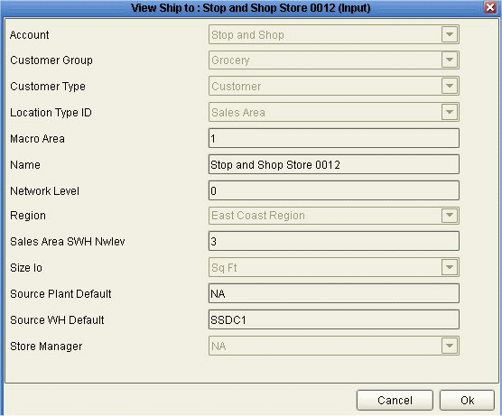

A level can have attributes. For example, a Ship To member might have the following attributes:
Apart from the Name attribute, the attributes shown in red are all parents of this member. They are shown in red because they are required.
The other attributes (such as Unit Cost) do not represent levels in the system but contain information used for reporting and other purposes.

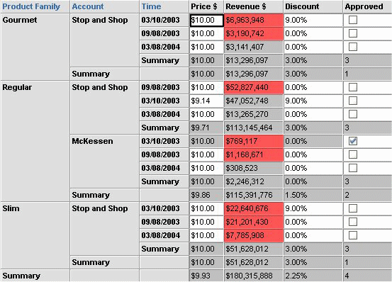

Each series has been configured to be summarized in a specific way, which you can see in the summary row of the worksheet table. The table has at least one summary row; depending on the layout, it may also include subtotal rows. The following shows an example:
As you can see, Oracle Demantra provides different summarizing options. In this example:
Price and Discount are summarized by averaging.
Revenue is summarized by adding all the values.
The Approved series is summarized by counting the number of approvals.
More complex options are also available. A given series can be summarized in different ways within a single worksheet table. Consult your implementors for details on how your series are summarized.

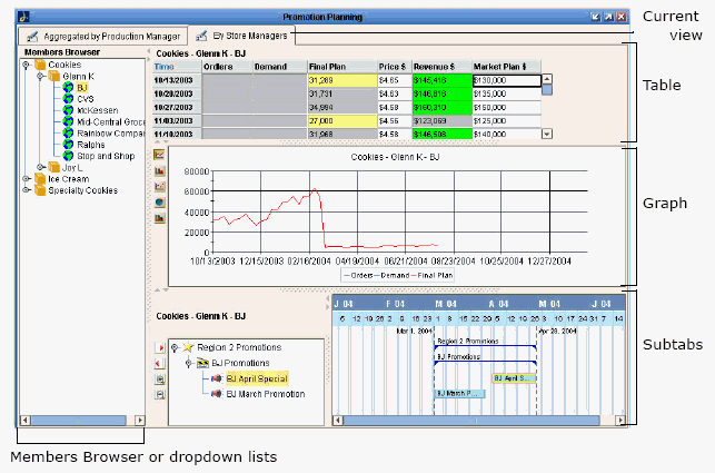

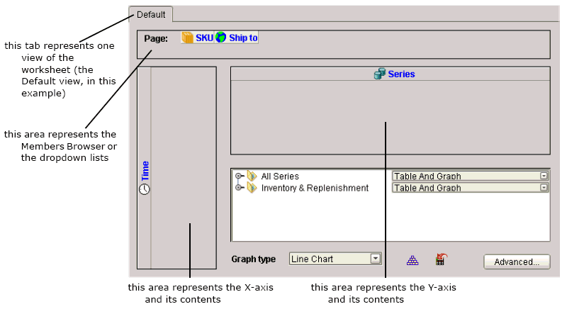

In general, a worksheet view can contain the following common visual elements:
Each worksheet view has an x-axis and a y-axis.
In the graph, the x-axis is shown horizontally and the y-axis is shown vertically.
In the table, the x-axis is displayed vertically and the y-axis is displayed horizontally. (This way, the x-axis displays the same data in the table and in the graph.)

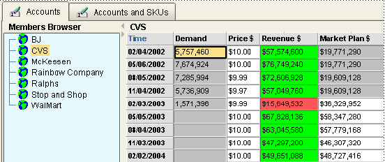

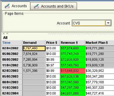

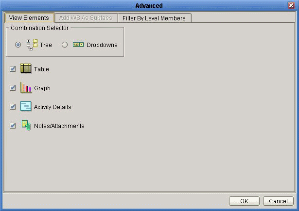

As noted earlier, a worksheet view usually includes either a Members Browser or a set of dropdown menus, which you use to choose the data to display in the rest of the worksheet:
| Members Browser |
| Selection lists |
In each case, the selected combination is “Low fat products at the BJ account.”
In addition to providing a way to select the data to display, the Members Browser enables you to create, edit, and delete the level members. See Managing Items and Locations. Depending on your implementation, you may also be able to perform additional operations on the members; see Using Other Right-Click Menu Options.
In some cases, the worksheet does not include either of these controls. This means one of following is true:

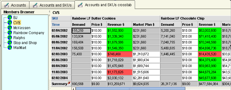

The worksheet table is in crosstab format, which displays data for multiple items or multiple locations. See Levels and Layout Variations.
The data in the worksheet is completely aggregated. It may be filtered, however, so it is not necessarily aggregated across all items and locations.

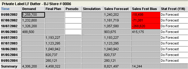

A worksheet table shows series data for the item-location combination that you have currently selected in the view. Depending on how the layout is configured, this may appear as an ordinary table or it may appear as a crosstab; see Levels and Layout Variations.
By default, each row in the table corresponds to a point in time, and each column displays the data for a series. As noted earlier, the table also has a summary row. If the worksheet is in crosstab layout, the table also includes subtotal rows.
The table can show the same series as the graph or a completely different set of series, but usually some of the same series are displayed in both places. To specify where each series is displayed, see Defining the View Layout.
You can edit data in the white cells. The gray cells are computed and not editable. For details on editing data, see Editing Data.
For a given combination and date, the table may display symbols that indicate that a promotion or a note is associated with that combination and date. These indicator symbols are generally displayed for only some of the series, depending on how Oracle Demantra has been configured.

A worksheet graph displays data for the current selection. By default, the horizontal axis shows time, and the vertical axis shows one or more series.
A worksheet view can contain multiple subtabs.
The Notes/Attachments subtab displays notes and attachments related to the selected combination. See Viewing Notes.
The Activity Details subtab displays promotions and the promotion hierarchy. On the left, the Activity Browser displays an expandable tree view of the promotions associated with the currently selected combination. On the right, the Gantt chart displays the promotions associated with the currently selected combination. You can scroll backwards and forwards in time to see the start and end dates of each promotion, and you can zoom in and out in time.
Here you can create, edit, and delete promotions and higher levels in the promotion hierarchy. See the Oracle Demantra Trade Promotion Planning User's Guide.

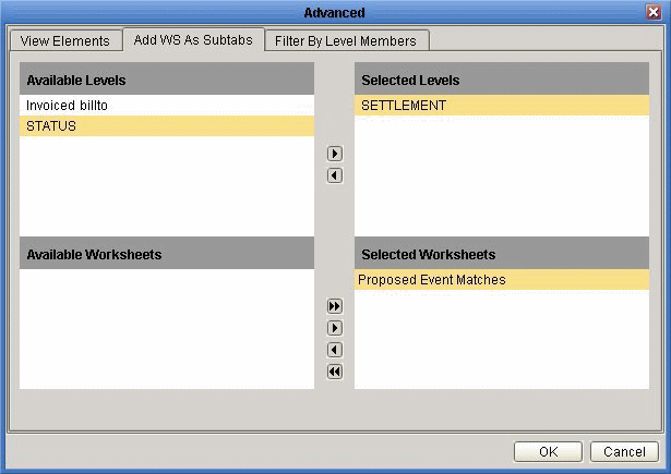

A worksheet can include a subtab that contains a related worksheet. When you select a combination in the worksheet table, the related worksheet shows data associated with that combination. This related worksheet potentially includes different series than the rest of the worksheet and may also be filtered further.

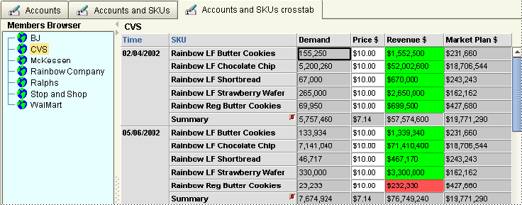

It is also possible to lay out a worksheet so that the members of a level are all displayed at the same time. This format is called a cross-tab layout, and the table (also known as a pivot table) provides a cross tabulation of all the members.
The following figure shows a worksheet table in cross-tab layout, with a row for each SKU member within each time bucket:
Notice that the Members Browser does not include the SKU level, because all SKUs are displayed at the same time.
For another example, the worksheet could instead display the SKU members across the top of the table rather than down the side, as in the following example:

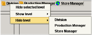

You can turn off (hide) the display of summaries, for example, if you
Want to use a separate view for rollups
Have data that does not summarize meaningfully
Want to save space on your screen
You can hide:
Level and worksheet summaries
Level summaries but display worksheet summaries
Worksheet summaries but display level summaries
The Worksheet Designer does not automatically hide any summaries. You evaluate the worksheet for meaningless and redundant summaries and hide them. It does, however, automatically hide repetitious summaries (summaries that summarize only one entity), for example, a promotion scenario that has only one promotion.
To turn off a summary:
In the Worksheet Designer, open the View' region.
Right-click a level or series and deselect Show Summary

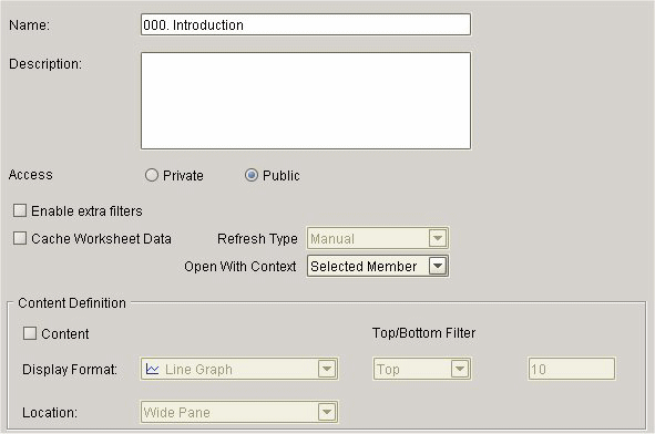

To configure basic information for a worksheet:
Click Worksheet > Display. Or click the Display button.
The system displays a page where you specify the following basic worksheet information:
| Name | The title to use in the My Worksheets module and in the worksheet window title. |
| Description | Provides optional information to display in My Worksheets. This is especially useful in public worksheets for explaining the purpose of the worksheet to other users. |
| Access | Select Private or Public. See Sharing Worksheets and Content Panes.. |
| Enable Extra Filters | This option adds an extra, user-controlled filter to the worksheet. If you select the Enable Extra Filters check box, that means that when you open the worksheet, you can prefilter the data before seeing the worksheet results; this is especially useful for users who use Oracle Demantra Anywhere. Normally when you specify aggregation levels to include in the worksheet (as described in Specifying Aggregation Levels), all members of those levels are available in the worksheet. If you select the Enable Extra Filters check box, that means that when you run the worksheet, Oracle Demantra first prompts you to select the members to display for each level. For an example, see Viewing Data. This option has no effect on content panes. |
| Cache Worksheet Data | Specifies whether Oracle Demantra should cache the data for this worksheet, for each user who works with it. If you cache a worksheet, it will run more quickly in general, but the cache will need to be refreshed periodically. Choose one of the following refresh options: - Manual: You manually refresh the cache. See To refresh your local worksheet cache. - Automatic: Oracle Demantra will automatically refresh the cache, as specified by your implementors. In either case, Oracle Demantra automatically detects when a cache is out of date and behaves appropriately. Oracle Demantra also automatically refreshes the cache when you make certain structural changes to the worksheet. |
| Open With Context | Specifies how this worksheet should be filtered when a user opens it through the Open or Open With menu options (on the right-click menu; see Opening an Item or Location in Another Worksheet). Choose one of the following options:
To display the content of this worksheet in the Demantra Local Application, check Content and then complete the following fields:

A worksheet usually includes aggregation levels. When you use the worksheet, you can examine data for the item-location combinations associated with those levels.
Based on the levels included in a worksheet, Oracle Demantra automatically determines which item-location combinations the worksheet should include. Depending on which combination you select, the worksheet displays series data associated with that combination. For example, if you select one location level (city) and one item level (SKU), the worksheet will contain series data associated with each city-SKU combination. On the other hand, if you select one location level (city) and you do not specify an item level, the worksheet aggregates data for all items. That is, the worksheet will contain series data associated with each city, aggregated for all products.
If you do not specify any aggregation levels in a worksheet, the data is completely aggregated across all items and locations.
If you use a settlement level in a worksheet, you cannot use levels from any other hierarchy in that worksheet.
To specify the aggregation levels in a worksheet
Click Worksheet > Aggregation Levels. Or click the Levels button.
The system displays the Available Levels and Selected Levels lists.
Move all aggregation levels that you want into the Selected Levels list, using any of the techniques in Working with Lists.
Remove any unwanted levels from the Selected Levels list.
The selected levels will now be used on all views of this worksheet, unless you configure the views otherwise; see To specify which levels to use in a worksheet view.
The layout of the worksheet view controls the order in which the levels are used; see Defining the View Layout.
See also:
Using the Advanced Selection Options
Introduction to Levels
Changing the Overall Scale or Unit of Measure
By default, if a worksheet includes a promotion level, the worksheet includes all the following types of combinations:
Combinations that have both sales data and promotions
Combinations that have sales data, but no promotions
Combinations that have promotions, but no sales data
The worksheet displays placeholders for combinations that do not have promotions. For example:
If you move the promotion level to the worksheet axis (see Defining the View Layout), the table will display a similar placeholder.
You can exclude some of these combinations. For example, you might want the worksheet to include only the combinations that have both sales and promotions, as follows:
To exclude combinations with partial data
Make sure that the worksheet includes at least two levels, one of which should be a promotional level.
When you do so, the screen displays an Advanced button in the lower right.
Click Advanced. Oracle displays a dialog box with additional options.
| Include combinations that exist only in Promotion | This option selects combinations that have associated promotions, even if they do not have sales data. |
| Include combinations that exist only in SALES_DATA | This option selects combinations that have sales data, even if they do not have any associated promotions. |
To exclude the combinations you do not want to see, select the check boxes as needed.
See also Specifying Aggregation Levels.

Filters control the combinations that you are able to see. Filtering can have multiple sources:
A given worksheet may be filtered. For example, worksheet X might show only Brand X, which means that the worksheet would show only combinations related to Brand X.
Your user ID may be filtered. For example, if you are an account manager, your user ID might give you access only to your accounts. At any level, you would not be able to see combinations associated with other accounts.
The data that you share with other users (called the component) might also be filtered. Components divide the data for different sets of users.
Oracle Demantra automatically combines all the filters. In the preceding example, if the component is not filtered, if you use worksheet X, you can see only data for Brand X at your accounts.
In contrast to an exception filter (Applying Exception Filters), this type of filter is static and behaves the same no matter how the data changes.

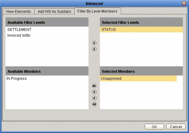

To apply a filter to a worksheet
Click Worksheet > Filters. Or click the Filters button.
The system displays the Available Filter Levels and Selected Filter Levels lists.
You can instruct Worksheet Manager to display the level members on the filter screen either by:
Code
Description
In Business Modeler, set parameter Sort Member by Code in Filter. See Oracle Demantra Implementation Guide.
Find the aggregation level at which you want to filter data and move it from the Available Filter Levels list into the Selected Filter Levels list, using any of the techniques in Working with Lists.
Note: This level does not have to be the same as any of the aggregation levels you display in the worksheet. In fact, typically you filter using a different level than you use to display.
In the Available Members list, find a member that you want to include in the worksheet and move it into the Selected Members list, using any of the techniques in Working with Lists.
At this stage, the worksheet includes only data for this member. (Before you applied a filter at this level, the worksheet could theoretically include any member of this level.)
Continue to move members from the Available Members list into the Selected Members list, until the latter list includes all the members you want.

Depending on how your system has been configured, it might contain a very large number of members. If so, you might want to sort or filter the list or search it. For information, see Managing the Series Lists.
If you attach an exception filter to a worksheet, Oracle Demantra checks the values of the worksheet data and displays only the combinations that meet the exception criteria. In contrast to an explicit filter (Filtering the Worksheet), this type of filter is dynamic and can behave differently as the data changes.
Specifically, you define an exception condition that consists of a series, a comparison operator, and a value, for example:
When you open the worksheet, Oracle Demantra checks each combination in the worksheet. For each combination, if the condition is met for any time in the worksheet date range, Oracle Demantra displays that combination. For example, the worksheet shows combinations that have Sales Plan values greater than or equal to 150000, within the time range included in the worksheet.
Note: Exception filters do not cause filtering in time. If a combination meets the exception criteria, Oracle Demantra displays data for that combination for all time buckets within the time range of the worksheet.
If the condition is not met at any time for any of the worksheet combinations, Oracle Demantra shows the worksheet as empty. That is, if all values in the Sales series are less than 150000 for all combinations, the worksheet comes up empty.
Note: If the worksheet includes a promotion level or a promotion series, the behavior is slightly different. In this case, the Members Browser or dropdown list does initially show all combinations. When you click a combination to display it, the worksheet then checks for exceptions.
You can apply multiple exceptions to a worksheet. When you apply multiple exceptions, you can relate them to each other by using logical AND or logical OR relationships. For example:

To define the layout of a current view
Click Worksheet > Layout Designer. Or click the Layout Designer button.
The system displays a page where you specify the layout. This page displays the following areas:
In addition, this screen displays the following icons:
An icon for each aggregation level that you have included in the worksheet. By default, these levels are included in the Members Browser or selector lists.
An icon that represents the time axis. By default, time is shown on the x-axis.
An icon that represents the series data. Series are shown on the y-axis.
To change the worksheet layout, drag the level or time axis icons to the appropriate areas. You cannot move the series icon.
To specify the type of graph to use, select a graph type from the Graph Type dropdown list.

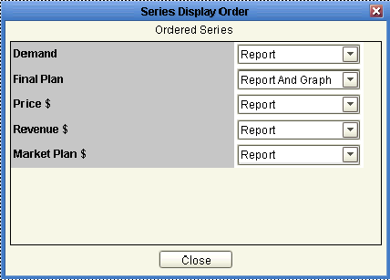

To specify how to display series in this view:
Click the Sort button.
The Layout Designer displays a page that shows the order in which this view currently displays the series. The default order of the series is the order that you added the series.
To hide a series in this view, click the None option in the dropdown list to the right of the series name.
Otherwise, to specify where to display the data for a series, select one of the following options: Table, Graph, Table and Graph.
To move a series up or down in this list, click the series name and drag it up or down. If you want to restore the series to their original order, click the Reset layout button.
When you are done, click Close.
Click Save.
Rerun the worksheet to see your changes. To do so, click Data > Rerun.
To specify a crosstab layout
Drag one or more level icons from the Page Item area to x-axis or y-axis areas.
By default, all levels you include in a worksheet are used on all views of the worksheet. Within a multi-view worksheet, you often hide some of the levels in some views, so that each view is aggregated differently.
Right-click within the Page area of the Layout Designer.
The system displays a menu like the following:
Click Hide level and then click the name of the level to hide.
When you hide a level, the worksheet automatically aggregates data across members of that level.

To revert to the default layout of a worksheet view
Click the tab corresponding to the worksheet view you want to reset.
Click the Reset button.
In the default layout, all selected levels are visible and are on the X axis. Also, all series are displayed in the graph and table according to their default definitions.

For each worksheet view, you can specify which of the basic worksheet elements are included: the table, the graph, and so on.
To specify the elements to include in a worksheet view:
Click the tab corresponding to the worksheet view you want to modify.
Click Advanced... in the lower right.
Oracle Demantra displays the following screen:
For Combination Selector, click either Tree (to display a Members Browser) or Dropdowns (to display dropdown menus instead).
Select the check box next to each element you want to include in this view of the worksheet.
Click OK.
You can display one or more associated worksheets embedded within a subtab. When you select a member in the view, the embedded worksheet is filtered to show just that member. You typically use an embedded worksheet to drill into further detail.
Note: If you use the keyboard to move through the worksheet table, the subtabs are not automatically refreshed, for performance reasons.
For more information, see Level and Worksheet Association: Embedded Worksheets in Oracle Demantra Implementation Guide.
To add an embedded worksheets
Click the tab corresponding to the worksheet view to which you want to add the embedded worksheet.
Oracle Demantra displays the Advanced screen.
Click the Add WS As Subtabs tab.
Oracle Demantra displays a screen like the following:
Depending on the level that you select, the bottom part of the screen shows different worksheets that you can add as an embedded worksheet to this worksheet view.
For Selected Levels, select the level that is associated with the worksheet you want. In general, a worksheet is associated with the levels where it makes sense to use it; this is controlled by your system configuration. You can choose any of the levels that are used in this worksheet.
For Selected Worksheets, select the worksheets that you want to display as embedded worksheets.
Click OK.
For each worksheet view, you can filter the view to show a subset of the data in the worksheet.
To filter a worksheet view
Click the tab corresponding to the worksheet view you want to filter.
Click the Filter By Level Members tab.
For Selected Filter Levels, select the level by which you want to filter this worksheet view. You can choose any of the levels that are used in this worksheet.
For Selected Members, select the level members whose data should be displayed in this worksheet view.
Click OK.
A worksheet or a content pane is either:
Private: Available only to the user who defined it.
Public: Available to the user who defined it and users in the same component as the user who defined it. For example, if you define a public worksheet or content pane in the DM component, all DM component users can view that worksheet or content pane.
In either case, the creator of a worksheet or content pane owns it and:
Anyone can change the displayed data and the layout. They can save those changes to a new worksheet or content pane (Save as... ).
Only the creator can save changes to the worksheet or content pane.
Oracle Demantra prevents users from seeing data for which they do not have permission. See Security chapter inOracle Demantra Implementation Guide..
For:
Worksheets: See also Configuring the Worksheet Basics.
Content panes: See also Configuring the Basics.

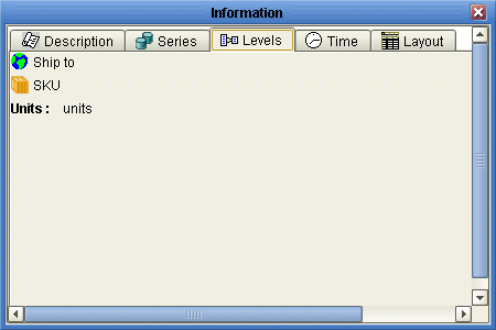

To view the definition of a worksheet
Open the worksheet.
Click Data > Info. Or click the Info button.
Oracle Demantra displays a dialog box that summarizes the definition of a worksheet, for example:
