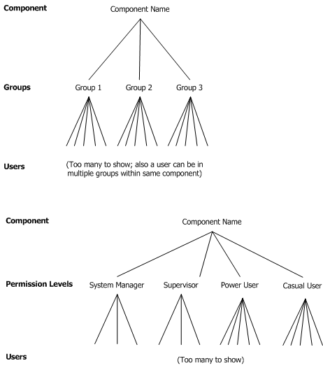

In order to understand how Demantra determines a given user's access to a given menu item, it is necessary to understand the permission hierarchies and how Demantra combines them.
Demantra has two independent permission hierarchies. In the first hierarchy, each component includes groups, and each group includes users. A user can belong to multiple groups, provided that all those groups belong to the same component. In the second hierarchy, each component includes four permission levels, and each user has one permission level.

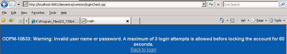

If a user attempts to create a new password that does not follow these policies, a message notifies the user of the password policies.
If the user attempts to login and fails, a message similar to the following appears:

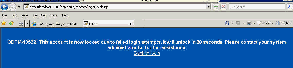

The number of tries allowed by the password policy is determined by the system parameter “AccountLockoutThreshold”. (see System Parameters).
If the user is locked out because of too many failed attempts, the following message appears:
An administrator can unlock the user's account by logging into Business Modeler, navigating to Security > Create/Modify User, and then deselect the Locked check box. If the component owner is locked out, they can log into the Business Modeler and unlock themselves.
If an administrator explicitly locks a user's account, a different message appears, saying that the account is locked and to please contact your system administrator.
