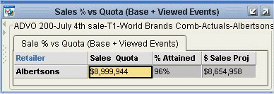

This window shows an analysis of planned sales to sales quota, for the given retailer. This is the total for the retailer. For convenience, the sales projection is also shown.

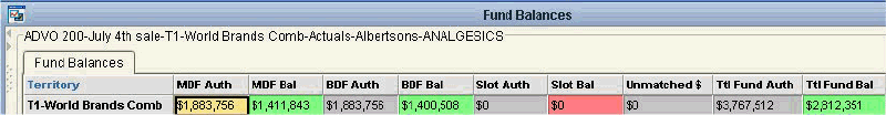

This window provides a detailed overview of authorized funds (MDF, BDF, slotting), spend and fund balances to date, for the given territory. This is the total for the territory.

This window displays the allocated funding for each event in the currently selected scenario. Here you allocate the promotional costs between the MDF and BDF funds.

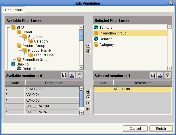

Click Edit below the Population area.
The Edit Population dialog box is displayed.
Usually a promotion is associated with a territory, retailer, category, and promotion group.
To change the territory, retailer, category, or promotion group, click that level name in Selected Filter Levels and change the selection displayed in Selected members.
For example, to associate the promotion with a different promotion group:
In Selected Filter Levels, click Promotion Group.
Then in the Selected members list, double-click the promotion group that you no longer want to use for this promotion. For example, double-click ADVO 100 to remove it from this list.
Then in Available members, double-click the promotion group that should be used. This promotion group is then moved to the Selected members list. For example, double-click ADVO 200 to move it to the Selected members list; now the promotion is associated with ADVO 200 instead of ADVO 100.
Repeat as necessary.
Click Finish to exit this dialog box.

| Sales % vs Quota (Base + Viewed Events) | Sales Quota | Sales quota (revenue) |
| % Attained | Percentage of sales quota attained | |
| $ Sales Proj | Planned sales dollars: actuals plus forecast | |
| Fund Balances | MDF Auth | Authorized market development funds, calculated as follows: (base rate + dev rate)*volume + fixed MDF funds |
| MDF Bal | Remaining market development funds, calculated as the authorized MDF less the spent or committed funds | |
| BDF Auth | Authorized brand development funds+D75 | |
| BDF Bal | Remaining brand development funds, calculated as the authorized BDF less the spent or committed funds | |
| Slot Auth | Authorized slotting funds | |
| Slot Bal | Remaining slotting budget, accounting for the part that has been spent | |
| Unmatched $ | Trade spend not yet matched to a promotion. | |
| Ttl Fund Auth | Total authorized spending, including MDF, BDF, and slotting | |
| Ttl Fund Bal | Remainder of total authorized spending, after accounting for spending | |
