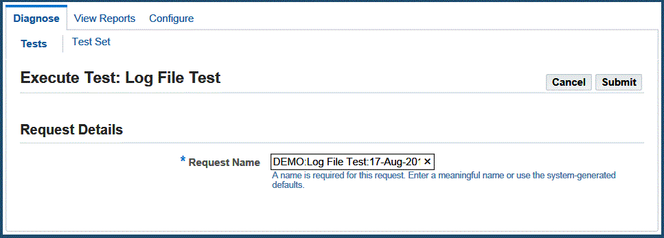

Execute a test using the Execute Test page.
You can choose to accept the defaulted request name or enter another request name.
You can check the Generate downloadable report box if you want a downloadable report. This check box does not appear for legacy tests where HTML is the only supported format.
If the Generate downloadable report box is checked, select the download format from the list. If the test requires Inputs this page prompts you to enter the input parameters.
Click the Cancel button to cancel the execution of a test.
Click the Submit button to execute the test.

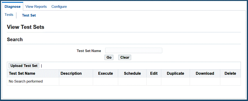

View information on your test sets with the View Test Sets page.
You can search for a test set by entering a specific Test Set Name or by entering part of a Test Set Name with a wild character as prefix or a suffix.
The results region includes the following:
Test Set Name - the user-entered test set name.
Description - the user-entered description of the test set.
Click on the Execute icon to submit a Test Set.
Click on the Schedule icon to schedule a Test Set.
Click on the pencil icon to edit a Test Set.
Click on the Duplicate icon to copy a Test Set.
Click on the Download icon to save a Test Set to a local file system.
Click on the Trash Can icon to delete a Test Set.
Click on the Upload Test Set button to upload a test set from a local file system into the database.
You can upload a test set using the Upload Test Set page.
Click on the Browse button to search for the test set in your local file system. Once you select the test set, you can upload it to the Diagnostics database so it will be available for execution.
Click on the Upload button to save the test set from a local file system into the database
Click on the Cancel button to return to View Test Set page.

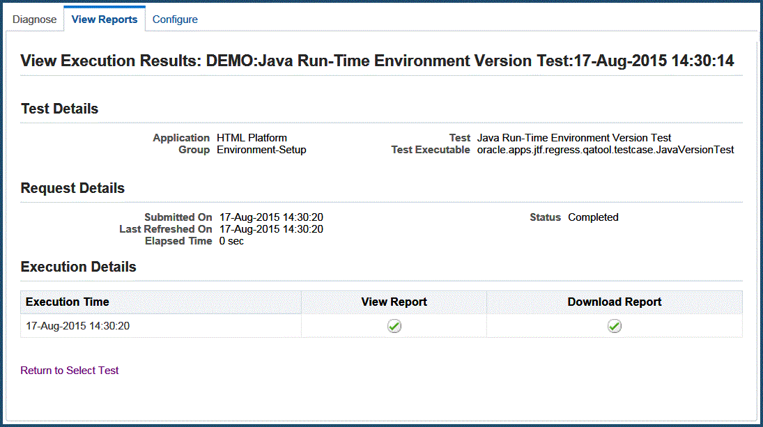

View test results using this page.
The View Execution Results page shows the Request Name initially after the test or test set is executed, or if the page was navigated to from a search using the request name.
The Test Details region includes:
Application - the application name associated with the test
Test - the name of the test
Group - the name of the group the test is associated with
Test Executable - the name of the test executable
After a request is submitted, the Request Details region is included on this page. This region includes:
Submitted On - the date and time the test was submitted.
Status - the current status of test (Running, Completed).
Last Refreshed On - the date and time when the page was refreshed for the last time.
Elapsed Time - Time elapsed since the test has been submitted for execution until the request/page has been last refreshed.
Execution Details region includes:
Execution Time - the date and time the test was executed.
View Report - shows a check mark if the report is available to view, shows a clock if the test is still executing, or shows an 'X' meaning the test completed with warnings and/or errors. Once the report is available to view, you can click on the check or 'X' icon to get details.
Download Report - shows a check mark if the report is available to download, shows a clock if the test is still being formatted for download, or shows an 'X' meaning no downloadable report available. Once the report is available to download, you can click on the check icon to download it.

Group - the name of the group with which the test is associated.
Result - the result of the diagnostic test, that is, success or failure.
Test - the name of the test.
Time Taken - the total elapsed time for the test execution.
Date - the date and time the test was executed.
Test Class Version - the version of the test.
The Inputs region lists all of the input parameters used to execute the test.
The Report region shows all details of the report.
The Return to Execution Results link returns you back to the View Reports page.
Use the Download Report button to download the report to your local PC. If the report generation is still in progress, a Refresh button appears instead. Refresh the page to check the report generation status.
Use the Upload to Support button to upload the report to Oracle Support. You will be prompted to enter a My Oracle Support Service Request Number and to upload the downloaded report from your PC.

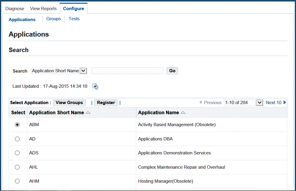

Use these pages to configure your Oracle E-Business Suite Diagnostics tests:
You can view all the applications registered under Oracle E-Business Suite Diagnostics in this page.
Search can be conducted based on application short name or application name.
Select an application and click on the View Groups button to view the groups under each application.
Click the Register button to register any new application. This action is restricted to only those users who have configuration privileges.
You can register a new application in this page. The list of unregistered applications will be displayed in the list of values.
Click the Apply button to register a new application.
You can click the Cancel button to cancel registering application.

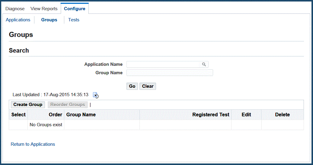

You can view all the groups registered under an application using this page.
If you have come to this page from the View Registered Applications page, then the selected application will be shown in the LOV field.
Alternatively, you can come directly to this page through the Groups subtab.
A search can be conducted using the application name and group name. If the group name is left blank all the groups under the application will be displayed.
Details shown include the number of registered test under each group.
Click on the Update icon to update the details of the group. This action is restricted to only those users who have configuration privileges.
Click on the Delete icon to delete the group. This action is restricted to only those users who have configuration privileges
Click on the Reorder button to change the order in which the groups are organized under the parent application. This action is restricted to only those users who have configuration privileges.
Click on the Create Group button to create a new group. This action is restricted to only those users who have configuration privileges.
Click on the View Tests button to view all the tests registered under this group.
Note: Seeded groups cannot be edited or deleted by end users.

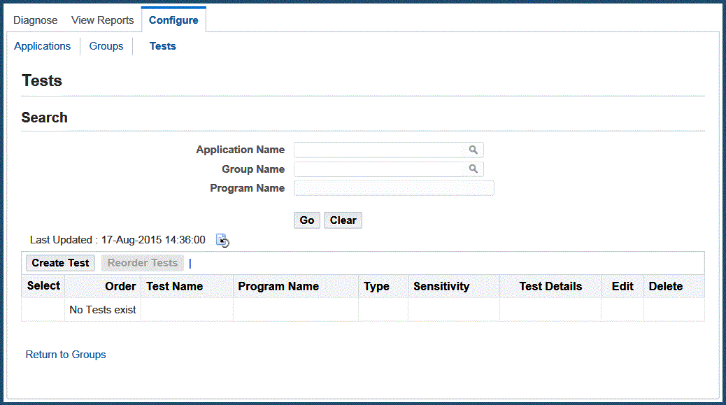

You can view all the tests registered under a group.
If you have navigated to this page from the View Groups page, then the selected application and group will be shown in the LOV field.
You can directly navigate to this page through the Tests subtab.
A search can be conducted using the Application name and Group name. If the program name field is left blank, then all the program names under the group will be displayed.
Click on the View Input values button to view current input values and to add additional rows. This button will be enabled only if the user has permission to execute the test.
Click on the Create Test button to create a new test. This action is restricted to only those users who have configuration privileges.
Click on the Reorder Tests button to change the order in which the tests are organized under the group. This action is restricted to only those users who have configuration privileges.
Details shown include:
Tests under the specific group.
Radio button to view input values for tests with inputs.
Order indicates the test sequence number within a group.
The user-friendly test name.
The program name associated with the test.
The test type; either Java, PL/SQL or XML.
The sensitivity associated to a specific test.
The following are actions that are restricted to only those users with configuration privileges.
Click on the eyeglasses icon to view test details.
Click on the pencil icon to edit a test.
Click on the Delete icon to delete the test.
Note: Seeded tests cannot be edited or deleted by end users.
The name of the application for which the test is registered.
The name of the group for which the test is registered.
The program name associated with the registered test.
The test type; either Java, PL/SQL, or XML.
The sensitivity associated with the specific test.
The order indicates the test sequence number within a group.
The end date of the test.
In addition, the following information is shown:
Valid applications for the registered test, listed by application short name and application name.
You can view or add input values using this page.
Name of the application for which the test is registered.
Group for which the test is registered.
Registered test name.
Program name associated with the registered test.
Click on the Add another row button to add additional inputs.
Click on the Remove button to delete configured inputs.
Click on the Cancel button to cancel any changes.
Click on the Apply button to save your changes.

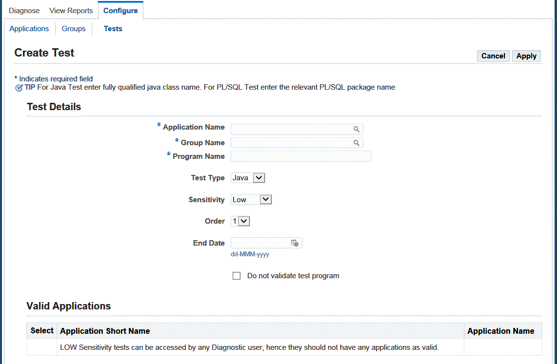

Create diagnostic tests using this page.
Select the Application Name using the LOV.
You can change the Group Name using the LOV.
Enter a Program Name:
For a Java Test by entering the fully-qualified Java class name.
For a PL/SQL Test, the package must be in the APPS schema.
For an XML Test, the XML file must reside in the JAVA_TOP in the corresponding product folder. Example:
oracle/apps/fnd/oam/diagnostics/tests/sampleXMLTest.xml
Note: This placement is similar to that for registering a Java test except the forward slash (/) must be used as the separator.
Select the Test Type that matches the corresponding program name. Valid test types are Java, PL/SQL, or XML.
You can optionally check the Do Not Validate test program box. If checked, the framework will not try to validate the executable; otherwise the framework will try to load the test and see if it is adhering to diagnostics standards.
Select the Sensitivity Type of low, medium, or high depending on the sensitivity of a test.
You can optionally specify an End Date for your test.
You can accept the default order test sequence number or select a previously-used order test sequence number.
Click on the Cancel button to cancel your changes.
The following fields are shown:
The registered test name.
The type of test: PL/SQL, Java, XML, or Declarative.
Click on Sensitivity in the action list to change the security sensitivity of the test.
Click on Order in the action list to change the order of the test within the group.
Optionally update the End Date value.
