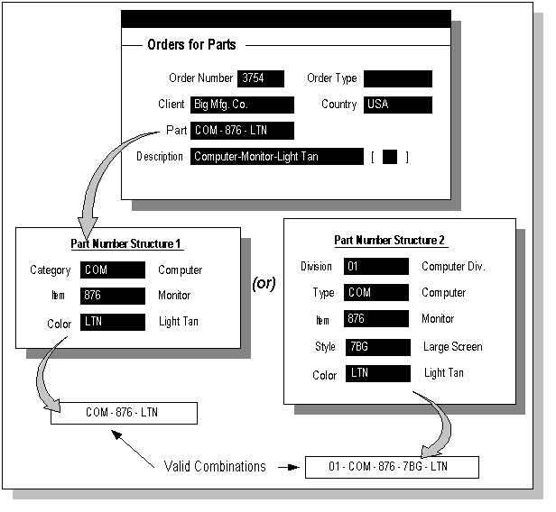

Planning your Key Flexfield
Combination
A combination is a particular complete code, or combination of segment values that makes up the code, that uniquely identifies an object. For example, each part number would be a single combination, such as PAD-YEL-11x14 or 01-COM-876-7BG-LTN (where the dash "-" is the segment separator). If you had ten parts you would define ten combinations. A valid combination is simply an existing or new combination that can currently be used (that is, it is not out of date, is not disabled, and does not violate cross-validation or security rules). A combination would have different segments depending on the flexfield structure being used for that combination. Any combination is associated with only one particular flexfield structure (arrangement of segments).
Note that many of the Oracle E-Business Suite products (and their documentation) do not necessarily refer to key flexfield combinations as "combinations". They may refer to combinations using the name of the entity or the key flexfield itself. For example, Oracle Assets uses a key flexfield called the "Asset Key Flexfield" and refers to one of its combinations as "an asset key" or "an asset key flexfield". In another example, Oracle General Ledger and other Oracle E-Business Suite products generally use the term "account" or "GL account" to refer to combinations of the Accounting Flexfield.
Example of a Combination

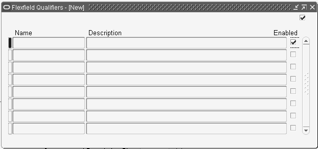

Qualifiers
Flexfield Qualifier
A flexfield qualifier identifies a particular segment of a key flexfield.
Usually an application needs some method of identifying a particular segment for some application purpose such as security or computations. However, since a key flexfield can be customized so that segments appear in any order with any prompts, the application needs a mechanism other than the segment name or segment order to use for segment identification. Flexfield qualifiers serve this purpose. You can think of a flexfield qualifier as an "identification tag" for a segment.
Examples of Qualifiers
the picture is described in the document text
For example, your Oracle General Ledger product needs to be able to identify which segment in the Accounting Flexfield contains balancing information and which segment contains natural account information. Since you can customize the Accounting Flexfield so that segments appear in any order with any prompts, Oracle General Ledger needs the flexfield qualifier to determine which segment you are using for natural account information. When you define your Accounting Flexfield, you must specify which flexfield qualifiers apply to which segments.
Other applications, such as Oracle Human Resources, also use flexfield qualifiers. Oracle Human Resources uses flexfield qualifiers to control who has access to confidential information in flexfield segments.
A segment qualifier identifies a particular type of value in a single segment of a key flexfield. In the Oracle E-Business Suite, only the Accounting Flexfield uses segment qualifiers. You can think of a segment qualifier as an "identification tag" for a value. In the Accounting Flexfield, segment qualifiers can identify the account type for a natural account segment value, and determine whether detail posting or budgeting are allowed for a particular value.
It is easy to confuse the two types of qualifiers. You should think of a flexfield qualifier as something the whole flexfield uses to tag its pieces, and you can think of a segment qualifier as something the segment uses to tag its values.

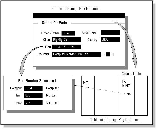

Foreign key form
A foreign key form is a form whose underlying base table contains only one or two columns that contain key flexfield information, and those columns are foreign key columns to the combinations table (usually a foreign key to the CCID column of the combinations table and sometimes a structure ID column as well). The purpose of a foreign key form often has very little to do with the key flexfield itself, and that the key flexfield appears on the form is essentially incidental. For example, if you have a key flexfield that represents a part number, you would use the combinations form to define new parts and maintain existing part numbers. You would then have many foreign key forms that you use to manipulate your parts. You might have a form where you take orders for parts, another form where you receive parts, and yet another form where you ship parts. The fact that your part number happens to be a key flexfield is not important to your taking orders for your parts, for example.
Example of a foreign key form

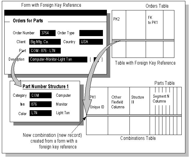

Dynamic Insertion
Dynamic insertion is the insertion of a new valid combination into a combinations table from a form other than the combinations form. If you allow dynamic inserts when you set up your key flexfield, a user can enter a new combination of segment values using the flexfield window from a foreign key form. Assuming that the new combination satisfies any existing cross-validation rules, the flexfield inserts the new combination into the combinations table, even though the combinations table is not the underlying table for the foreign key form.
For some key flexfields, dynamic inserts may not be allowed. Sometimes it may not make sense for an application to allow a user to be able to create a new combination from any form other than the combinations form. For example, a user should not be able to create a new part while taking an order for parts using an Enter Orders form; the application should restrict the creation of new part numbers to authorized users using a Create Parts form.
Dynamic inserts may not be technically possible for some key flexfields. If the combinations table contains mandatory columns that are not maintained by the flexfield, dynamic inserts would not be possible. If the combinations table contains mandatory non-flexfield columns, such as a "unit of measure" column, the flexfield would not be able to complete the entire row in the combinations table from the foreign key form (because the base table of the foreign key form is not the combinations table). The flexfield does maintain the CCID column.
Generally there is only one, if any, combinations form for a given key flexfield. In some applications, there may not be a combinations form. In these cases, you would use dynamic inserts to create new combinations.
Note: For details on dynamic insertion for a particular flexfield, refer to the Oracle [Product] User's Guide of the owning application.
Dynamic insertion can be enabled for a key flexfield in the Register Key Flexfields form, in the Segments form, and in the key flexfield definition when defined in a given form.

Your first step in planning your key flexfields is to determine which key flexfields your Oracle E-Business Suite product requires. You should also determine the purpose of the key flexfield, as well as the number and length of its available segment columns (See: Key Flexfields in Oracle E-Business Suite). You should also note whether your key flexfield allows more than one structure, and determine if you do indeed need to define more than one structure. For example, the System Items Flexfield (Item Flexfield) supports only one structure.
Note: You can determine whether a key flexfield allows more than one structure, as well as other information on the key flexfield, in the Register Key Flexfield form. See the Oracle E-Business Suite Developer's Guide for more information.
Those key flexfields that allow multiple structures may use different mechanisms to determine which structure a user sees. For example, the Accounting Flexfield uses multiple structures if you have multiple sets of books with differing charts of accounts. Your forms determine which Accounting Flexfield structure to display by using the value of the GL_SET_OF_BOOKS_ID profile option associated with your current responsibility. Other key flexfields may have a field built into the form that allow a user to essentially choose which structure appears. See: Key Flexfields in Oracle E-Business Suite.
You should decide on the number, order and length of your segments for each structure. You must also choose how to validate each segment. See: Overview of Values and Value Sets.

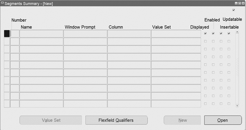

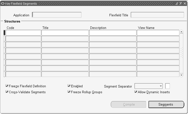

Key Flexfield Segments Window
Key Flexfields Segments Window
Segments Summary Window
Use these windows to define the your key flexfield structure.

Defining Key Flexfield Structures
Before defining your key flexfield structures, use the Value Sets window to define any value sets you need. See: Value Set Windows
Perform the following steps to define your key flexfield structure.
  1. Navigate to the Key Flexfield Segments window.
  2. Select the application name and title of the key flexfield you want to define. You cannot create a new flexfield or change the name of an existing flexfield using this window.
  3. For those application flexfields that support more than one structure (such as the multiple charts of accounts in the Accounting Flexfield), you can create a new structure for your flexfield by inserting a row. If you are defining the first structure for your flexfield, select the default flexfield structure that appears automatically. If you are modifying an existing structure, use your cursor keys to select the title of the flexfield structure you want.
    You can change the title of an existing flexfield structure by typing in a new title over the old title. You see this name when you choose a flexfield structure and as the window title in your key flexfield (unless the flexfield is used for a specific purpose such as "Consolidation Account", in which case the structure title does not appear in the flexfield window).
    The code for a structure is a developer key and is used by loader programs. The value you specify for the code will default into the title field.
    If you upgraded, the codes for your structures were created from your structure titles during the upgrade.
  4. If you want to generate a database view for this structure, enter a view name. Your view name should begin with a letter and must not contain any characters other than letters, numbers, or underscores ( _ ). Your view name must not contain any spaces. See: Overview of Flexfield Views.
  5. Check the Enabled check box so that this structure may be used in your key flexfield. You cannot delete structures from this window because they are referenced elsewhere in the system, but you can disable them at any time. A structure must be enabled before it can be used.
    You should enable at least one structure for each key flexfield. If you disable a structure that already contains data, you will not be able to query up the existing data or create new combinations.
  6. Select the character you want to use to separate your flexfield segment values or descriptions. This separator will appear whenever your application forms display concatenated segment values or descriptions.
    You should choose your separator character carefully so that it does not conflict with your flexfield data. For example, if your data frequently contains periods ( . ) in monetary or numeric values, you should not use a period as your segment separator.
    It is recommended that you do not use a character as your segment separator if you expect that character to appear frequently in your segment values or descriptions.
    If you do use a character that appears in your segment values or descriptions, then that character will be preceded by a backslash (\) when it appears in a value or a description. Also, when users use the Query Find feature, they will need to precede the character in the segment values with a backslash. A backslash in your values will be preceded by another backslash.
    Note: Do not use a backslash as your segment separator.
    For example, say the segment separator is a period (.) and your values contain periods also. The table below illustrates how the segment values would appear in the combination.
    Examples of Concatenated Segments where Segment Values Contain the Segment Character
    Segment Values Concatenated Segments as Combination
    "1.2", "34", "5.6" "1\.2.34.5\.6"
    "1", "2.34", "5.6" "1.2\.34.5\.6"
    "1\.2", "34\.5", "6" "1\\.2.34\\.5.6"
    Warning: Some Oracle E-Business Suite tables store the segment separator as part of your flexfield values. Changing your separator once you have data in such tables may invalidate that data and cause application errors.
  7. Select the Cross-Validate Segments check box if you want to cross-validate multiple segments using cross-validation rules. You can define cross-validation rules to describe valid combinations using the Cross-Validation Rules form. Uncheck the box if you want to disable any existing cross-validation rules. See: Cross-Validation Rules.
  8. Indicate whether you want to freeze your rollup group definitions. If you do, you prevent users from modifying rollup groups using the Segment Values form.
    You can freeze rollup groups before or after you define your flexfield structure. See: Segment Values.
  9. If you want to allow dynamic inserts, check the Allow Dynamic Inserts check box. You would allow dynamic inserts of new valid combinations into your generic combinations table if you want users to create new combinations from windows that do not use your combinations table. You should prevent dynamic inserts if you want to enter new valid combinations only from a single application window you create to maintain your specific combinations table.
    You can update this field only if your application flexfield has been built to allow dynamic inserts, and the flexfield has been defined in the Register Key Flexfields form with Dynamic Inserts Feasible checked. Otherwise this field is display only.
  10. Choose the Segments button to open the Segments Summary window, and define your flexfield segments. See: Defining Segments.
  11. Save your changes.
  12. Freeze your flexfield structure by checking the Freeze Flexfield Definition check box.
    Do not freeze your flexfield if you want to set up or modify your flexfield segments or change the appearance of your key flexfield window. You cannot make most changes while your flexfield is frozen.
  13. Compile your frozen flexfield by choosing the Compile button. Your changes are saved automatically when you compile.
You must freeze and compile your flexfield definition before you can use your flexfield. If you have more than one flexfield structure, you must freeze, save, and compile each structure separately. If you decide to make changes to your flexfield definition, make sure that you freeze and save your flexfield definition again after making your changes.
Warning: Do not modify a frozen flexfield definition if existing data could be invalidated. An alteration of the flexfield structure once you have any flexfield data can create serious data inconsistencies. Changing your existing structures may also adversely affect the behavior of any cross-validation rules or shorthand aliases you have for your structures, so you should be sure to manually disable or redefine any cross-validation rules and shorthand aliases to reflect your changed structures.
Note: When a flexfield is compiled, the system checks segment names to ensure that they follow the Segment Naming Conventions. If they do not follow these rules, you will get a Warning message.
Once a flexfield is compiled, a concurrent request is submitted to generate database views using the defined segment names. These database views enable simpler custom reporting on flexfields data. The generation of these views require that these segment naming conventions be followed.

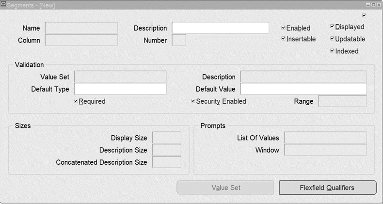

Defining Segments
Segments Window
Use the Segments window to define segments for your flexfield. The window title includes the current flexfield's name. If your flexfield definition is frozen (that is, the Freeze Flexfield Definition check box is checked), this window becomes display-only.

To define segments, perform the following steps.
  1. Enter a name for the segment that you want to define.
    Your segment name should begin with a letter and use only letters, numbers, spaces or underscores ( _ ). The segment prompts get their default values from this field. The flexfield view generator will use your segment name as a column name and change all spaces and special characters to underscores (_). See: Segment Naming Conventions.
    Note: If the name you enter violates the segment naming conventions, you will get an error message.
  2. Select the name of the column you want to use for your flexfield segment.
    Tip: If you are defining more than one segment in the same structure at one time, ensure that you use unique columns for each segment. If you attempt to use a single column for more than one segment in the same structure, you cannot save your changes or compile your structure. Columns you choose for your segments do not disappear from your list of values until you save your work.
  3. Enter the segment number for this segment.
    This number indicates the relative position in which this segment appears in a flexfield window. A segment with a lower segment number appears before a segment with a higher segment number. Dependent segments should occur after the segment they depend upon in the flexfield window.
    You receive a warning message if you enter a segment number that is already defined for your flexfield. This warning is only a reminder that the segment number is in use. If you attempt to freeze a flexfield in which two segments share the same segment number, the flexfield does not compile.
    Tip: For most flexfields, if you give your segments widely spaced numbers (such as 10, 20, 30...) to indicate their relative positions, you can add segments to your structure more easily. Adding segments still disables all your existing cross-validation rules and shorthand aliases for this flexfield structure, however. Note that the Accounting Flexfield requires consecutive segment numbers beginning with 1 (such as 1, 2, 3, ...).
    Warning: Changing the order of your segments invalidates all existing cross-validation rules and shorthand aliases for this flexfield structure.
  4. Indicate that you can use this flexfield segment by checking the Enabled check box.
    Your flexfield does not display disabled segments. You can define as many segments as there are defined segment columns in your key flexfield combinations table.
    Warning: All disabled segments can be reset to null and reused.
    To protect the integrity of your data, you should not disable a segment if you have already used it to enter data.
  5. Indicate whether you want this segment to appear in the flexfield window using the Displayed check box. If your segment is not displayed, you should provide a default type and value so that the user does not need to enter a value for this segment. If you do not display a segment but also do not provide a default value for it, your users may see error messages when using this flexfield.
    Warning: If you are defining the Accounting Flexfield, you must display all segments. Hiding segments will adversely affect your application features such as Mass Allocations.
  6. Indicate whether users can insert values into the segment using the Insertable check box. By default, the Insertable check box is checked. This control is for flexfields using the Oracle Forms user interface only, and this control can be overridden by grants created using the Flexfield Segment Security Wizard. For more information on that wizard, see: Flexfield Segment Security Wizard.
  7. Indicate whether users can update values into the segment using the Updatable check box. By default, the Updatable check box is checked. This control is for flexfields using the Oracle Forms user interface only, and this control can be overridden by grants created using the Flexfield Segment Security Wizard. For more information on that wizard, see: Flexfield Segment Security Wizard.
  8. If you are defining the Accounting Flexfield, decide whether you should check the Indexed check box. For details on the Accounting Flexfield, see the Oracle General Ledger Implementation Guide. If you are defining any other Oracle E-Business Suite (key) flexfield, you can skip the Indexed check box.
    The Oracle General Ledger applications use the Indexed field for the Optimization feature. What you enter here does not affect Oracle E-Business Suite key flexfields other than the Accounting Flexfield, but the value may or may not affect key flexfields in custom applications (depending on whether those applications have logic that uses the value of this field).
    Indicate whether you want the database column in the combinations table used to store this key segment to have a single-column index. You should create indexes on segments you expect to have many distinct values (instead of just a few distinct values). The Oracle General Ledger products' Optimizer does not drop existing indexes. See the Oracle General Ledger documentation for more information.
    If you set up a new structure of the same flexfield, this value defaults to the value in the first structure you set up.
  9. Enter the name of the value set you want your flexfield to use to validate this segment. See: Choosing Your Value Set.
  10. Indicate whether you want to require a value for this segment. If you do, users must enter a value before leaving the flexfield window. If not, the segment is optional.
    Important: All segments in your Accounting Flexfield must be required.
    If this segment is required but depends on an optional segment, then this segment will become optional if a user leaves the depended-upon segment blank.
  11. Indicate whether to allow security rules to be used for this segment. Otherwise any defined security rules are disabled.
    If the value set for this segment does not allow security rules, then this field is display only.
  12. If you want your flexfield to validate your segment value against the value of another segment in this structure, then choose either Low or High in the Range field. Segments with a range type of Low must appear before segments with a range type of High (the low segment must have a lower number than the high segment). For example, if you plan two segments named "Start Date" and "End Date," you may want to require users to enter an end date later than the start date. You could have "Start Date" be Low and "End Date" be High. In this example, the segment you name "Start Date" must appear before the segment you name "End Date," or you cannot compile your flexfield.
    If you choose Low for one segment, you must also choose High for another segment in that structure (and vice versa). Otherwise you cannot compile your flexfield.
    If your value set is of the type Pair, this field is display only, and the value defaults to Pair.
  13. Enter the display size and prompt information for the segment. See: Segment Prompts and Display Lengths.

Flexfield Qualifiers
Flexfield Qualifiers Window
Use this window to apply flexfield qualifiers to your key flexfield segments. The window title includes the current flexfield and segment names.
For each qualifier, indicate whether it is enabled for your key flexfield segment.
Since you can set up your key flexfields in any way you prefer, Oracle E-Business Suite products use flexfield qualifiers to identify certain segments used for specific purposes. You should consult the help for your key flexfield to determine whether your key flexfield uses qualifiers and what purposes they serve.
Some qualifiers must be unique, and you cannot compile your flexfield if you apply that qualifier to two or more segments. Other qualifiers are required, and you cannot compile your flexfield until you apply that qualifier to at least one segment.
You should consult the Key Flexfields in Oracle E-Business Suite section for your key flexfield to determine whether your key flexfield uses qualifiers and what purposes they serve.
