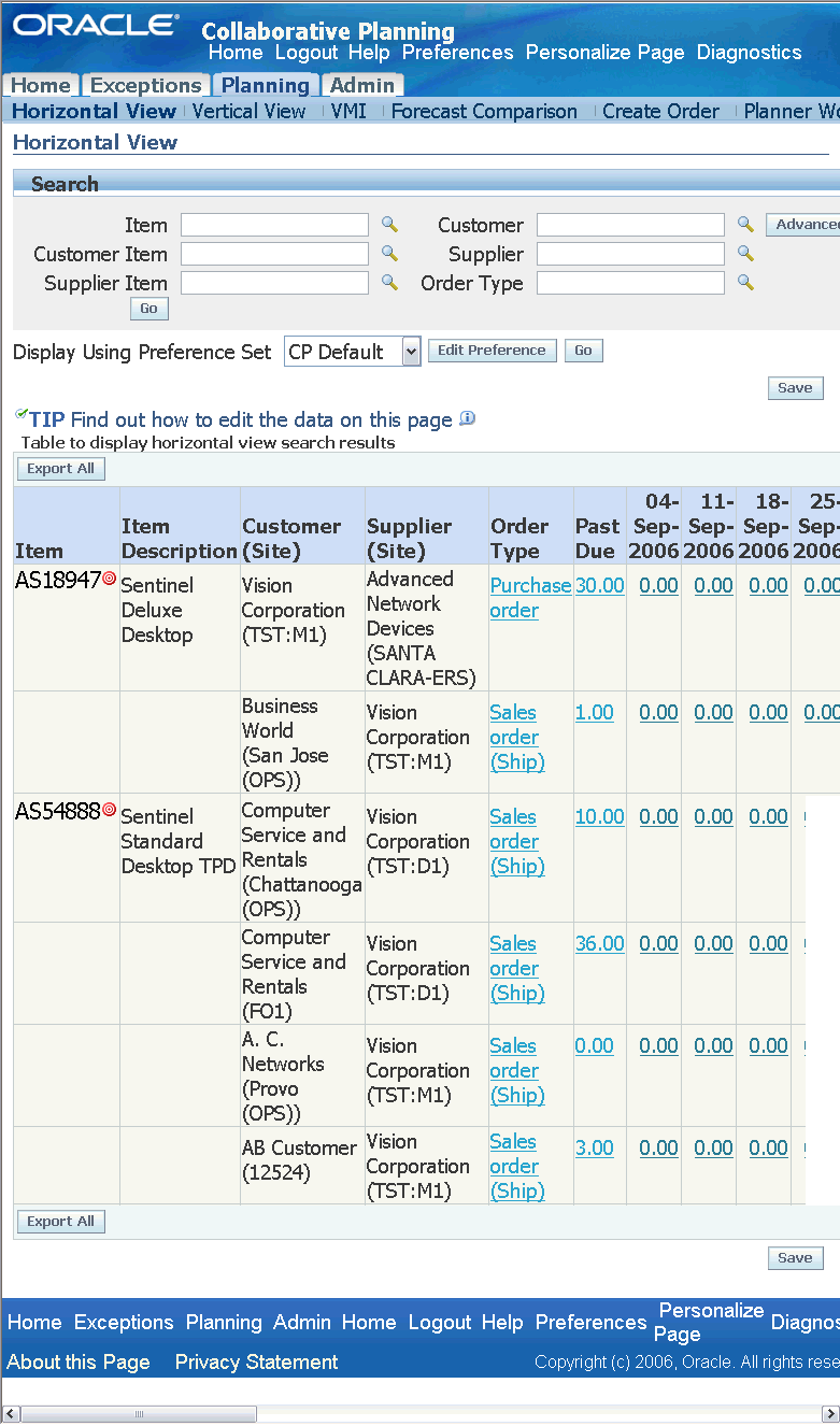

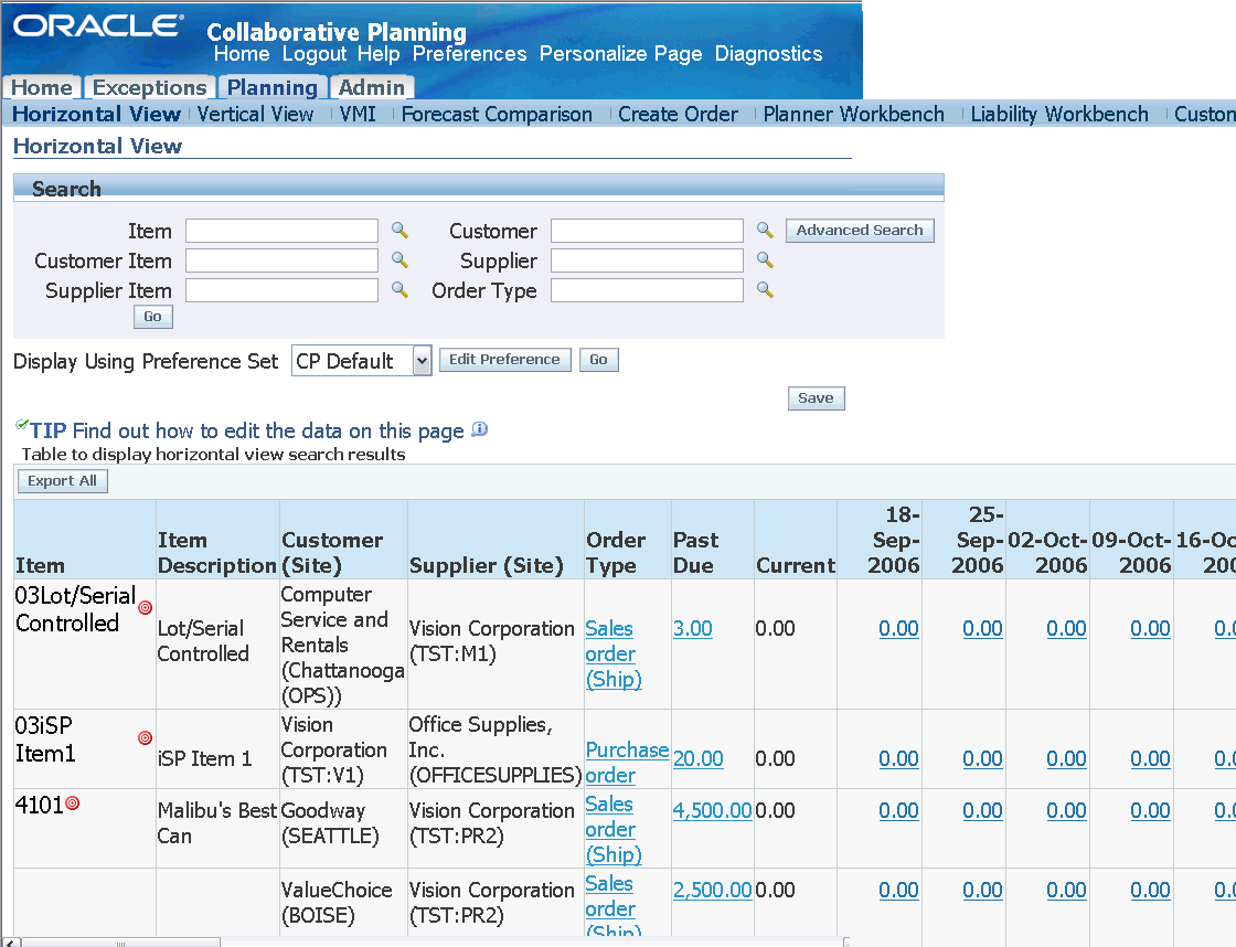

The seeded horizontal view enables you to view supply and demand information over time. In order to use the horizontal view, you must create a preference set.

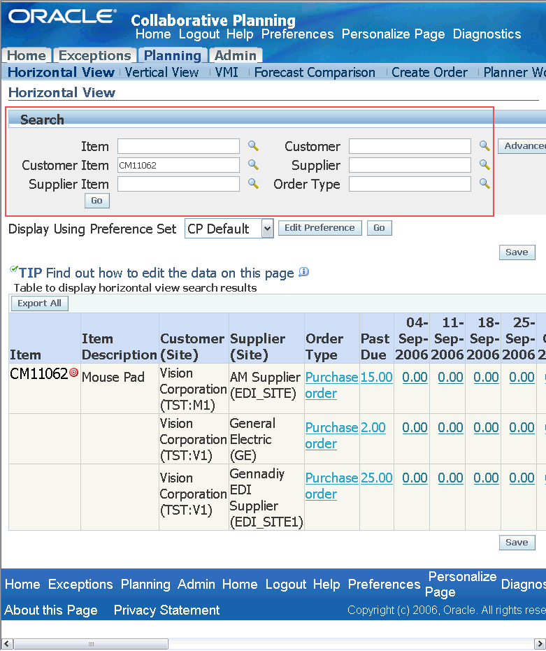

You can find a customer, supplier, item, or order in the Search region of the Horizontal View screen. Complete the following steps to filter records based on search criteria:
From the Home page of Oracle Collaborative Planning, select the Planning tab.
On the Planning page, select Horizontal View. Alternatively, you can select Horizontal View under the Planning category in the right-hand list on the Collaborative Planning Home page.
In the Search region, enter your search criteria and select Go.
The following example depicts the Search region in the Horizontal View and the search results for the customer item CM11062.
The Horizontal View Screen

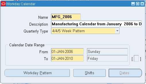

Create a workday calendar in the Workday Calendar window. Use the following navigation path to open the Workday Calendar window:
Navigator > Bills Of Materials > Setup > Calendars
Workday Calendar Window

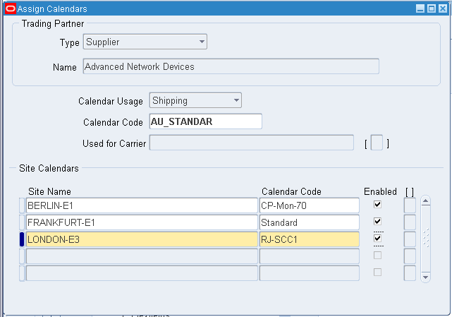

Note: You can also access workday calendars through Oracle Order Management. Use the following navigation path to open the Workday Calendar window: Navigator > Order Management > Setup > Shipping > Calendars > Enter
Select the role of the trading partner (Supplier, Customer, Organization, or Carrier) and assign the workday calendar to the trading partner in the Assign Calendars window. Use the following navigation path to open the Assign Calendars window:
Navigator > Order Management > Setup > Shipping > Calendars > Assign
Assign Calendars Window
Note that a calendar must be created and defined in the Oracle Bills of Material (BOM) or Oracle Order Management application as a Workday calendar before it can be assigned to a shipper, receiver, or carrier. If the receiving calendar is not defined, the delivery calendar, manufacturing calendar, or the shipping calendar of the supplier site or the supplier organization is used. If none of these calendars is available, Collaborative Planning uses the default system calendar.
For more information on assigning calendars to trading partners, see "Defining Transportation Calendars" in Oracle Order Management Implementation Manual.

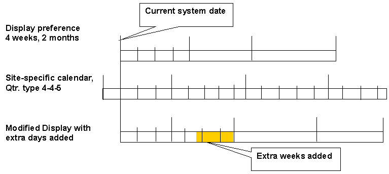

You can specify a time horizon to display order information in Horizontal View preference sets. You can specify a single time bucket such as day or a combination of multiple time buckets. For more information on creating preference sets, see "Preference Sets."
The start day of a site-specific week and a site-specific month are always the same. Unlike a manufacturing calendar, the start day on a site-specific calendar does not consider a working day or non-working day specification.

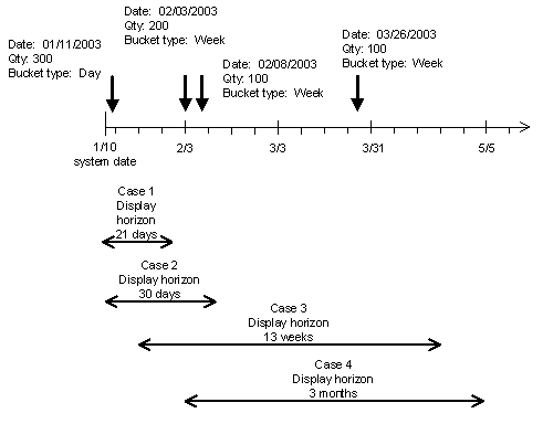

The system stores the order at the daily, weekly, or monthly level, depending on the following bucket types:
Time bucket specification: Day
System considers the calendar date specified on the order to be its due/availability date.
Time bucket specification: Week
System considers the order to be due/available in the week that includes the calendar date specified on the order. Note that the definition of week is derived from the site-specific calendar.
Time bucket specification: Month
System considers the order to be due/available in the month that includes the calendar date specified on the order. Note that the definition of month is derived from the site-specific calendar.
The system retrieves the number of days between order receipt date and the order end date (based on the bucket type) and then spreads the order quantities equally among these days.
The system collects the orders and buckets them based on either the ship date or the receipt date of the order. The rules for bucketing are as follows:
For transactions between the OEM organization and a supplier, the due date is the receipt date at the OEM organization's dock.
For transactions between the OEM organization and a customer, it is the ship date from the OEM organization's dock if the customer controls outbound logistics (for most order types).
The receipt date is considered as the due date at the customer's dock if the OEM organization controls outbound logistics.
For ASN, Shipment Receipt, Shipment In Receiving order types, the receipt date is always considered as the due date.
For Sales forecast and sell-through forecasts, the ship date is always considered as the due date.

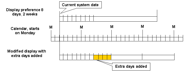

First bucket displayed is Day
Combinations 1 to 4 have Day as the first time bucket. In this case, the default start date of the Horizontal View is always the system date. For example, if the first bucket is Day and the system date is January 1, 2003, then the first bucket in the Horizontal View begins with 01-January-2003. The system will summarize and display all records that fall on this day in the Horizontal View.

As different customer sites may use different site-specific calendars, the system may find data for two sites with different site-specific definitions while retrieving information based on a query. In this situation, a single customer site displays against the Collaborative Planning default system calendar instead of against the customer site's calendar. The following example explains this situation.
| Calendar Type | Quarterly Pattern | Week/Month Start Day | |
| Collaborative Planning system | Default calendar | (4-4-5) | Monday |
| Customer site 1 | Receiving calendar | (5-4-4) | Monday |
| Customer site 2 | Receiving calendar | (4-4-5) | Monday |

To understand the transition better, consider the following example, which is illustrated by this diagram:
Assume that you have the following time bucketing preferences:
Week start day: Monday.
Current system date: 31-Jan-2004, Saturday.
Your display preference: 8 days, 2 weeks, 0 months.
In this situation, the last day bucket falls on Sunday, 8-Feb-2004. Therefore, the two weekly buckets will start from 9-Feb-2004, and 16-Feb-2004 both on Monday. No adjustment is required in this case.
If you want to look at the same data after two days, when the system date is 2-Feb-2004, Tuesday, the last day bucket will fall on 10-Feb-2004, Tuesday.
The weekly bucket should start from the following day, 11-Feb-2004, or Wednesday. But it is middle of the week. In this case, more day buckets will be added to complete the week and the two weekly buckets will start from 16-Feb-2004, and 23-Feb-2004 (both are Mondays), respectively.
The final bucket pattern in the display will be:
2-Feb-2004 (Tuesday) to 10-Feb-2004: Bucket type= Day as per your display preference.
11-Feb-2004 (Wednesday) to 15-Feb-2004: Bucket type = Day, extra 4 Day buckets added to complete the week.
16-Feb-2004 (Monday) to 29-Feb-2004: Bucket type = Week, as per your display preference.

Consider an example for which you have selected the month to start from 9-Sep-2006 in the selected calendar based upon the quarterly settings. If the order's demand date in a monthly bucket is 14-Sep-2006, it will be adjusted to 5-Sep-2006, instead of 1-Sep-2006. The following image shows how the Start Day is adjusted to the first day of the week and month using the correct calendar:
However, for new records, the system populates the ship date or receipt date based on the trading partner responsible for arranging the transport, considers this date as the bucket start date, and uses it for order bucketing.
To convey the date used for order bucketing, the Horizontal View displays the Request Date type (Ship or Arrival) in the order type column after the order type. The following order types are classified based on Request Date type:

The following diagram shows the four scenarios with varying display preferences and a common set of data posted to the system. Depending upon the start date of the Horizontal View and the display settings in your preference set, you can edit the data. Each scenario represents an independent query initiated from the Horizontal View.
In cases 1 and 3, you can edit data in the Horizontal View. In cases 2 and 4, you cannot edit data. The following table explains the reasons. Note that in all four cases a single time bucket is used to display data either days, weeks, or months.
| Case | System date | Start date of Horizontal View | Display buckets | Edit data in Horizontal View? |
| 1 | 1/10/2003 | 1/10/2003 | 14 days | Yes. Data posted at daily level. Display buckets at daily level. |
| 2 | 1/10/2003 | 1/10/2003 | 30 days | No. Data posted at daily and weekly levels. Display buckets at daily level |
| 3 | 1/10/2003 | 1/20/2003 | 13 weeks | Yes. Data posted at weekly level. Display buckets at weekly level. |
| 4 | 1/10/2003 | 2/3/2003 | 3 months | No. Data posted at weekly level. Display buckets at monthly level |
In case 3 you can see a quantity of 300 in the weekly bucket beginning on February 3. There are two orders with quantities of 200 and 100 each. If the quantity of 300 is changed to 500 the system will make the following changes after you submit the data:

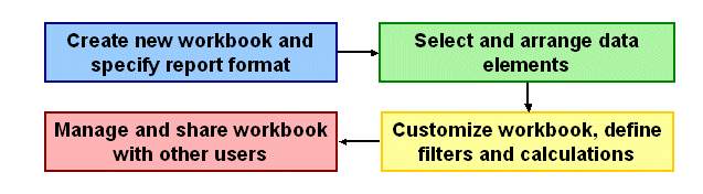

To set up advanced horizontal view, your administrator must complete the following steps:
Create new workbooks and specify report format
Select and arrange data elements
Customize the workbooks and define filters and calculations
Manage and share workbooks with other users
The following image depicts the administrator setup flow for advanced horizontal view.
