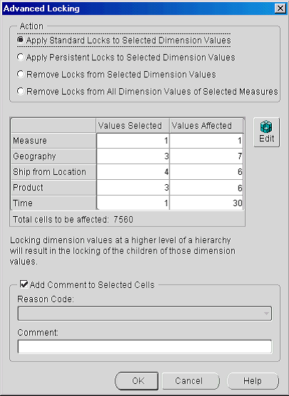

The Advanced Locking dialog box enables you to accomplish cell locking in a more efficient manner by using the Select Data dialog box and its full set of tools. You can do the following:
Set standard locks.
Set persistent locks.
Assign comments and reason codes to selected values.

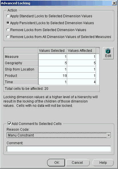

You can apply persistent locks with the Advanced Locking feature.

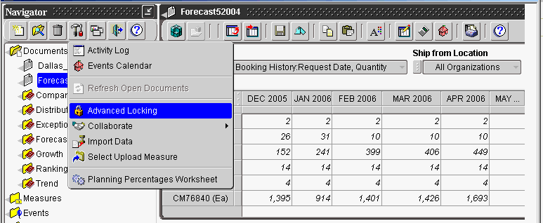

From the Navigation toolbar, click the Tools icon.
From the Tools menu, select Advanced Locking.
Demand Planning displays the Advanced Locking dialog box.
In the Action frame choose Apply Persistent Locks to Selected Dimension Values.
In the Dimension Value Selections frame, choose the dimension values you intend to lock.
You can double-click in the Values Selected column for any dimension to access the Select Data dialog box, or you can choose Edit at the right of the frame.
Note: When you use the Select Data dialog box from the Advanced Locking dialog box, you will NOT (as a planner) see values that are above your assignment level. You see values at the planning value and below.
Once you are in the Select Data dialog box, you must select one or more values from every dimension that you can access in the Select values for box.
Because each dimension in the plan is dimensioned by all the other dimensions, you must create a "data cube" or "tuple" before you can lock specific values. Until you do this, the OK button in the Select Data dialog box is not enabled.
The Measure dimension will only include lockable stored measures, not their quantity and amount submeasures. You also cannot use advanced locking on formula measures, accuracy measures, or on planning percentages and dependent demand.
Choose OK in the Select Data dialog box. When you return to the Advanced Locking dialog box, the selections table is updated immediately -- your selections and the effects of those selections are visible.
If the values selected with explicit locks, plus the values that they affect, total more then 30,000 values, Demand Planning will display a warning. Although it will use significant system resources, the application will continue with the operation if that is your choice.
You should be aware that, because each measure being processed may have different allocation floors, the calculation of the number of dimension value combinations that is affected may be influenced in such a way that the total is less than the product of all Values Affected totals.
Decide whether you want to enter a comment to be applied to all of the selected locked values, describing the reason for the locking them.
If you want to add a comment, check the Add Comments to Selected Cells box.
If your System Administrator has created reason codes for comments, they will be available from the Reason Code list box. If reason codes are not available, you can still enter a comment in the Comment text box.
Choose OK to complete the locking operation.

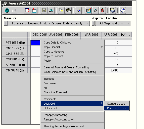

You can apply persistent locks manually.
Open a new or saved worksheet.
Select the cells that you intend to lock. They are highlighted.
Right-click to access the worksheet commands popup menu.
Select Lock Cells.
From the Locking submenu, select Persistent Locks.
Demand Planning applies locking to the selected cell or cells, as reflected by the change in background color.

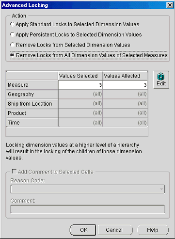

This procedure explains how to remove persistent locks with Advanced Locking.
Open a worksheet containing locked cells. Cells that have cycle-persistent locks will be dark pink in color.
From the Navigation toolbar, choose the Tools icon.
In the Action frame, choose Remove Locks from Selected Dimension Values.
You will see that all of the non-measure dimensions are disabled in the Dimension Value Selections frame.
The contents in the grayed-out Values Selected and Values Affected columns (for non-measure dimensions) are set to (all).
Choose Edit.
Demand Planning displays the Dimension Value Selector for the Measure dimension. A list of the measures in which locks can be removed is displayed.
You can select the measure from which you want to remove locks.
Choose OK in the Dimension Value Selector.
Demand Planning removes the locks from the selected cell or cells, as reflected by the change in background color.
Choose OK in the Advanced Locking dialog box.
Select the cells that you intend to unlock. They are highlighted.
Select Unlock Cells.

This procedure describes how to remove all locks in a measure using the Advanced Locking dialog box. It applies to both persistent and standard locks.
Open a worksheet containing locked cells. Cells that have cycle-persistent locks will be dark pink in color. Cells with standard locks have a light pink background color. Cells in which the numbers are in bold font have a comment attached.
Demand Planning displays theAdvanced Locking dialog box.
In the Action frame, choose the Remove Locks from All Dimension Values of Selected Measures button.
The counts in the grayed-out Values Selected and Values Affected columns are set to (all).
The Add Comment to Selected Cells checkbox is disabled.
Choose Edit.
Demand Planning displays the Dimension Value Selector dialog box for the Measure dimension. A list of the measures in which locks have now been removed is displayed.

The procedures for applying standard locks in worksheets do not differ significantly from the procedures for applying persistent locks. Refer to the following procedures for these tasks:
Procedure: Applying Persistent Locks with the Modify Selected Data Tool
Procedure: Removing Persistent Locks with the Modify Selected Data Tool
The most important difference between applying standard and persistent locks is that standard locks can be applied to any of the values displayed in a worksheet, as long as the measure is editable. However, when you use advanced locking, persistent locks can only be applied at the planner's assignment level or below. This is enforced in the Select Data dialog box, when you access it from the Advanced Locking dialog box. You will not be able to see values that are above the assignment level.
When you access the Select Data dialog box from the Advanced Locking dialog box to apply standard locks, you will be able to see all values for each particular dimension.

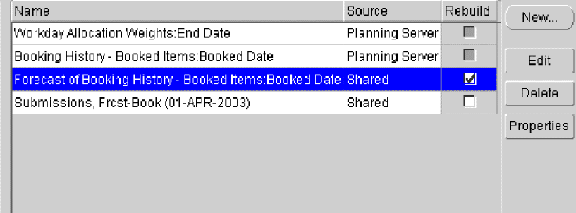

By using persistent locks to save forecast adjustments, the Demand Planning System Administrator can reapply the previous cycle's preserved adjustments to the new baseline forecast for a scenario.
When Distribution occurs, the previous cycle's data adjustments, locks, and comments are part of the distributed forecast.
The System Administrator specifies the inclusion of cycle-persistent data in the distribution of measures to assignments by modifying the properties of the measures that are distributed. The modification of measures is accomplished by using the procedure described in "Applying Previous Adjustments to New Planning Cycles."
The System Administrator can specify that, for any existing or newly-defined measure, its data can be overwritten with any cycle-persistent data found in another measure or the default measure of a specified scenario.
