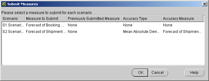

To select a measure to submit for a scenario, you choose the measure from the list of available measures. If the scenario for requires an accuracy measure, you can also choose an accuracy measure.
Access Oracle Demand Planning as a Demand Planner.
On the Navigation toolbar, choose the Tools button.
From the submenu, choose Submit Measures.
Result: The Submit Measures dialog box opens, displaying submission information for each scenario in the demand plan. If a measure has not yet been submitted for a scenario, the Measure to Submit column shows the default submissions measure for the scenario if a default measure has been set; otherwise, it shows "None." If a measure has previously been submitted for the scenario, the Previously Submitted column displays the name of this measure; otherwise it displays "None."
To select an alternate measure (or to select a measure if "None" is the current selection), in the Measure to Submit column, choose the measure that you want to submit.
Note: Do not select a measure that has been limited by a qualifying value such as a single geography. If you do so, then the qualifying value will be used to generate uploaded values for all dimension values at this level.
If an accuracy measure is required for the scenario, you can select a measure from the Accuracy Measure column. It will display all measures that are not dimensioned by Time, including those you have created, either by creating a formula, or by calculating a new one based on other accuracy measures.
To select a measure to submit a measure for another scenario, repeat Steps 4 and 5.
Note: It is not necessary to select measures for all scenarios at the same time. However, if you have previously selected a measure for one scenario and you are satisfied with your choice, choose "None" as the measure to submit for that scenario when you select a measure to submit for another scenario.
Choose OK.
For example, the planner can select measures to submit for two scenarios. The planner can also submit accuracy measures for one of the scenarios.

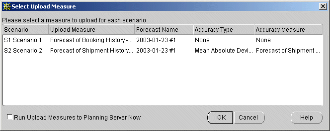

To select a measure to upload for a scenario, you choose the measure from the list of available measures. If the scenario requires an accuracy measure, you can also choose an accuracy measure. You also have the option to run the stage that uploads data from the shared database to the Demand Planning Server.
Access Oracle Demand Planning as a Demand Plan Manager.
From the submenu, choose Select Upload Measure.
Result: The Select Upload Measure dialog box opens. If a measure has not yet been uploaded for a scenario, the Measure to Upload column shows the consolidated submissions measure as the default measure to upload for the scenario. If a measure has previously been uploaded for the scenario, the Previously Submitted column displays the name of this measure.
To select an alternate measure, in the Measure to Upload column choose the measure that you want to upload.
The Forecast Name column displays a default name. You can accept this information, or you can take one of the following actions:
Type a new name in the Forecast Name box, up to 70 characters long.
Click in the column to view a list of forecast names and select a name from the list (overwrite the forecast).
If an accuracy measure is required for the scenario, the Type column displays the type of accuracy statistic specified for the scenario in the Demand Planning Server. The Accuracy Measure column displays the default accuracy measure for the scenario. You can choose an alternate measure.
Repeat Steps 4 through 6 for each scenario for which you want to select a measure to upload.
Note: If there are multiple scenarios in the demand plan, it is not necessary to select measures to upload for all scenarios at the same time. However, if you have previously uploaded a measure for one scenario and you are satisfied with the data, choose "None" as the measure to upload for that scenario when you upload the final forecast for another scenario.
Choose OK.
In the Select Upload Measure dialog box, check the Upload Measures to Planning Server Now box.
Choose OK.
Note: Consult with the Demand Planning System Administrator before you choose this option. Running the upload might duplicate an automated program or an administrative action.
The Demand Plan Manager can select measures to upload for two scenarios. The manager can also upload an accuracy measure for one of the scenarios. He or she may not choose to run the upload immediately, though.

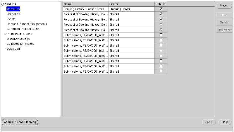

You can collect and consolidate forecasts submitted by demand planners into the same measure in every planning cycle. Reusing the same submissions measure allows you to automate the demand planning process.
Once a demand plan is built, the System Administrator runs the five stages in the planning cycle. During that cycle, after the data is downloaded and measures populated, the Distribute to Planners stage distributes data in the shared database to authorized demand planners. Submissions measures are created during theDistribute to Assignments stage.
During each distribution, a new submission measure is created for each scenario. The number of submission measures can increase dramatically over time, depending upon the number of scenarios and how often they are distributed.
For example, if you create three scenarios and then, for whatever reason, redistribute twice, you have three distributions of three scenarios, producing 9 submission measures.
The proliferation of submission measures does provide a useful purpose by enabling the Demand Planning Manager to keep track of data changes and forecast versions.
The downside of the proliferation of submission measures is that record-keeping problems and resource allocation shortages may eventually result.
Your System Administrator has the option of reusing submission measures. The Administrator may stipulate that the submission measure created during the first Distribute to Assignments stage will be used with every subsequent redistribution.
Your Demand Planning System Administrator has the options described below.
To allow users to create only one set of Submission measures -- one for each scenario. (Measures are reused automatically.)
To allow users to create new sets of Submission measures with each Distribute to Assignments process. (Measures not reused.)
To allow users to switch from reusable to non-reusable Submission measures and vice versa.
The System Administrator sets the appropriate option for the creation of Submission measures by using a checkbox in the Scenarios page.

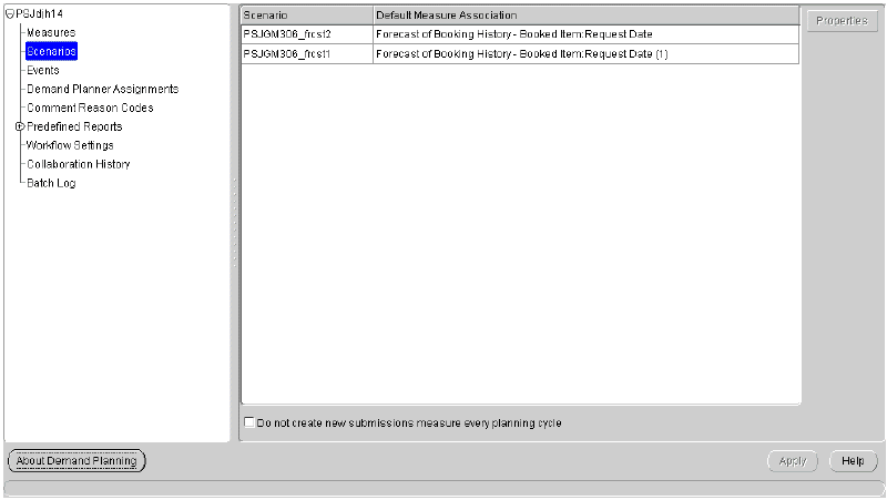

The procedure described below enables the use of a submission measure that is used with every redistribution.
In the System Administrator's interface, select Scenarios from the Navigation List.
Go to the Scenarios page. This page has columns for scenarios and corresponding default measures.
The Do not create new submissions measure every planning cycle box is available and unchecked.
The Apply button is disabled.
Check the box to create a reusable submissions measures.
When the box is checked, the Apply button is enabled.
Choose Apply.
Further consequences of using or not using the Do not create new submissions measure every planning cycle box are discussed below.
If the you leave the checkbox blank, a new set of Submission measures will be created with each Distribute to Assignments process.
If Submission measures have already been created and the System Administrator chooses Do not create new submissions measure every planning cycle, the most-recently created Submission measures are used automatically. The conditions below also apply.
No new Submission measures will be created.
Existing sets of submission measures (previous versions) remain in the system; they are not automatically be deleted.
If Do not create new submissions measure every planning cycle is checked before the first "Distribute to Assignments" process and has never been changed , only one set of Submission measures will exist, with one Submission measure per scenario.
If this checkbox is unchecked after being checked, new sets of Submission measures are added to existing list after each Distribute to Assignments process.
