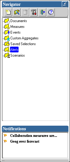

How alerts are displayed
The Alerts folder in the Navigation list displays all alerts that you have defined.
Your Notifications list displays only those alerts that meet all of the following criteria:
Example: Display of alerts and notifications
Consider an example, where the user has defined two alerts, both of which are displayed in the Alerts folder in the Navigation list. One of the alerts is also displayed in the Notifications list, indicating that the alert has run and the exception condition has been met. The Notifications list also displays a message that there are collaboration measures ready to be received.

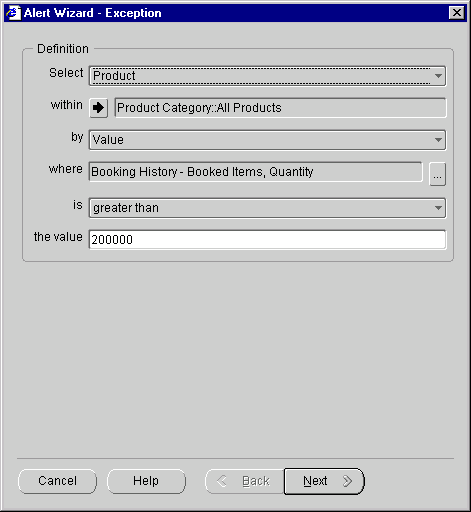

  4. In the Alert Wizard - Exception page, define exception criteria as follows:
    1. In the Select box, choose the dimension to which the exception condition applies.
    2. In the within box, click the arrow to display the hierarchies for the dimension. Select a hierarchy and then select a level within the hierarchy.
    3. In the condition box, select Value.
    4. In the measure box, select the measure on which to base the exception condition.
      You can accept the default measure or choose the Ellipsis button to access the Dimension Value Selector dialog box, where you can select an alternate measure.
    5. In the operator box, select the operator that identifies how data values will compare to a specified value. You can select one of the following terms:
      • less than
      • less than or equal to
      • equal to
      • not equal to
      • greater than or equal to
      • greater than
      • between
      • outside
    6. Complete the value box (or boxes) as follows:
      • If the operator is other than between or outside, enter a number that is to be compared to the values of the selected measure.
      • If the operator is between or outside, enter the top and bottom of the value range that is to be compared to the values of the selected measure.
  5. Choose Next to continue.

Example: Alert definition based on value exception
Consider an example, where the user defines a value exception that will be met when the Booking History - Booked Items, Quantity for the specified products is greater than 200,000.

Deleting Alerts
When you no longer need to maintain an alert you can delete it.
To delete an alert:
  1. Access Oracle Demand Planning as a Demand Planner or Demand Plan Manager.
  2. In the Navigation list, identify the alert that you want to delete.
    Note: To search for an alert, click the right mouse button on the Alerts folder in the Navigation list and choose Find Alerts from the popup menu. Then enter a name or name fragment. Alternatively, you can choose the Find button on the Navigation toolbar.
  3. Select the alert object and choose the Delete button on the Navigation toolbar.
    the picture is described in the document text
  4. Alternatively, you can click the right mouse button on the alert object and choose Delete from the popup menu.
    Result: You will be prompted to confirm the deletion.
