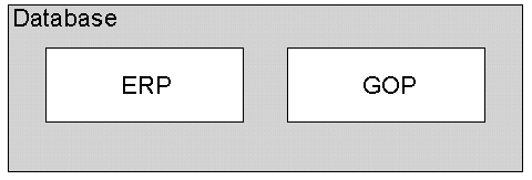

When Oracle Global Order Promising resides on the same instance as the other ERP applications, you must perform the following system setup steps:
One Instance Setup
Context: Perform this step only once.
Required: Yes
Install the Oracle Global Order Promising (or ATP) source and destination patches on the same instance. Also, apply the Data Collection patches. The patch numbers can be release-specific. You can find the patches on My Oracle Support.

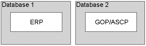

When Oracle Global Order Promising resides on two instances as the other ERP applications, you must perform the following system setup steps:
Install Patches:
Required: Yes
Step 1 Install Patches
Install the Oracle Global Order Promising source patches on the source instance and the Oracle Global Order Promising destination patches on the destination instance. Also, apply the Data Collection patches. The patch numbers can be release specific. You can find the patches on My Oracle Support.
Note: Before beginning the installation of the source patch, count all, if any, invalid database objects. If after the patch is installed, the number of invalid objects has increased, then there a problem occurred with the patch application.

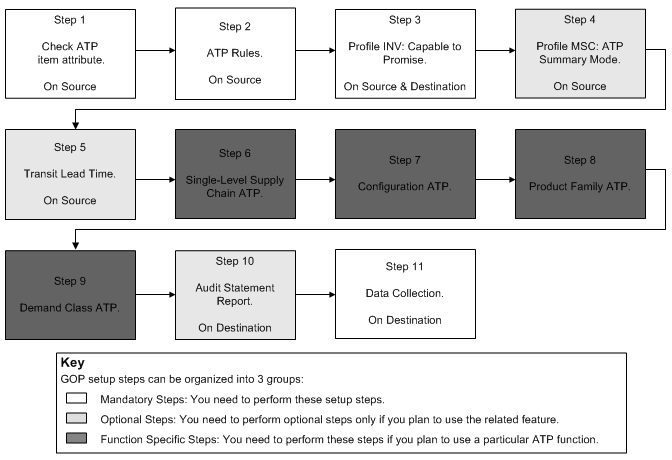

The following section explains the functional setup steps for ATP Based on Collected Data.
The diagram below provides a pictorial view of the ATP Based on Collected Data setup steps.
Check ATP item attribute:
Context: Perform this step for every item.
Required: Yes
Oracle Global Order Promising (GOP) uses this flag to determine whether to use the supply of this item to promise demand. Set the Check ATP Flag item attribute to either:
Material only: Check material availability for this item at this level.
None: No need to check ATP at this level.
The Material and Resource option and the Resource only option are not currently supported.
For details on defining item attributes, see Defining Item Attributes in Oracle Inventory User's Guide.

This section explains the functional setup steps for using Oracle Global Order Promising with Oracle Advanced Supply Chain Planning. This functionality is also referred to as ATP (Available-To-Promise) Based on Planning Output.
Check ATP and Component ATP item attributes
Required: Yes
You can set the Check ATP item attribute to:
Material only: Check material availability for this item at this level. For a standard item for which you want to check availability, select this value.
Resource only: Not currently supported.
Material and Resource: Not currently supported.
You can set the Component ATP item attribute to:
Material only: Check availability of the components in the bill for this item. If the item is sourced from a supplier, check for supplier capacity.
Resource only: Check availability of the resources required to assemble this item.
Material and Resource: Check availability of both the material and the resources required to assemble this item.
None: No need to check ATP for the components of this item.
Oracle Global Order Promising does not use the Check ATP field on the bill of material. To check or not check the ATP of components, use the appropriate item attribute setting of Component ATP that matches your business need.
You might not want to check ATP because:
A performance cost results when checking ATP at all levels of a bill of material when you are entering sales orders for manufactured and configured items.
The timing of component item use is not always essential, which it is for an item being sold.
Checking ATP through a bill of material assumes that the manufacturing and supply processes use the same methodology for sourcing, but they do not.
See Multi-Level Supply Chain ATP for an example of the item attribute setting.
ATP Rule
Context: Every item that is available-to-promise must have an ATP Rule assigned. An ATP Rule can be used for multiple items.
Required: Optional
When Oracle Global Order Promising is based on Oracle Advanced Supply Chain Planning output, you only need to define the infinite supply time fence option in an ATP Rule.
If you do not associate an ATP Rule to an available-to-promise item, then Oracle Global Order Promising assumes that the infinite time fence is equal to the planning horizon.
You must set up the ATP Rule for an available-to-promise resource either at the resource level or the organization level.
Navigate to Inventory Setup and find Available-To-Promise Rules.
ATP Rules Window

Profile INV: Capable to Promise
Context: Perform this step on the source and destination instances.
Required: Yes
Set this profile to ATP/CTP Based on Planning Data on both the source and destination instances.
Profile MSC: Enable ATP Summary Mode
Context: Perform this step only once on the destination instance.
Required: Optional
Oracle Global Order Promising response times improve with a summary approach that stores summary supply and demand information. Set this profile to Yes to use the summary approach.
For a detailed explanation of ATP Summary approach, see Improved ATP Performance Based on Summarized Data.

Transit Times Window
Given a shipping method on an ATP request, Oracle Global Order Promising will search for the shipping method in the three levels listed previously from most specific to least specific. If it finds the shipping method in a particular level, it will use the lead time associated with the shipping method to calculate the scheduled arrival date for an order. If the specified shipping method is not specified at any level, Oracle Global Order Promising will use the default shipping method and its lead time in any level you define, from most specific to least specific.
For example, you define shipping lane from your shipping organization to a specific customer location with shipping method of GROUND that has a lead time of 3 days. You also define a shipping lane from your shipping organization to a region where the previous customer resides. This lane has GROUND as a valid shipping method, and a lead time of 2 days. On a sales order to this customer using GROUND shipping method, Oracle Global Order Promising uses 3 days for the transit lead time.
Before you set up transit times between the locations, you need to have set up shipping methods and a default shipping location as the shipping organization. Optionally, you can set up an internal location and its association with the customers ship-to address, regions and zones.
For detailed instructions, see Transit Times in Oracle Shipping Execution User's Guide.
