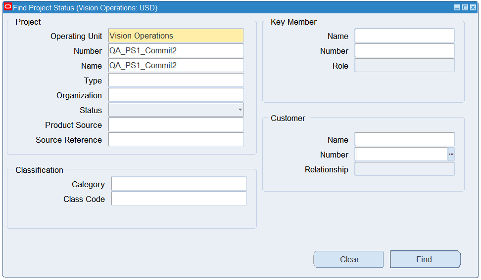

Navigate to the Find Project Status window.
Find Project Status
Select your project Number.
Click Find.

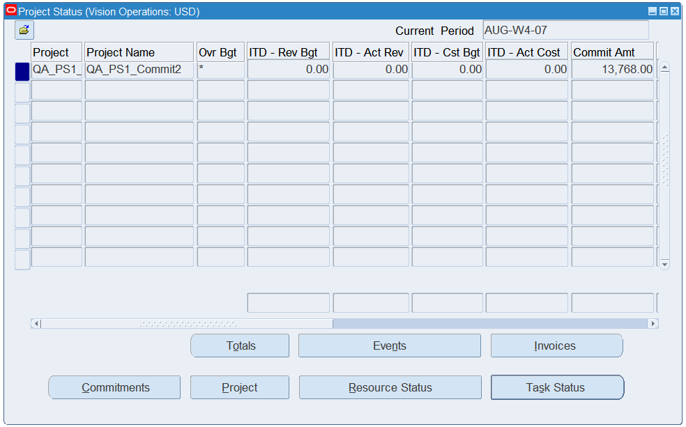

This window displays the commitments by a specific project number. The Commit Amt (commitment amount) field has increased in value in comparison to before you entered the requisition.
Optionally, choose Totals to add up commitment totals for multiple projects.
Choose Commitments, and then choose Find to view commitment details for the current project. All requisitions and purchase orders associated with the current project appear.
The Commitment Number is the requisition or purchase order number. After a purchase order has been created from a requisition, the Commitment Number field value changes from the requisition number to the purchase order number.
The Project Raw Cost is the cost of the individual requisition or purchase order. The Project Raw Costs are added together to obtain the total commitment amount for the project.
Close this window, and then choose Task Status to display commitment information at the task level. All tasks associated with the current project appear.
Select a Task, then choose Commitments.
Choose Find to view the commitment details for the specific task.
