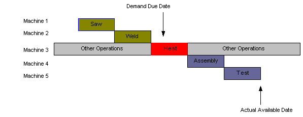

Production Scheduling can govern the scheduling of operations that exist upstream from a bottleneck operation in a routing. For example, consider a routing with five operations: saw, weld, heat, assembly, and test and pack. The bottleneck resource is the oven, which is required for the heating operation. The routing and operations are displayed in the following diagram:
the picture is described in the document text
When Production Scheduling creates operations to satisfy demand, it posts earliest date and available date constraints that are associated with the operations. The operations are scheduled in a just in time (JIT) manner, according to their available date. This scheduling behavior is governed by any precedence constraints in the routing and can occur only if precedence constraints permit JIT to available date.
In this example, the saw and weld operations could have been made earlier in the process, however, these operations are scheduled to align with the bottleneck operation, heat. This is the default behavior in Production Scheduling.
Due to the bottleneck created by the oven, the demand is scheduled late. A solve yields the schedule displayed in the following diagram:
Using the solver option, JIT to Due Date, you can pull the saw and weld operations forward and generate a schedule resembling the one in this diagram:
Upstream operation pulled forward
With the saw and weld operations pulled forward, the upstream operations are placed at a point that provides you with a more efficient way to manually schedule the remaining operations in the routing to a time earlier in the process. This helps to make the demand on time and is effective if you want to schedule operations close to the demand due date rather than close to the bottleneck operation on the routing.
Note: This tactic may result in a longer makespan for a routing if this solver option is set to Due Date. For example, in the example, if the solver places upstream operations earlier in the scheduling horizon and if the solver cannot move the bottleneck operation without manual intervention, the makespan is longer for this demand.

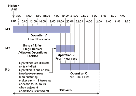

Scenario 3: A Schedule That Has Both the Units of Effort and the Adjacent Operations Preferred Flags Enabled on the Routing
For this scenario, assume the following:
Note: You cannot enable adjacent operations unless the Units of Effort option is enabled.
The number of hours that each machine can run per operation is:
Machine Number Runs per Operation
Machine 1 4-3 hour operations
Machine 2 4-1 hour operations
Machine 3 4-2 hour operations
The following diagram demonstrates the routing schedule with both the Schedule Work Order operation according to their Units of Effort and Schedule Adjacent Operations options enabled:
By enabling both work order units of work and adjacent operations flags, you have sacrificed some makespan to keep operations on Machine 2 together. Without adjacent operations enabled, total manufacturing time was 15 hours. With adjacent operations on, total manufacturing time is 18 hours, but you have removed idle time on Machine 2.

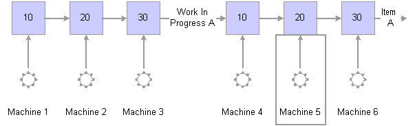

The flow of resources is shown below:
General flow of a product through a factory
The manufacturing processes are set up to resemble the routing shown in the preceding diagram. Demands have been entered for the various products.

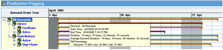

By running a solve with all constraints enabled, the demand fulfillment is really poor on a first pass schedule, as illustrated in the following screen shot.
Demand fulfillment after a solve

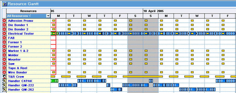

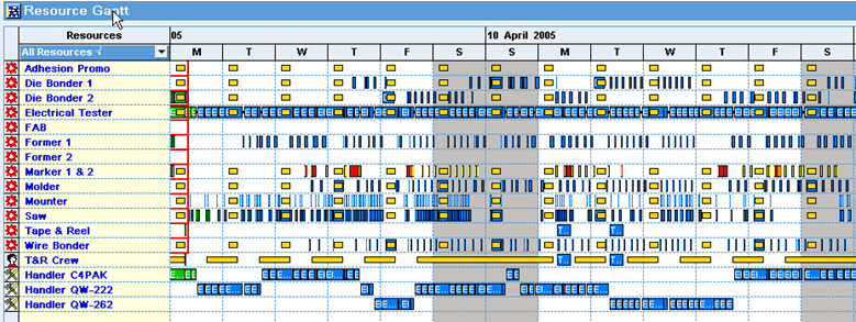

Looking at the Resource Gantt the electrical testing machine is the dominating bottleneck resource in the factory:
Resource Gantt
By using this feature, you can create a schedule by first solving the bottleneck resource, and then incrementally enabling upstream constraints, followed by downstream constraints.

After re-solving with solve stages, the solve will stop at each break. From here, the schedule can be reviewed and changed by manually scheduling.
Resource Gantt review after solve break

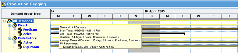

After resuming the solve, the demand fulfillment, shown below, has increased significantly on the first pass schedule as illustrated in the following screen shot:
However, the Electrical Test machine is still the bottleneck as shown in the following Resource Gantt:

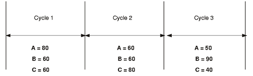

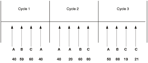

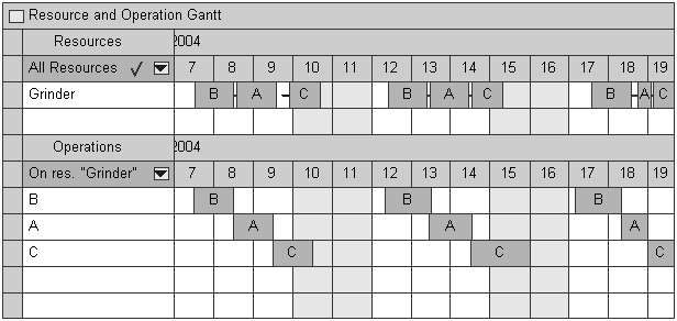

The CRO first determines how much of each item is needed in a given bucket, for example supply and demand netting. This diagram illustrates the ideal run length, which is calculated by aggregating demands in the user specified cycle:
For example, if there are demands for 125 units for an item in cycle 1, and there is a minimum run length of 100 items, this step creates a series of operations for the same item to be 125 or more, depending on the operation lot multiple. If there is demand for only 25 units in cycle 1, the run length is calculated as 100 units.
Next, the ideal sequence within each cycle is calculated. The purpose of this step is to minimize changeovers within the user-defined manufacturing cycle times. This is based on changeover cost or time, which is user-specified.
Because the CRO algorithm works in buckets, the solver buckets demand for the CRO, based on the bucket boundaries. In this example the bucket boundaries are weeks. CRO then calculates a plan, based on the weekly bucketed demand, and Production Scheduling then sequences the runs according to the recommendations of the CRO.
Scenario solve results using CRO

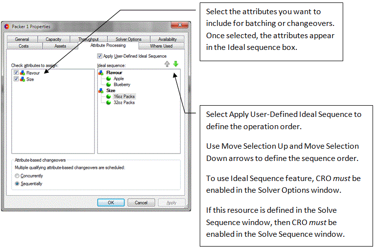

User Defined Ideal Run Sequence
In many environments, you may simply wish to dictate the order of changeovers to run. You can specify the sequence operations should be scheduled in CRO according to attribute (available for CRO resources only). This is an alternate sequencing strategy compared to the current CRO sequencing strategies of Cost or Time.
To define ideal run sequence for the solve stages:
  1. From the Model Workspace, right-click the scenario, and select Solve Sequence.
  2. Select solve stage.
  3. Select User Defined from the Calculate Ideal Run Sequence based on list.
    At least one resource within the solve stage needs to be defined to Use Campaign Run Optimization (set from the Solver Options tab in the resource Properties window) for the Calculate Ideal Run Sequence based on list to be enabled.
The mechanism in which the "ideal" sequence is defined is by selecting and sorting the associated attributes and their attribute values on CRO resources in the model.
For example, take attributes "Size" and "Grade". Within "Size" there are 1/4 Inch, 1/3 Inch and 1/4 Inch as attribute values. Within the "Grade" attribute, there are Grades A and B.
Assume the user defined Ideal Sequence is to cycle by size and grade within the size, as outlined in the following example:
1/4 Inch-Grade A -> 1/4 Inch Grade B -> 1/3 Inch-Grade A -> 1/3 Inch Grade B -> 1/2 Inch-Grade A ->1/2 Inch Grade B
Assign attributes to a resource using the Attribute Processing tab in the resource Properties window, as shown in the example below.
Essentially, the order in which the selected attributes and attribute values appear in the Ideal sequence column dictates the ideal sequence of operations (the operations must be associated to these attributes). For example, if Grade was more important than Size, you could move Grade above the Size attribute using the Move Up or Move Down button, located above the Ideal sequence column. The sequence would then cycle by Grade and then Size within the Grade.

When building models, you should consider certain topics:
Only single-capacity duration machines can be optimized, and no more than one machine per routing can be optimized for repetitive manufacturing. If the machine is part of a resource set, then all machines within the set must be optimized for repetitive manufacturing.
Because the CRO algorithm is based on buckets, it is possible that the algorithm may not recognize demand if a given demand is late within a given bucket. For example, if demand is due at noon within a bucket, the CRO is solving on the basis of daily buckets, and the sequence of operations determines yields on available time of 4:00 p.m., the CRO phase of the solve does not see this demand as late.
Because the sequencing phase of the solver cannot change the operation sequence determined by the CRO, the demand may appear late within a given cycle. If inventory levels are below zero on a cycle boundary, then the CRO sees an item stockout. However, there is logic in the solver that internally sets the due date of the late demand to a previous bucket if there is sufficient idle time on the campaign run optimized machine. The CRO is then internally run again.
Within the manufacturing flow of an item, from raw materials to finished product, you can specify either one resource or resources in a resource set that can be campaign run optimized. This diagram below illustrates run optimization on a single resource, which is Machine 5.
The resource or resources in a resource set that you designate as campaign run optimized may be used in several different operations, if the operations are not producing the same final item. This diagram below illustrates this concept for Machine 5.
Note: Only single capacity and batchable machines can be designated as campaign run optimized.
A campaign run optimized resource cannot be set to relaxed.
Some scenarios, which are explained in the following paragraphs, are not conducive to run optimization:
  1. You cannot specify a resource as campaign run optimized if the machine is used in a material flow that feeds into another material flow, which has a campaign run optimized machine.
  2. A resource can be used only once in the entire material flow.
    Multiple runs on the same resource in the same material flow presents conflicting objectives.
The following diagrams illustrate these restrictions on run optimization. The diagram below illustrates a scenario in which Machine 3 is campaign run optimized, but feeds into a material flow in which Machine 5 is also campaign run optimized.
The diagram below illustrates one resource being campaign run optimized more than once in the same material flow.
