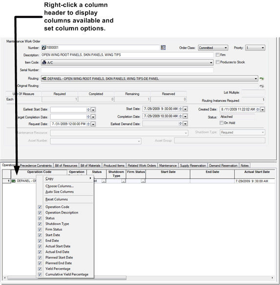

Many views display information in a tabular manner. This data can be customized as needed. Use the Choose Columns dialog to customize and arrange the data displayed in the table grid.
To customize table data in a view
Right-click a column header within the view.
The menu displays all columns that can be displayed in the table. Check marks appear next to columns displayed within the table. You can update individual columns by checking the column name displayed at the bottom of the menu. To hide a column, uncheck the column name in the menu.
To define all the displayed columns and column order, select Choose Columns.
Perform the following as needed:
Select the columns you want to appear. Uncheck the columns you want to hide.
To display all available columns, click Show All.
To reset the columns displayed to the default setting, select Reset.
To modify the column order, select column and use the Move Up or Move Down arrow to move column to new location.
Click OK.
To resize the column widths in the table, right-click a column header within the view and select Auto Size Columns.
To reset the column in the table to the default settings, right-click a column header within the view and select Reset Columns.

To open the Work Order Editor from the Production Pegging - Work Order Centric view:
Select a work order in the work order tree.
Click the Open Work Order Editor icon in the toolbar, or right-click and select Open Work Order Editor.
The Work Order Editor opens and highlights the selected work order number in the Work Order tree.

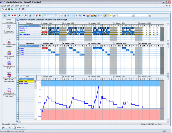

The Resource Gantt is a resource-centric view of the schedule. It enables the planner to see exactly how machines, crews, and tools are scheduled across the horizon. Operations are displayed with blue rectangles to indicate exactly where they start and end. You can zoom into any point in the horizon by selecting a range in the upper portion of the horizon bar and then select the Zoom In button on the toolbar.
For multicapacity resources, color is used to represent the percentage of capacity currently being used. The Set Colors button defines these colors. For example, if you have not changed the default color setting, dark green represents low (0 to 10 percent) capacity used, while red represents high capacity (90 to 100 percent).
The example below illustrates the Resource Gantt chart elements that are described in the following table:

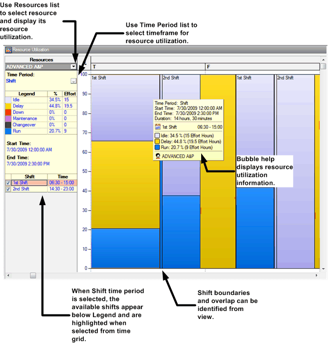

The Resource Utilization view provides you with precise information about all of the defined resources that are used in the schedule horizon. Information such as idle time, delay time, calendar down time, maintenance time, changeover time, and run time appears in this view. Resource utilization appears as total number of hours utilized and as a percentage. Use the Resource list to display each resource and its utilization. Use the Time Period list to display resource utilization based on the selected time period (day, week, month or shift). If you select a column in the utilization view, summary information for that time period appears on the left side of the view for the specific time bucket.
The following table describes each item displayed in the Legend:
| Legend Entry | Description |
| Idle | The percentage of time and total hours when the resource is available but not utilized. |
| Delay | The percentage of time and total hours when the resource is not used because of a delay. |
| Down | The percentage of time and total hours when the resource is not used because of down time. |
| Changeover | The percentage of time and total hours that the resource is not used because of a changeover. |
| Maintenance | The percentage of time and total hours that the resource is not used because of a maintenance activity. |
| Run | The percentage of time and total hours when the resource is being run. |
| Start Time | The date and time of the start of the utilization time period. |
| End Time | The date and time of the end of the utilization time period. |
Note: If your schedule contains maintenance, changeovers, delays, or down time, utilization statistics appear in the Legend and the corresponding color-coding appears in the columns. If your schedule does not contain maintenance, changeovers, delays, or down time, these events appear as zero percent in the Legend.
When Shift is selected from the Time Period list, the available shifts and shift times appear below the Legend. To display resource utilization for a shift, select a shift from the time grid. Multiple shifts can be selected.
To display resource utilization for shift overlap, select the overlap from the time grid. The overlapping shifts are highlighted below the Legend. The Start Time and End Time display when the overlap occurs.
To view detail information for a time period, place your mouse over the period in the time grid. Bubble help displays the resource utilization information.
Refer to Viewing Resource Utilization.

The Multi-Capacity Resource Graph displays a resource's total available production capacity and how much of that capacity is used over time. You can select any resource and then view levels for that resource by moving your pointer to any point on the graph.
The area in red, at the top of the graph, represents the maximum capacity of the resource. The red shaded area, at the bottom of the graph, represents zero utilization point. You can customize the colors in the view using the icon on the toolbar.
To get more detailed information about a generated schedule than from a single schedule view, you can select a combination view. With a combination view, two or more views are synchronized so that when an item is selected in the main view, the other view displays the related information only about that item. For instance, while reviewing the Resource Gantt, you can select a resource and simultaneously view its utilization, item usage, or operation details during a specific time frame. This powerful feature enables you to quickly analyze key elements of your schedule and determine whether any adjustments need to be made. The following combination views are available:
| Combination View Name | Description |
| Resource and Operation Gantt | Displays operations that run on selected resources in the Resource Gantt. |
| Resource Gantt and Utilization | Displays the utilization of selected resources in the Resource Gantt. |
| Item Gantt and Graph | Displays the inventory levels of selected items in the Item Gantt. |
| Resource Gantt and Item Graph | Displays the inventory level of an item that is produced or consumed by a single operation. |
| Resource Gantt and Multi-Capacity Resource Graph | Displays the utilization of selected multi-capacity resources. |
| Resource Gantt, Operation Gantt and Item Graph | Displays operations that run on selected resources in the Resource Gantt, and you can see the inventory level of an item that is produced or consumed by a single operation by selecting an operation in the Resource or Operation Gantt. From this view, you can click an item in the Item Graph and the producing and consuming operations are highlighted in the Resource and Operation Gantt. |
Additional combination views can be created and added to the combined group, if necessary. Each view can have the name and button of your choice. To organize your views, you can also set up group views that contain specific schedule views.
While in this view, you can use the scroll bars and zoom options to move to different areas in your view. As long as the synchronized scroll bars feature is active, both views stay synchronized as you move around in the view.

Select Resource Utilization from the Views list bar.
Click Zoom In, Zoom Out, or Zoom to 100 percent from the toolbar to display the view at the required level of detail.
Select a resource from the Resources list.
The vertical bars in the view represent the utilization level for that resource.
Select one of the following time periods from the Time Period available options: Daily, Weekly, Monthly, andShift.
From the view time grid, click a time period to display utilization statistics for that time period.
To display resource utilization for a time period, place your mouse over the period in the time grid. Bubble helps displays information about the time period.

Select the Combined button from the View list bar. The following image provides an example of the Resource Gantt, Operation Gantt, and Item Graph combined view.
Combined view
To view combined views:
Select the Combined button from the View list bar. If you created a new group view, select the group name button.
Click a view button.
Click an element in the main view to display additional details.
In a Resource Gantt, you can click any resource. The detail view might display how this resource is being used or the operations to which it is associated, depending on your choice of detail view.
In the Resource or Operation Gantt views, you can right-click any operation and display either the produced or consumed items, or all of the items that are produced and consumed by the operation.
In the Item Gantt, you can click any item. The detail view (the Item Graph) displays further information about that item's stock levels.

From the Exception grid, you can hide data columns as needed and rearrange the column order. Customizing the grids can make it easier to analyze your exception messages and identify potential problems.
To hiding exception data:
Access the Exceptions grid.
Right-click a column header.
The columns displayed within the exception tabs appear checked within the menu.
To hide columns, perform one of the following:
Deselect the column name.
Select Choose Columns. Deselect the columns you want to hide, or click Hide. To reorder to columns displayed, select a column name and use the Move Up and Move Down buttons to arrange the column order. Click OK.

Use the Choose Columns window to customize the data in the Comparison Criteria region.
Right-click column header from Comparison Criteria region and select Choose Columns.
To display a column, select the column name check box, or select the column name and click Show.
To hide a column, deselect the column name, or select the column name and click Hide.
To change the order columns appear, select column name and click the Move Up or Move Down buttons to arrange the display order.
To display all columns, click Show All.
To reset window to default setting, click Reset.
To save your settings, click OK.
